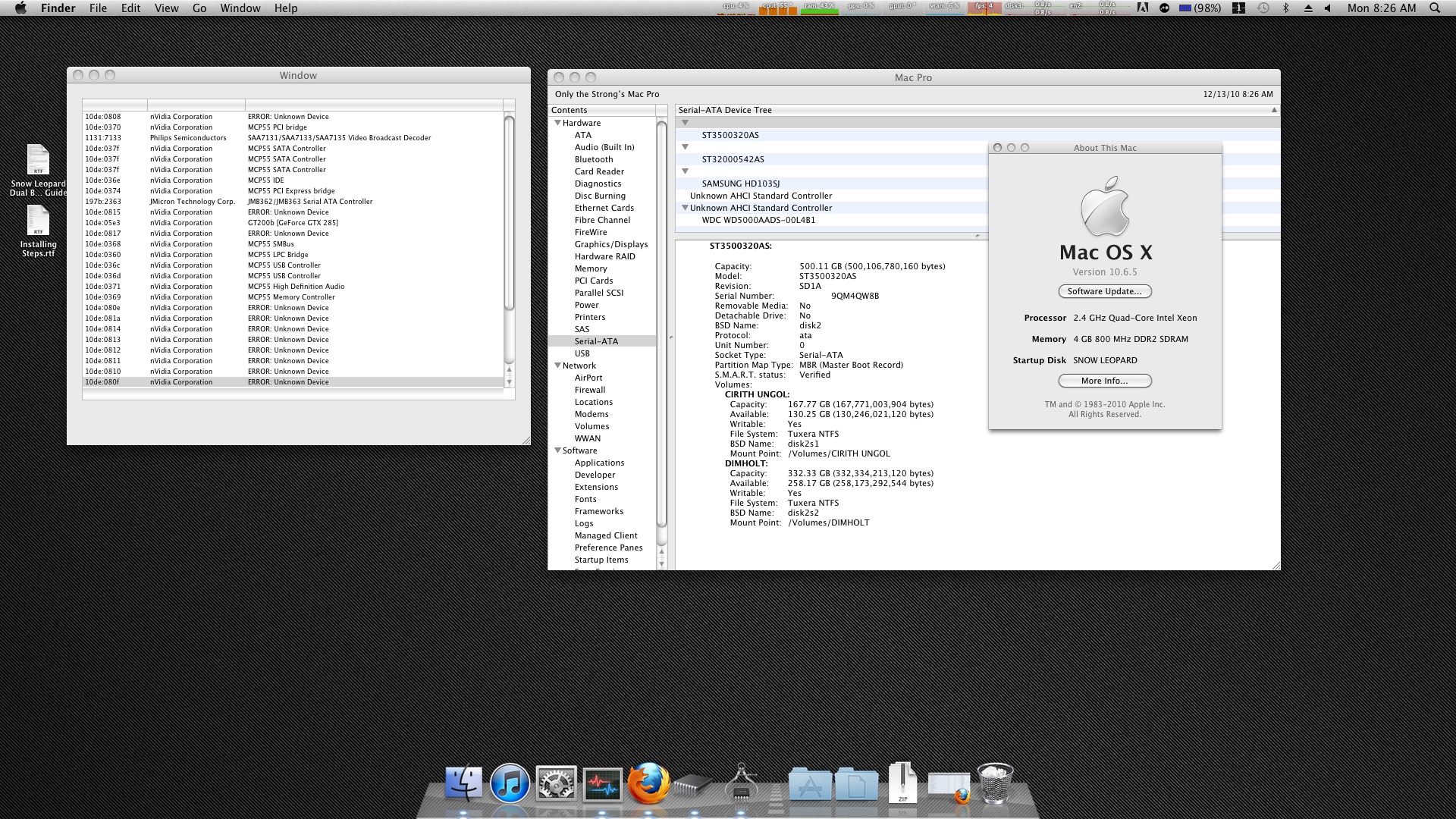

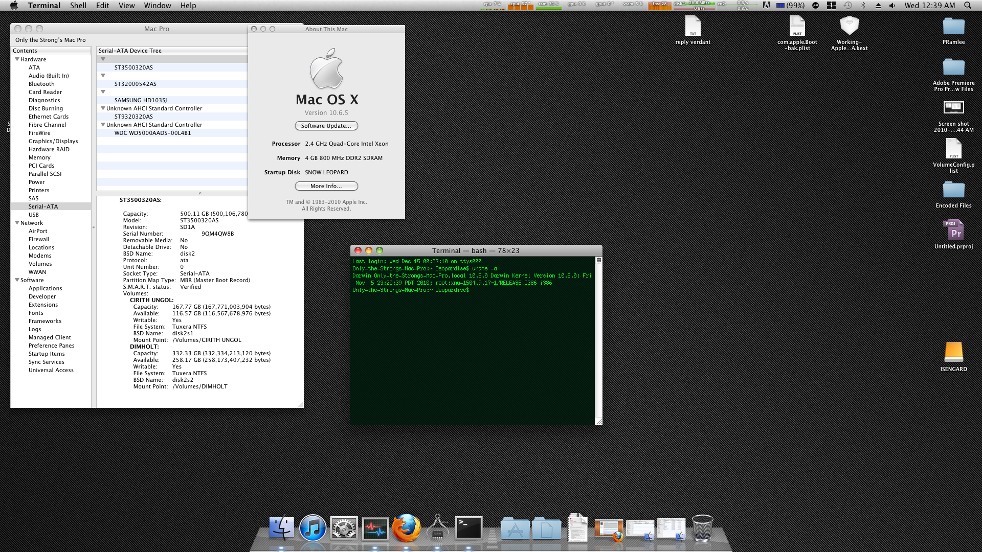

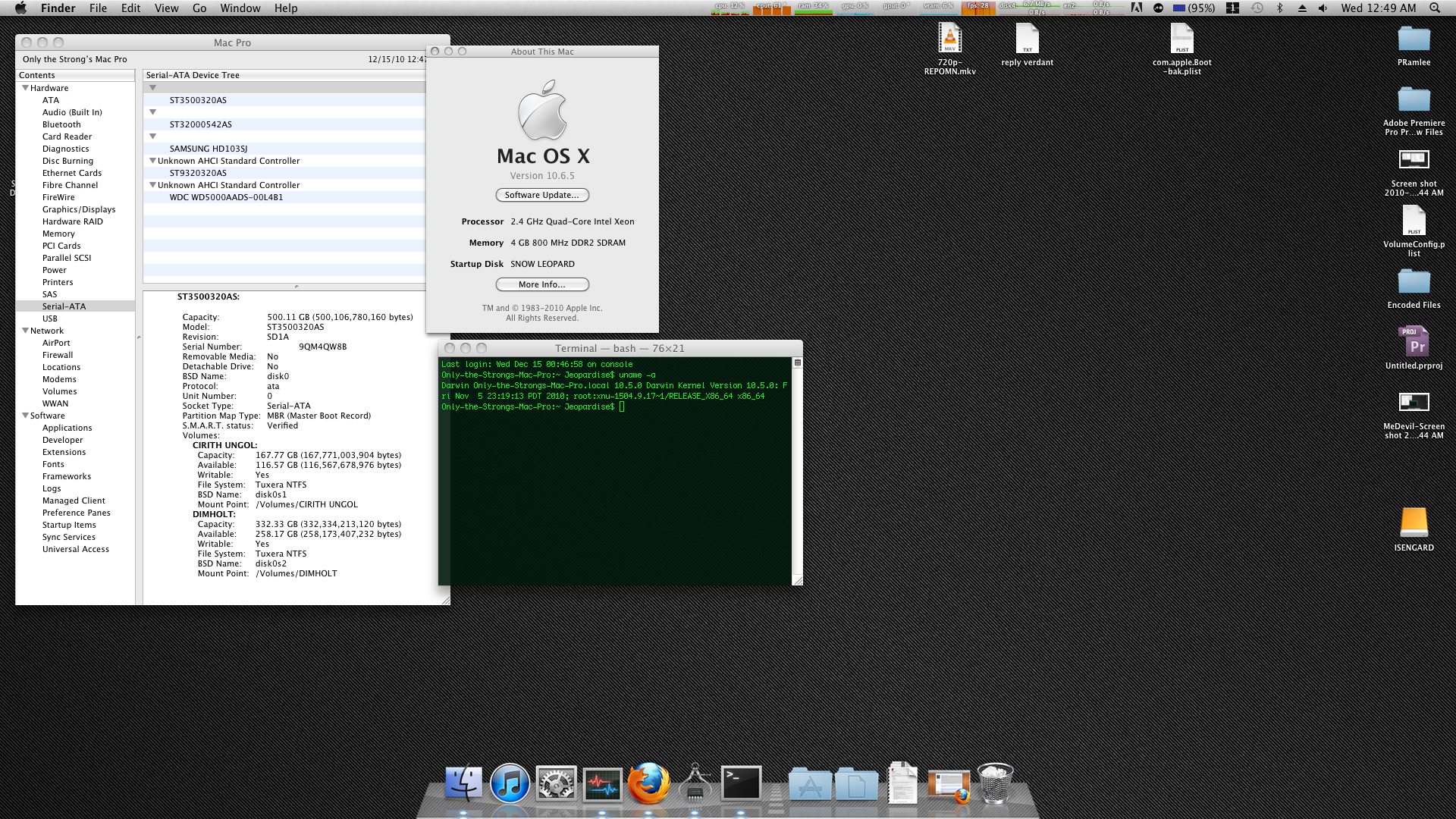

Hello, thanks for your prompt reply.
I've tested almost all Nforce kexts just to find out which one is best for my PC *ehem* iHack for testing and points out any details for other people's reference.
So I have tried
1. SuperNForceATA (from other site) : long boot and most of the time failed to access or detect nForce NTFS harddisks. Shutdown sometimes fails. Slow HDD/USB transfer
2. slashack's AppleNForceATA.kext : long boot and most of the time failed to access or detect nForce NTFS harddisks. Shutdown sometimes fails. Slow HDD/USB transfer
3. MeDevil / aryajuanda AppleNforceATA (PART K # 4) : Showed correct detection of MCP55 during bootup. Detection of Nforce harddisk with NTFS seems very responsive. Faster boot up than 1 and 2 ;)
4. imk's 64bit version of AnV's AppleNForceATA.kext : Showed correct detection of MCP55 during bootup. Detection of Nforce harddisk with NTFS seems very responsive. File transfer also fast. Boot up took a bit longer than 3 but it's 64-bit! :D:D:D . However after a while, nforce harddisks seems to disappear again from Finder.
I've tried to follow your guide as close as possible and I am very satisfied with the result that i've obtained now. Perhaps I'll choose to use using 3 or 4, which more stable. My DVD-drive should have no problem reading discs as I m using TEAC IDE drive.
Attached are screencaps for MeDevil's and imk's results. In System profiler, the Serial-ATA device name still blank, however.
Nothing worries me more than cooling my northbridge now. nforce 790i northbridge is really HOT 70 C idle! :( . Perhaps that's the answer for SATA appears and disappears. Gonna cool it down with HR-05 IFX soon.
So I have tried

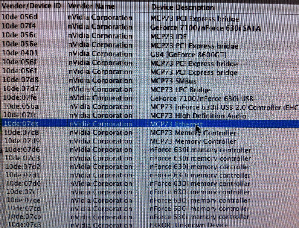

Hey, Great Guide!
Helped a lot.
I installed SL on my external using other computer, it was a suprise to see it work.
Followed your guide after that.
Now I have two issues that I can't seem to figure out.
1. Ethernet is detected, but doesn't work right. Used NforceLAN and I usually get a kernel panic. ( I have Realtek RTL8201CP )
2. DVD Drive doesnt work too, no idea of what to do. ( Using HL-DT-ST DVD-RAM GH22NP20 ATA Device)
Thanks for the guide, keep up the good work!

Glad you liked the guide and found it so helpful....... :D
1. The Realtek RTL8201CP is a single-port PHYceiver i.e. driverless hardware device, driven via the MOBO Network controller (MAC)

1. Install DPCIManager 0.3 for SL and see if your Device ID is one of those actually supported by nForceLAN.....
0x01c310de, 0x006610de, 0x00d610de, 0x008610de, 0x008c10de, 0x00e610de, 0x00df10de, 0x005610de, 0x005710de, 0x003710de, 0x003810de, 0x026810de, 0x026910de, 0x037210de, 0x037310de, 0x03e510de, 0x03e610de, 0x03ee10de, 0x03ef10de, 0x045010de, 0x045110de, 0x045210de, 0x045310de, 0x054c10de, 0x054d10de, 0x054e10de, 0x054f10de, 0x07dc10de, 0x07dd10de, 0x07de10de, 0x07df10de, 0x076010de, 0x076110de, 0x076210de, 0x076310de, 0x0ab010de, 0x0ab110de, 0x0ab210de, 0x0ab310de, 0x0d7d10de
2. OK........hope it works for you..........

Ok, this is what I get -
I see "kinda" matching things. So I'm guessing it is compatible, rigth?
Sorry for asking all of this, but I really don't want a kernel panic, cause I couldn't clone my drive.
Waiting to know if it is compatible and wich nforcelan kext i should use if it is!
Thanks a lot!
Thanks a lot!
Hi mate.
Have you already tried nForceLAN.kext?
Generally it works for most nForce based mobos.
Cheers,
bb.
Thanks a lot!
