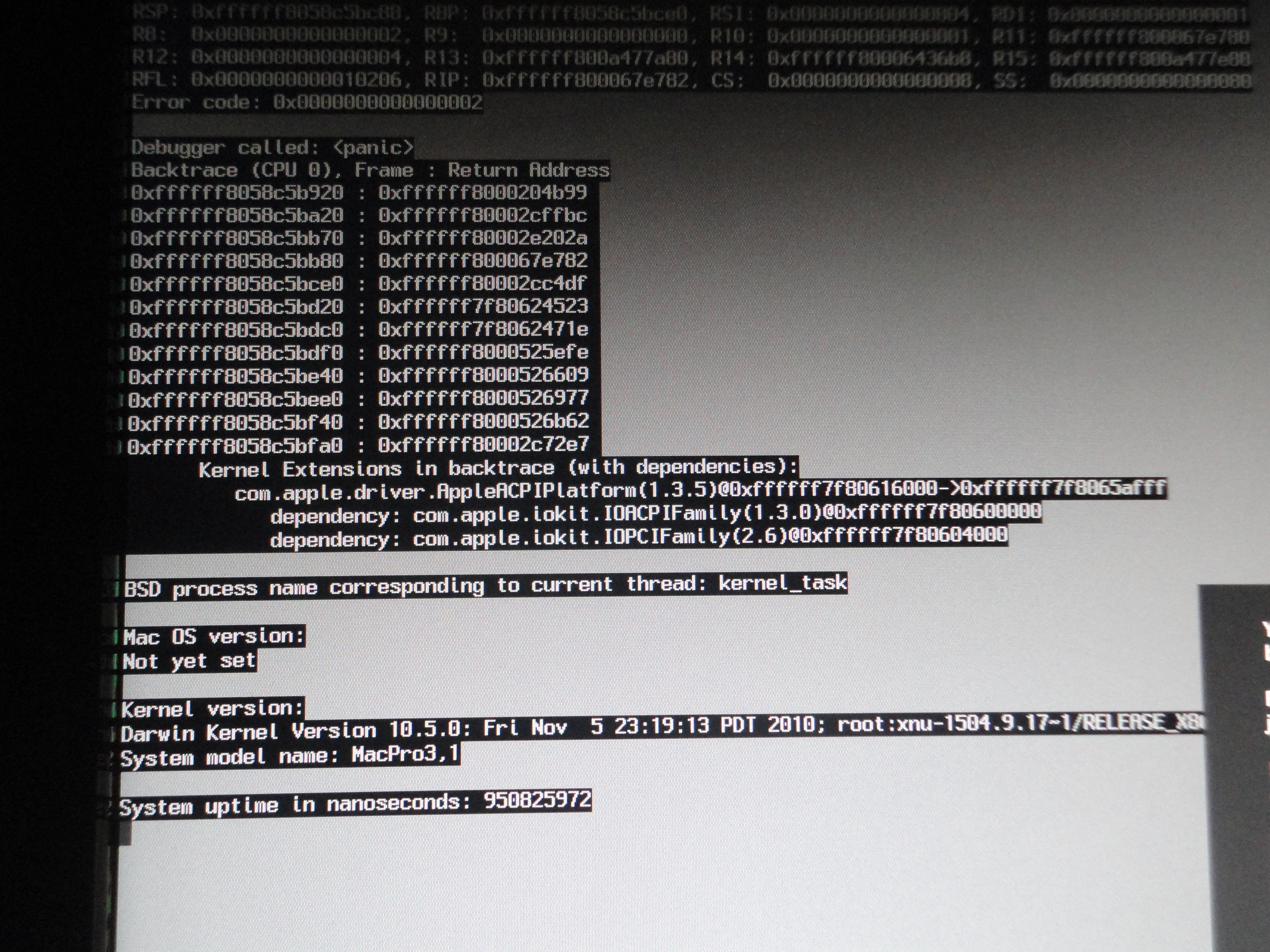

Here is the KP screen. How does one go about getting the kernel log?
The problem kext may be AppleACPIPlatform.kext and/or its dependencies, IOACPIFamily and IOPCIFamily kexts.........you could try an earlier version of AppleACPIPlatform.kext e.g. 1.3.2 i.e. pre-1.3.5.......
Go to Applications >>> Utilities >>> Console........double-click on Console, then look in the following sections:
DIAGNOSTIC AND USAGE INFORMATION >>> System Diagnostic Reports and User Diagnostic Reports
FILES >>> ~/Library/Logs >>> Crash Reporter and/or Diagnostic Reports
FILES >>> /Library/Logs >>> Crash Reporter and/or Diagnostic Reports
FILES >>> kernel.log

@ RaMDay Nothing obviously jumps out from your log relating to your KP screenshot......except that in my kernel log I only find instances of "ACPI_SMC_PlatformPlugin::start - waitForService(resourceMatching(AppleIntelCPUPowerManagement) timed out", whereas in your log I also see an instance of "AppleIntelCPUPowerManagementClient: ready"........
How are you dealing with AppleIntelCPUPowerManagement.kext.....?
I'm using NullCPUPowerManagement.kext at the moment.
So am I........so no obvious reason for the difference in the kernel log.........

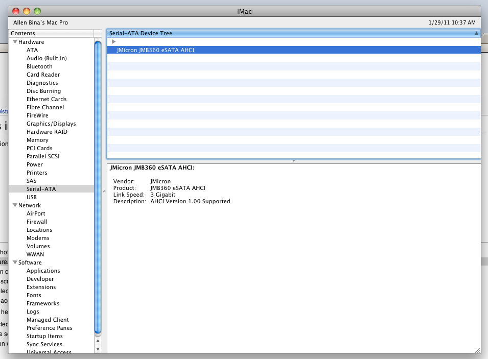

{censored}, going to edit this again. also don't have esata working. Don't need it badly, but would like it. I'm looking over the recent threads from a couple pages back to figure this out, will report back.
