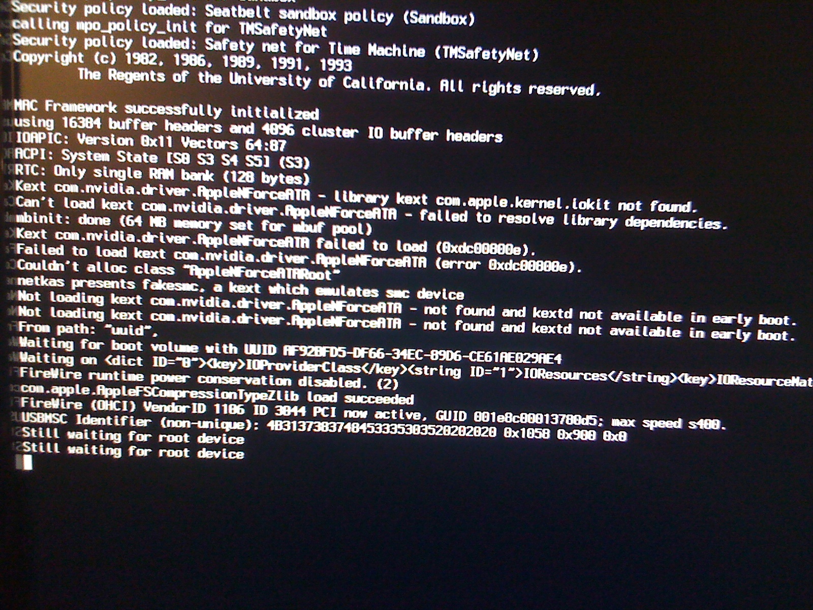

Finally got some time to upgrade from 10.5.8 to 10.6.3 this past weekend. I would like to announce success story. The details of my build are in my sig, but I can honestly say that everything is at least 95% to how it was in 10.5.8. The only major item to resolve is the shutdown/reboot issues I am having.
I have graphics fully running through the same EFI Strings I used in 10.5.8. I never got any of the inject methods to work with my specific card, only EFI strings. Audio is working with VoodooHDA, but not as well as my 10.5.8 method. VoodooHDA complains about not being able to find the max dbi levels. It works fine for me since my speakers have their own volume control, but with mute/volume all the way down, some sound is still audible.
I have tried SATA DVD with the newer Anv AppleNforceATA kext with no success. So far, no better than the slashack kext, but since I have 4GB RAM, I just have to deal with USB DVD for now.

Try aryajuanda's Snow Leopard compiled AppleNForceATA.kext.......see Part K. Item 4........ :)
I will try when I get home tonight. I'm assuming this is to possibly get 64bit since there's a comment in the same section saying SATA DVD is still a bad idea?
Yes it is apparently for Snow leopard compatibility as haroot reports........I have yet to try it myself to see if is fully functional 64bit.....

Much testing has been done tonight....with results :D
First, BIOS update went without a problem, but no change on the DSDT compile errors, but that will lead us to the next item.
Installed Chameleon RC5pre8 to see if it would solve my shutdown/reboot problems. It didn't :rolleyes: . So, I decided to test some more. Thinking the DSDT.aml was the problem, I removed it from /Extra to see if that solved the problem, just putting the CMOS reset bug back into play. It didn't solve the shutdown/reboot problem, but to my surprise, I had no CMOS reset bug either. Is this something RC5pre8 may be solving now?
Next - more testing, more fun :rolleyes:
So, I removed VoodooHDA from /S/L/E and realized I previously had to also install nForceLAN in /S/L/E because it wouldn't load from /E/E even with modified IONetworkingFamily. A couple testing reboots later with both of those out of /S/L/E my machine started rebooting just fine. Long story short on this one, the shutdown/reboot culprit is nForceLAN 0.64.5. It will not load from /E/E, but will load either inside /S/L/E or with a symbolic link (a side note, VoodooHDA will work sym linked to /S/L/E :D )
So, without nForceLAN loaded, both Ev0reboot and OHR work with shutdown/reboot, with it loaded, problems ensue. I was looking for 0.64.4 or 0.64.3 to see if they would cause the same problem, but eno is only posting the 0.64.5 pkg now.
Last test done was with aryajuanda's AppleNForceATA, and it was a no go in 64bit....see attached blurry image :(
