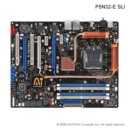

damn, i was trying to overclock my board (p5n32-e sli plus with the q6600 g0)
after the succesfull flash (thanks again to verdant) i was checking the bios, man the standard temp (2.4 ghz NO overclock) was 90 c +!!!! i checked it in windows 7 and it was 97c/100c!!!! with no overclock at all. so i thought maybe there was something wrong with the flash and flash't it back to the latest version.
still 87c!! i turned out the pc and waited a while. After 15min. i started and the temp. was 51 c. but after a few minutes it was again 87 c.
how come??? is my cooler dead? do i have to order a new one for a stable overclock? or is there something else wrong?
and which one do you recommend? and do i also have to buy other stuff? (i have a 8800gt card, do i need a better cooler for the gpu)>?
in the overclocking guide you are clocking your memory from 600 to 667. i have 4x2 gb 800 mem. do you know to which value i can overclock it.?
edit: this will also explain the random freezes (with the neverending ball) with CPU intensive handling.

Have you got your BIOS CPU internal temperature control setting disabled?
It certainly suggests that your CPU cooling fan is dead and/or your internal case cooling is totally insufficient (especially with a 8800GT graphics card).........see my blog entry on overclocking with details of my cooling arrangements and my temperatures when overclocking and running Prime95...........
whooh, after cleaning my pc (lots and lots of dust in the cooler), the temp lowers to 40 c
much better! this evening i will test the overclock again
edit: hmm 3 ghz, 68 c. maybe i'll buy a new cooler, which one is the best? still the same you use verdant? i have a coolermaster stacker case (huge) and i can put in more coolers inside the case. but i think the cpu cooler will the the best replacement.

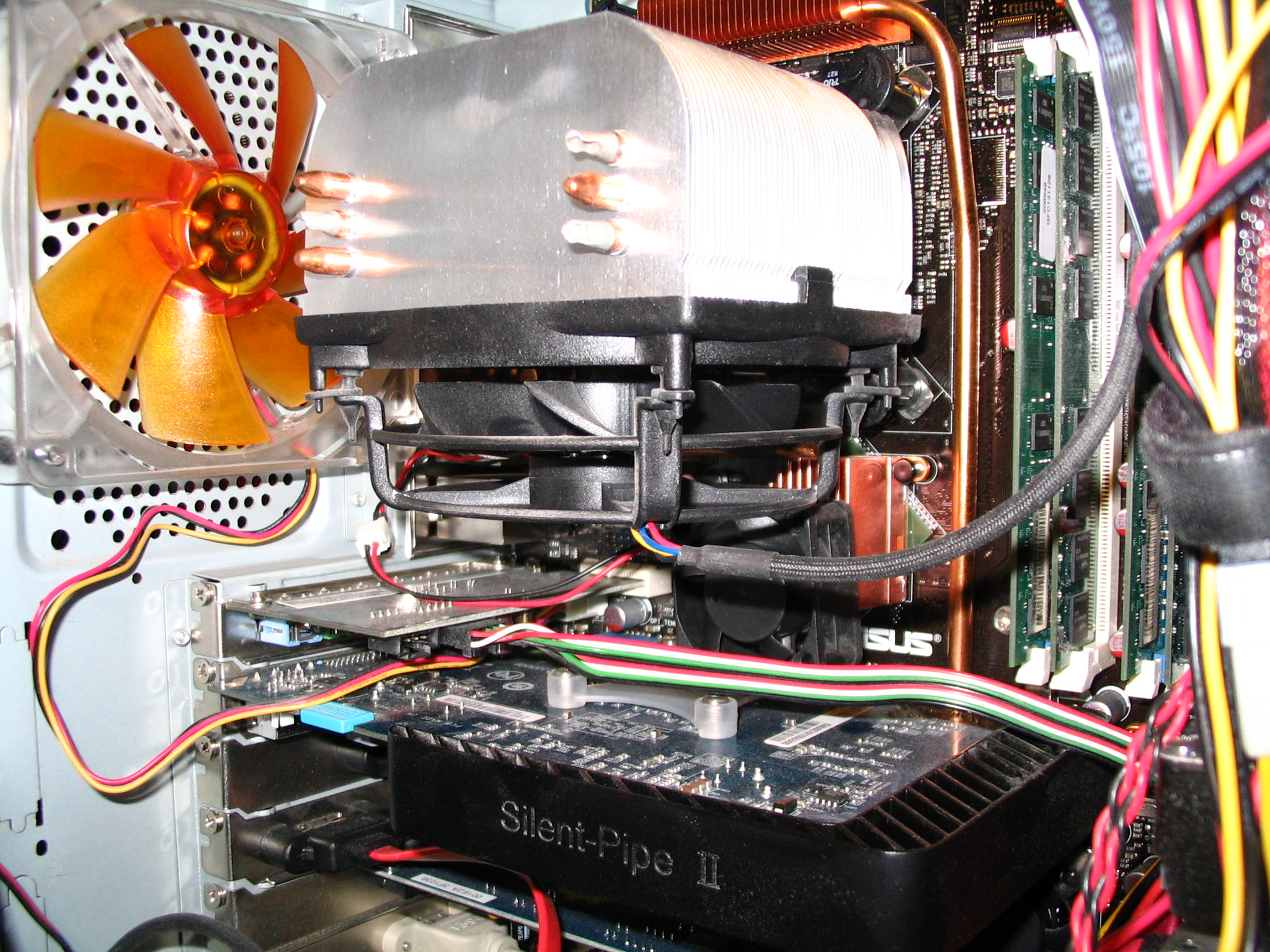

I chose the CPU cooler I did because of not wanting to take the motherboard out of the PC case to fit the CPU cooler and also because I wanted a low weight cooler (about 0.5 kg) because some cooler heatsinks are heavy enough (about 1 kg) to flex the MOBO.....!
For a review of Q6600 coolers, see here........ ;) and also for LGA775 generally, see here......
For version 2 (not push-pin mounting anymore..... :( ) of the Arctic Cooling Freezer 7 Pro cooler, see here.......... :)
For a review of Q6600 coolers, see here........ :) and also for LGA775 generally, see here......
For version 2 (not push-pin mounting anymore..... ;) ) of the Arctic Cooling Freezer 7 Pro cooler, see here.......... :)

ehm when i read the reviews, the stock cooler is better than your artic. Or do you have an other cooler?
The review link I gave you tested the Arctic Freezer 7 LP NOT the Arctic Cooling Freezer 7 Pro.....!

My MOBO is fitted in a XClio 3060 PC case, which has a 250mm variable speed case-side fan (set to rotate at its lowest speed of 600 rpm) blowing air into the PC case directly onto the motherboard and all its components.......
plus two 120mm Akasa Amber Ultra Quiet case fans (100% Duty Cycle mode) mounted on silicone rubber anti-vibration mounts; one at the rear and one at the front of the PC case, both extracting air from the case and running at full speed........
Here is a photo showing the Arctic Cooling Freezer 7 Pro rev.1 cooler inside my PC case, which can be fitted without removing the MOBO from the PC case.....
In order to clear the adjacent Southbridge heatpipe-heatsink at the top of the motherboard, the Freezer 7 Pro CPU cooler is mounted with its fan facing towards the bottom of the PC case i.e. towards the graphics card, as you can see in the photo.....the Arctic Cooling Freezer 7 Pro CPU cooler runs under PWM control (Q-fan mode) based on the CPU case temperature.....
You can also see the 120mm Akasa Amber case-rear fan that draws air out of the case and a Scythe Mini-Kase Ultra 40mm Quiet Cooling fan (100% Duty mode) mounted on the finned heatsink of the Northbridge chipset, to blow air directly on it.......this 40mm fan is mounted on the heatsink fins using "blobs" of Homelux OBO BathSeal Waterproof Fixing Adhesive tape (i.e. a Butyl rubber adhesive, which has both very good holding power against gravity [but is still removable] and vibration damping behaviour, with a maximum service temperature of 93C)
The Arctic Cooling Freezer 7 Pro CPU cooler is not in a bad orientation in my specific PC case cooling set-up, despite not being in the recommended orientation, as
(1) the case side fan blows cool air onto the CPU cooler heatsink top cooling fin face-on and onto the tops of the 6 heat pipes that are all on the same elevation (as you can see in the photo of the 250mm case-side fan).....
(2) the CPU cooler fan is blowing over the CPU cooler heatsink cooling fins in the vertical direction, i.e. the same direction as the rising hot air in the case, as well as over the top of the Southbridge heatpipe-terminating heatsink.....
(3) the rear case extract fan and the Arctic Power 700W PSU 80mm extract and intake fans (the PSU is out of sight, above the CPU cooler) are both drawing air from the vicinity of the CPU cooler heatsink fins........
(4) the CPU Cooler does not prevent the case-side fan airstream from blowing directly onto the Northbridge and Southbridge heatpipe-terminating heatsinks surrounding the CPU, as well as onto the RAM modules....... ;)
The graphics card is a Gigabyte Silent-Pipe II 8600GT 256MB DDR3 NX86T256H (600Mhz Core and 720MHz Memory) fanless card for quietness and no worries about a future GPU fan failure....
The Southbridge chipset has a Rasurbo 40mm Quiet Cooling fan (with its 4 mounting screws partially screwed into the fan frame) mounted on the Southbridge chipset's flat heatsink to blow air down on it (running in Q-Fan mode). This fan is also mounted using "blobs" of Homelux OBO BathSeal Waterproof Fixing Adhesive tape (i.e. a Butyl rubber adhesive, which has both very good holding power against gravity [but is still removable] and vibration damping behaviour, with a maximum service temperature of 93C)
There is a Noctua NF-R8 80mm Quiet case fan mounted (100% Duty Cycle mode), again using "blobs" of butyl rubber adhesive, on two rubber-bung stand-offs in the bottom of the case blowing air vertically upwards through the Gigabyte Silent-Pipe II graphics card's large black finned-heatsink (which is is clearly visible in the photo).....
The 120mm Akasa Amber case-front fan that draws air out of the case, draws cooling air directly over the bottom 3 of the 4 HDDs.......
All of the DDR2 667 i have used in my system has run stable at 800 - 850mhz w/ no voltage increase. Most newer DDR2 chips will get way up there (generally)
