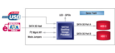

I am assuming that it is in an external eSATA enclosure........
My eSATA/USB 2.0 dual HDD enclosure uses the Silicon Image SiI5744 chipset, which is a low-cost, single-chip solution for digital home and small office storage appliances. This SteelVine® Storage Processor connects a USB 2.0 or 3 Gbps eSATA host port to two 3 Gbps eSATA Gen2m device ports. Features of the SiI5744 include advanced RAID modes, drive locking, and single-button backup.
My other 4 individual eSATA/USB 2.0 single HDD enclosures use the JMicron JM20336 chipset.....
What is your enclosure chipset?
Further info: BTW I just use Disk Utility to mount/unmount my eSATA HDDs.......

UPDATE: Some Wikipedia info:
As their standard interface, SATA controllers use the AHCI (Advanced Host Controller Interface), allowing advanced features of SATA such as hotplug and native command queuing (NCQ). If AHCI is not enabled by the motherboard and chipset, SATA controllers typically operate in "IDE emulation" mode which does not allow features of devices to be accessed if the ATA/IDE standard does not support them.
Windows device drivers that are labeled as SATA are often running in IDE emulation mode unless they explicitly state that they are AHCI mode or in RAID mode. Modern versions of Microsoft Windows, FreeBSD, Linux with kernel version 2.6.19 onward,[5] as well as Solaris and OpenSolaris include support for AHCI, but older OSes such as Windows XP do not. Even in those instances a proprietary driver may have been created for a specific chipset, such as Intels.[6http://en.wikipedia.org/wiki/Serial_ATA#cite_note-5
eSATA provides a variant of SATA meant for external connectivity.......
....The external connector and cable have a design-life of over five thousand insertions and removals, while the internal connector is only specified to withstand fifty.
Firewire can be problematic.......the Southbridge MCP chipset controls all the device I/O such as USB, SATA, PATA and Firewire.......what is your MOBO's Firewire chipset?......is it TI or VIA for example? You can use OSxTools to install lspci and find out.....or DPCIManager.....
