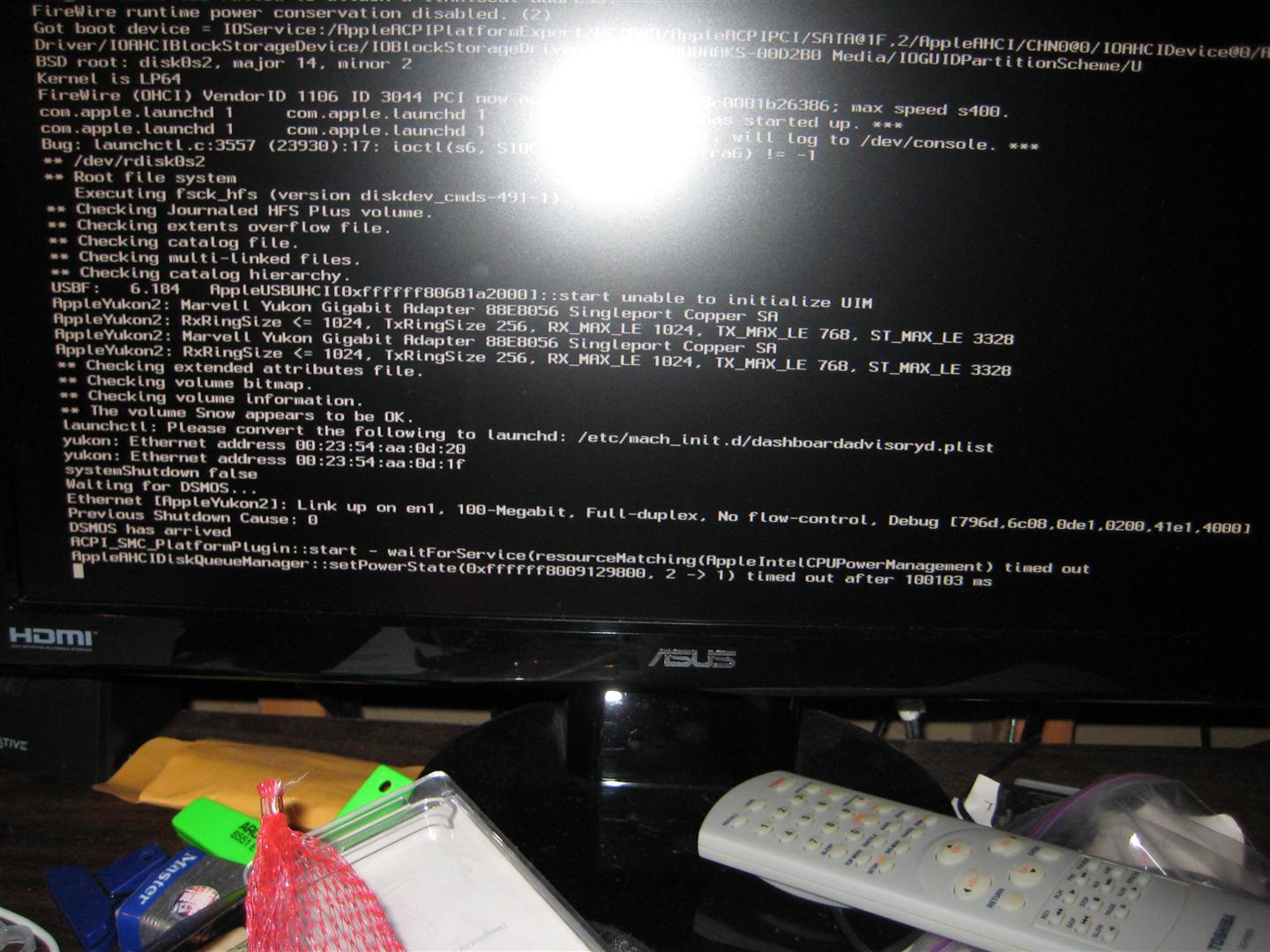

nayr14 Posted December 29, 2009 Share Posted December 29, 2009 Thanks for your suggestions. I added -x and -arch=i386 and I got farther DSMOS has arrived ACPI_SMC_PlatformPlugin::start - waitForService(resourceMatching(AppleIntelCPUPowerManagement) timed out [insert 5 minute pause here] AppleAHCIDiskQueueManager::setPowerState(0xffffff8009129800, 2 -> 1) timed out after 100103 ms [Hangs forever here, I just quit after 10 mintes] I tried the file from post #123 but had the same problem. I also tried it without it, with HT disabled and -cpus=1 and had kernel panics as before. I have the kexts from the first post loaded, nothing else. I followed those steps only. Any more ideas? EDIT:I went back and used no - infront of cpus and arch... boy it's been a long time since I've done this! Still no luck! Link to comment https://www.insanelymac.com/forum/topic/182978-how-to-guide-snow-leopard-retail-106-on-asus-p6t-deluxe-v2/page/14/#findComment-1371448 Share on other sites More sharing options...
Roswell_r Posted December 29, 2009 Share Posted December 29, 2009 Thanks for your suggestions. I added -x and -arch=i386 and I got farther DSMOS has arrived ACPI_SMC_PlatformPlugin::start - waitForService(resourceMatching(AppleIntelCPUPowerManagement) timed out [insert 5 minute pause here] AppleAHCIDiskQueueManager::setPowerState(0xffffff8009129800, 2 -> 1) timed out after 100103 ms [Hangs forever here, I just quit after 10 mintes] I tried the file from post #123 but had the same problem. I also tried it without it, with HT disabled and -cpus=1 and had kernel panics as before. I have the kexts from the first post loaded, nothing else. I followed those steps only. Any more ideas? EDIT:I went back and used no - infront of cpus and arch... boy it's been a long time since I've done this! Still no luck! You may have already tried this, but boot with 'arch=i386 -v -s' and perform fsck and mount your drive for write access and go to your extras/extensions folder and just rename some of the KEXT to something like 'kext.disabled' or w/e and see if that makes any difference? In particular try renaming the AHCI/BlockStorage injectors, IMO try disabling them all except fakesmc & openhaltrestart and see how far it gets you. Link to comment https://www.insanelymac.com/forum/topic/182978-how-to-guide-snow-leopard-retail-106-on-asus-p6t-deluxe-v2/page/14/#findComment-1371594 Share on other sites More sharing options...
nayr14 Posted December 29, 2009 Share Posted December 29, 2009 I tried your suggestion Roswell_r to no avail. I ended up renamed all to old*.kext except openhaltrestart and fakesmc and I didn't get to the AHCI errors, it just locked up after the firewire warning. I have attached a photo of the farthest I've gone using "-v -x" I appreciate the help has provided. It seems like I'm doing something small wrong. I'm just not sure what it is. V1 & V2 should be very similar that these steps should work EDIT: I have macdrive installed, and when I start up in windows it says the disk may be corrupt. (I think because I've shut it down while booting? It didn't say that before until I shut it down while loading.) It does let me edit files with no problems though. Link to comment https://www.insanelymac.com/forum/topic/182978-how-to-guide-snow-leopard-retail-106-on-asus-p6t-deluxe-v2/page/14/#findComment-1371918 Share on other sites More sharing options...

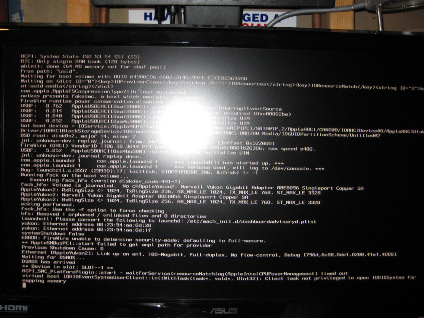

nayr14 Posted December 29, 2009 Share Posted December 29, 2009 Update: I booted with out the dsdt, HT disabled, 1 Active Core, AHCI with "cpus=1 -x32 -v -f" Check the screenshot The thing is.. when I press my power button it comes up and says something like "system sleep" and puts down my network adapters, setting the system to sleep. Is the GUI not coming up for some reason?? I typed some stuff before I pressed the power and i got the red LED flashing for 5-10 seconds or so, which indicates to me something is running that I cant see :s Link to comment https://www.insanelymac.com/forum/topic/182978-how-to-guide-snow-leopard-retail-106-on-asus-p6t-deluxe-v2/page/14/#findComment-1372129 Share on other sites More sharing options...
dgobe Posted December 29, 2009 Share Posted December 29, 2009 Ditch the PS/2 keyboard for a USB one and see what happens. I think someone posted that their V1 was working with the V2 files so you should be able to get it working. What video card do you have? Link to comment https://www.insanelymac.com/forum/topic/182978-how-to-guide-snow-leopard-retail-106-on-asus-p6t-deluxe-v2/page/14/#findComment-1372133 Share on other sites More sharing options...
