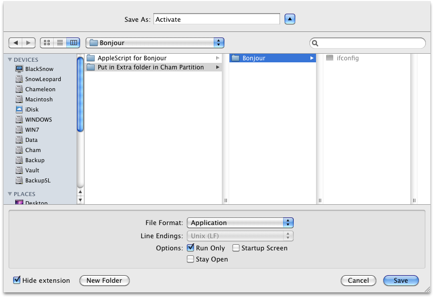

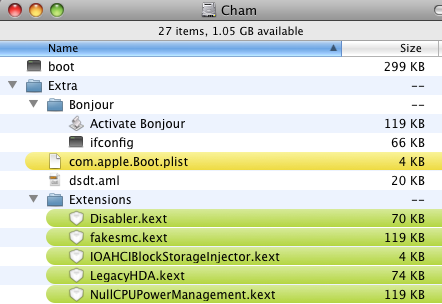

blackosx Posted September 2, 2009 Author Share Posted September 2, 2009 Okay guys, after a couple of days with using ifconfig for the bonjour fix, I am suggesting the following for making it run automatically. Make an Applescript with the command to run ifconfig and add your password, save it in /Extra/Bonjour along with ifconfig, and add the script to your login items to automatically run it at login. I have attached a Zip archive containing what you need and a read me. Hopefully it makes sense as it's so simple to do, I feel the instructions seem a bit long... anyway let me know how you get on with it and after a little while I will add it to the support files. I have also attached a couple of screenshots just in case anyone gets confused... (I have to credit the applescript to scorcho) Bonjour.zip Link to comment https://www.insanelymac.com/forum/topic/180954-guide-vanilla-retail-106x-with-chameleon-v2-for-gigabyte-ga-ep45-ds3l/page/16/#findComment-1248260 Share on other sites More sharing options...

flyguyjake Posted September 2, 2009 Share Posted September 2, 2009 Hi flyguyjake The answers have been covered here previously in this thread and just earlier by titan4. For your HD's showing as external, you need to have IOAHCIBlockStorageInjector.kext installed in /E/E. Kext Utility won't see the /Extra folder with this install because I have recommended you install Chameleon to a separate partition. Kext Utility looks for it on the system partition. The disk utility error is a side effect of using the OSInstall.mkpg method. It can be fixed by reinstalling SL on top of your current install or running some BSD.pkg - you'll have to search for that fix as I haven't tried that method. Hi Blackosx, Good day to you! I have all of the kexts installed from your support file-kext folder which includes IOAHCBlockStorageInjector.kext installed in chameleon/E/E As far as the HDD issue, All of my drives are internal Sata drives. In finder pref's some are showing up as internal and some are showing up as external. The 2 drives that are showing up as internal have chameleon installed with osx 10.5.5 & 10.5.6. The HDD with cham & snow partitions is the one showing up as blue folders. When using sudo kextstat, are there any kexts to look out for that should or shouldn't be loading? Perhaps this is causing my KP if I can pinpoint the vanilla or cham e/e/kext causing it. Link to comment https://www.insanelymac.com/forum/topic/180954-guide-vanilla-retail-106x-with-chameleon-v2-for-gigabyte-ga-ep45-ds3l/page/16/#findComment-1248606 Share on other sites More sharing options...
