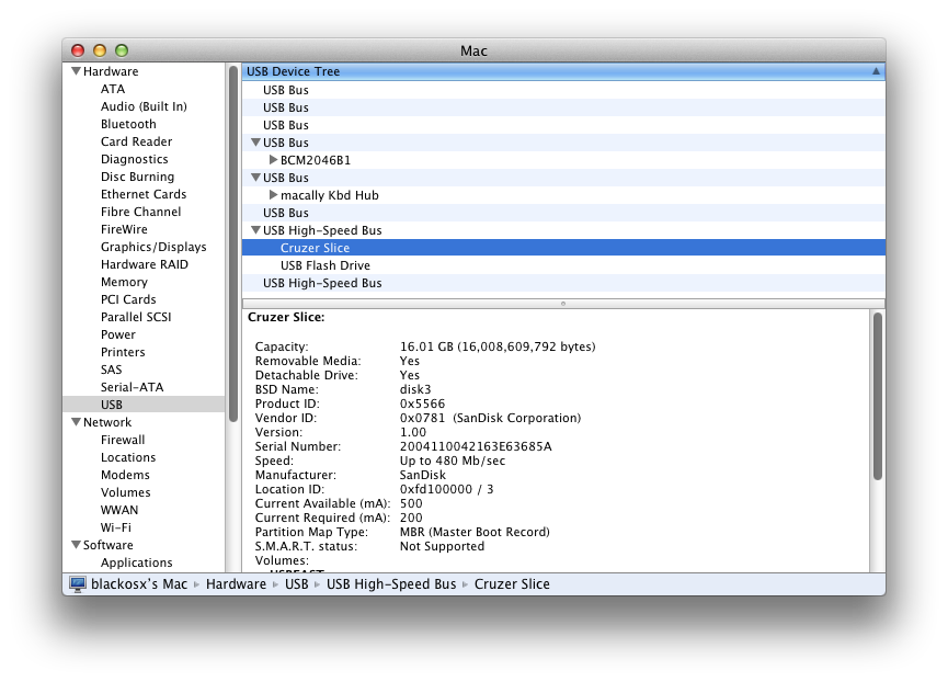

So I made a USB with Chameleon per the instructions found on the opening post. Chameleon boots and finds my OSX partition, but when I click it, I'm prompted with "can't find mach_kernel." I'm automatically returned Chameleon's main menu, so I tried it again (this time, with the "-x" flag for a safe boot), and the system kernel panics.
Does anyone have *any* recommendations whatsoever, so I don't have to reformat my entire system?
Hi RKmd
Don't worry, you won't need to reformat your system.
Your quickest option might be to try the BootCD, but a bootable USB should work just fine. I have three different ones here and they have saved my bacon on more than one occasion.
I know you've already made one but if you have access to an OS X system then try making a bootable USB again using the latest Chameleon RC5 files from the trunk. Here you go.
Chameleon_RC5_699.zip
You've got the instructions in the PDF and for speed just add fakesmc.kext to /Extra/Extensions.

As for the USB audio. Check in System Profiler/USB for the current available and the current required for it. See if they tally up.. For example, see the screenshot below where I have highlighted one of my USB flash drives which draws 200 (mA) from the available 500 (mA).

As for the USB audio device, the available current listed is 500, and the required current is 480, so it should work. However, the control panel for the device does not see it, and the led on the unit does not light up. It does work when connected to my 10.6.6 powerbook.
