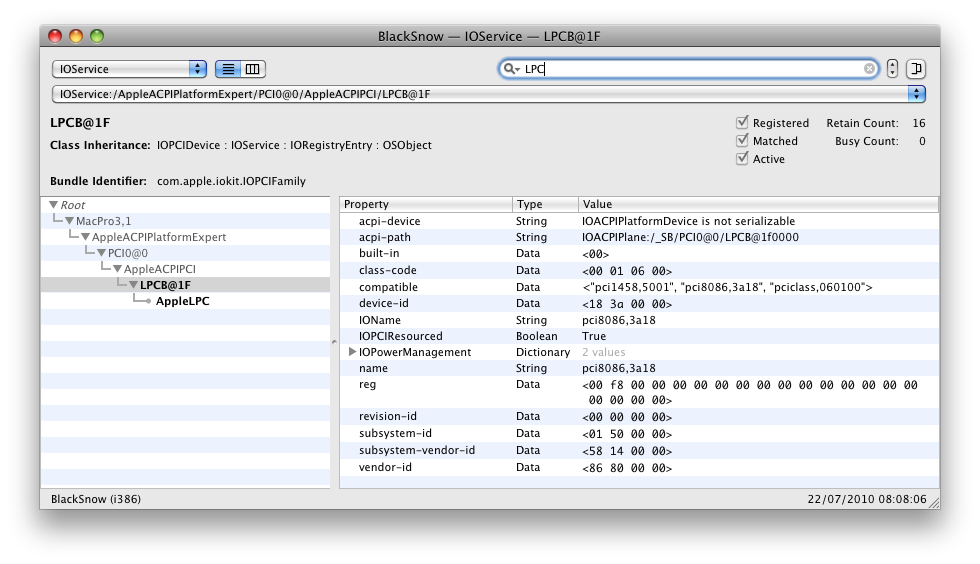

Having said that, I had to report that latest developments with the Chameleon RC5 pre-release bootloader. While there has been continued bug fixing, updates and new features there is one big feature that Mozodojo created - Vanilla Power Management (a.k.a. speedstep).
To use this you will need the following:
• The latest Chameleon RC5 pre-release r193.
• The DSDT.aml from the support files in this thread (if you have a DSDT already patched with _PSS / _CST data then that will cause a KP)
• AppleLPC must be loaded - This is enabled by default on the EP45-DS3L.
If you're NOT running the EP45-DS3L then you will need to check it is and if it's not then you will have to patch Device (LPCB) in DSDT - See FormlerlyknownAs's Opening Post on the Vanilla Speedstep thread for further details.
• Not be using NullCPUPowerManagement.kext or SleepEnabler.kext
• Add the following to your /Extra/com.apple.Boot.plist
<key>GeneratePStates</key>
<string>Yes</string>
<key>GenerateCStates</key>
Note: You may also need to add (depending on your CPU)
<key>DropSSDT</key>
It's wise to have a separate Chameleon install on a secondary HDD, bootable USB stick or BootCD handy that you know works for you system just in case you get a memory allocation error when booting from this. If you do get that error then you will want to add the DropSSDT boot option to /Extra/com.apple.Boot.plist
I have updated the Support Files to v1.4.1 to contain the latest version of the Chameleon bootloader for this and posted it on the front page.
