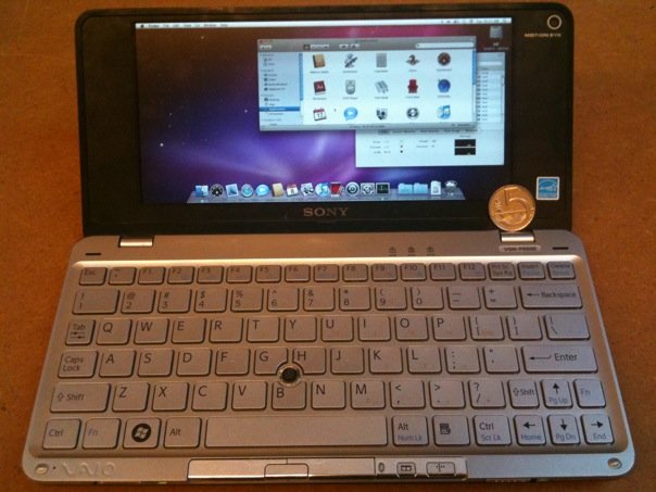

MagForAll Posted January 6, 2010 Share Posted January 6, 2010 Hi guys, I finished my play with my Vaio and Snow Leopard, so its time to say good bye and find new toy to play :-D If any one want this, just let me know. Fully functional with Snow Leopard Sony Vaio VGN-P688E - Snow Leopard, Windows Vista, Live Linux for fast mode * 600g !!! :-P * 1.33GHz Intel Atom * 64GB SSD * 2GB RAM * 8" LCD LED 1600x768 * WiFI a/b/g/n * BT 2.1 EDR * Broadband mobile modem * GPS * SD/MMC/MS * 2x USB 2.0 * Webcam * expandbox with 1Gbit LAN, VGA and so on... Link to comment https://www.insanelymac.com/forum/topic/168426-snow-leopard-on-vaio-pvgn-p90hs-working/page/13/#findComment-1377939 Share on other sites More sharing options...
