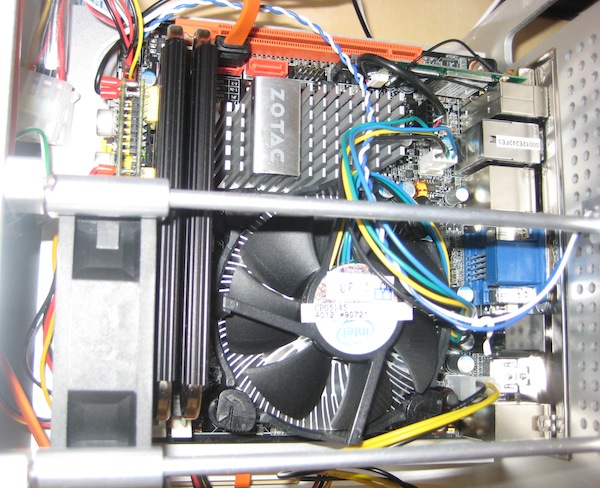

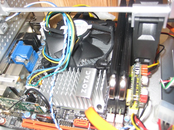

I think several of us have the same problem. I have a small fan (40mm) directly over the heatsink for the GPU, as there is no airflow from the CPU cooler in my system (psile). Another issue could be if you are overloading the PSU, assuming you are using a PicoPSU - too many USB devices (or in my case, the Diseqc switch on a satellite dish) can do it.
@ntsmkfob

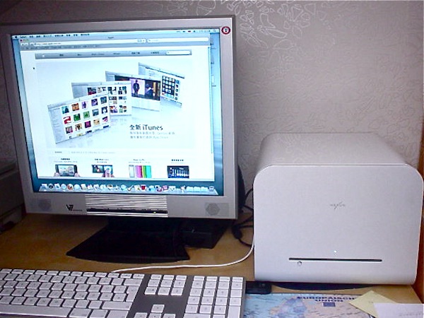

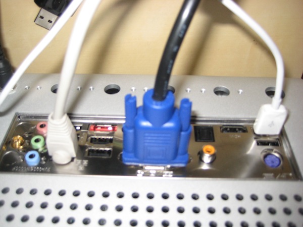

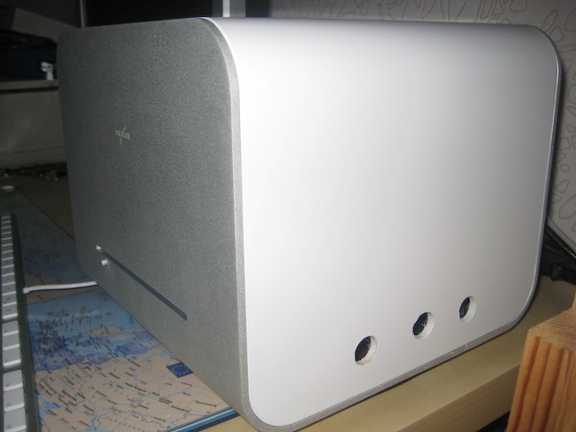

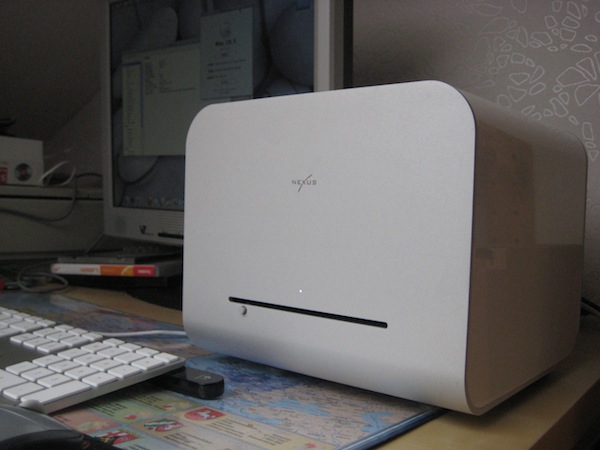

For the cooling, I made some holes on the sides of the Psile case. It works fine by cooling. (It maybe not so good looking.)
post-412027-1271156308_thumb.jpg post-412027-1271156321_thumb.jpg post-412027-1271156435_thumb.jpg
post-412027-1271156344_thumb.jpg post-412027-1271156351_thumb.jpg post-412027-1271156360_thumb.jpg
That's quite neat. I abandoned my plan to cut a hole in the side for a fan, as there was very little clearance and any obstruction close to a fan seems to generate noise. I'm tempted to get one of these in-car cases and hide the thing behind the TV, bolted to the wall.

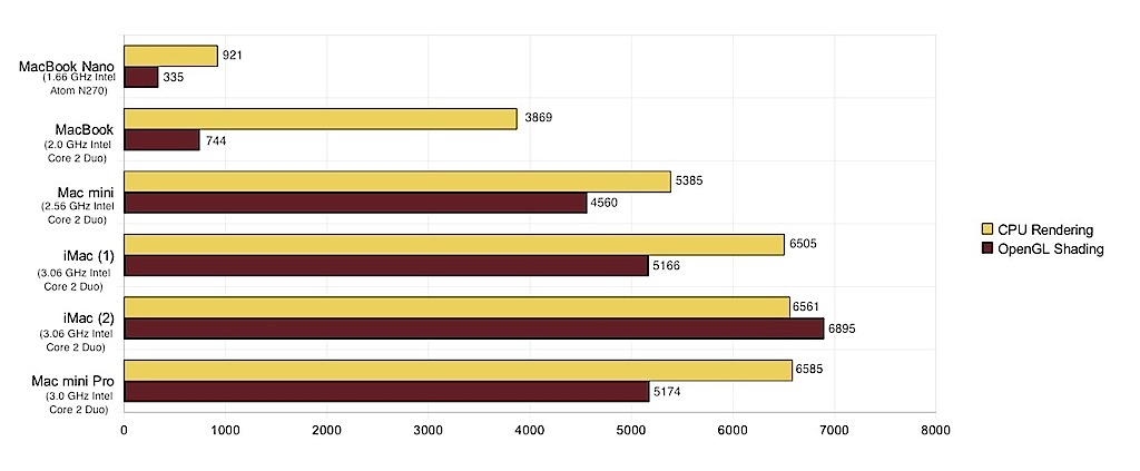

Benchmarks comparison:
iGPU OverClock = 650
Shader OverClock = 1500
1. MacBook Nano: Intel Atom N270 1.66 GHz, 2 GB DDR2-667 RAM, 160 GB HDD/5400, Intel GMA 950/64 MB RAM Shared Memory
2. MacBook: Intel C2D 2.0 GHz, 2 GB DDR2-667 RAM, 250 GB HDD, Intel GMA 950/64 MB RAM Shared Memory
3. Mac mini: Intel C2D 2.53 GHz, 4 GB DDR3-1066 RAM, 320 GB/5400, nVIDIA GeForce 9400M/256 MB RAM Shared Memory
4. iMac (1) 21.5": Intel C2D 3.06 GHz, 4 GB DDR3-1066 RAM, 500 GB HDD/7200, nVIDIA GeForce 9400M/256 MB RAM Shared Memory
5. iMac (2) 27": Intel C2D 3.06 GHz, 4 GB DDR3-1066 RAM, 1 TB HDD/7200, ATI Radeon HD 4670/256 MB DDR3 RAM

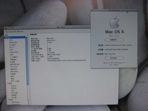

6. Mac mini Pro: Intel C2D E8400, 3.0 GHz, 4 GB DDR2-800 RAM, 500 GB HDD/7200, nVIDIA GeForce 9300/512 MB RAM Shared Memory :(

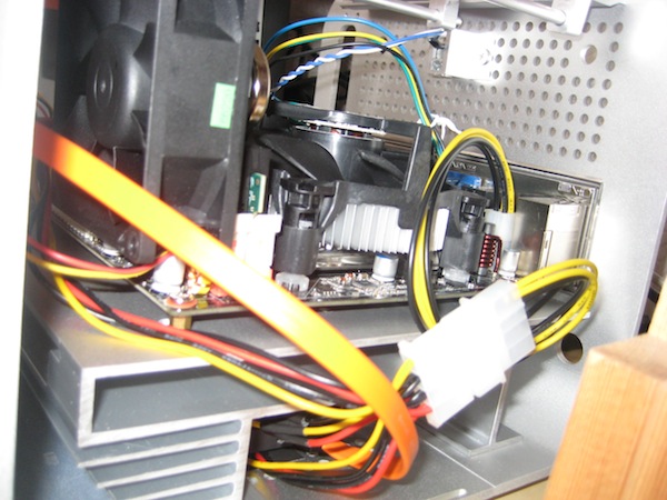

for those who might be interested in some system pics
