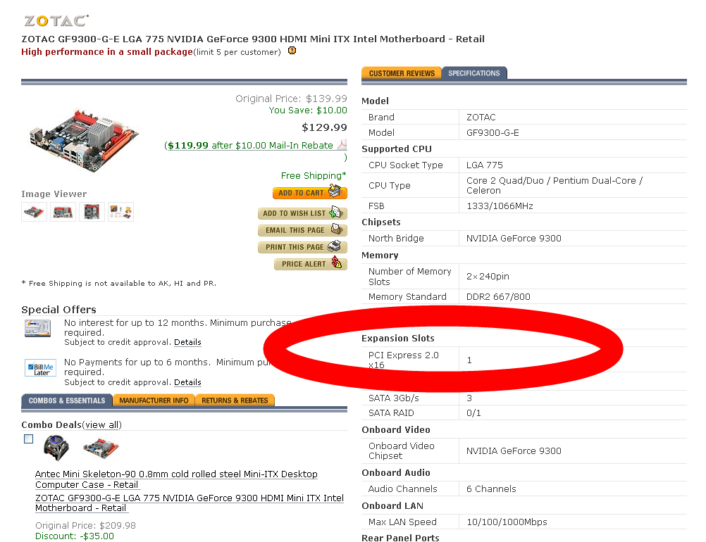

also this "Airport PCI-e----------30" will not work! the GE doesn't have a spare PCIe because the wifi included is connected via USB header.. your only option is to buy a USB wifi or choose other ITX by Zotac
I thought that the GE has a PCI-E 2.0 slot? :whistle:

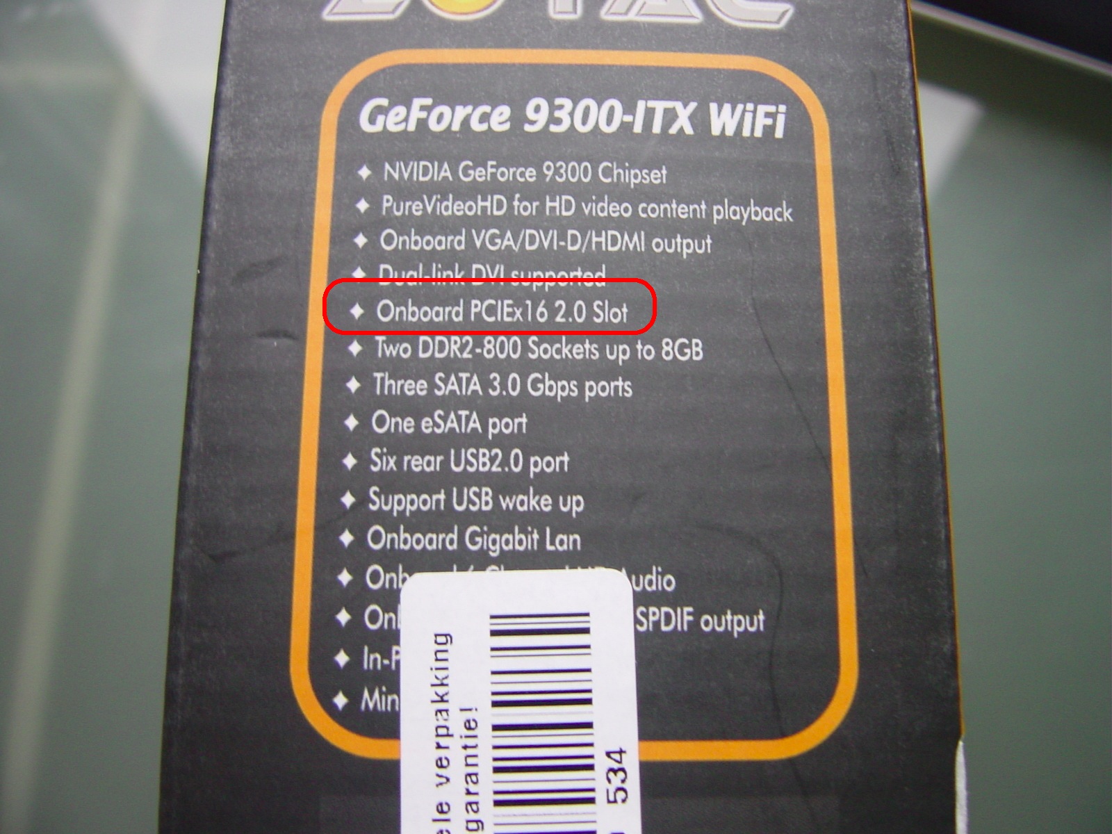

Info on the box
sorry about that, what i meant is mini PCIe which is available on other itx by zotac.. or unless im really out of the loop and you can fit an airport card on a PCI Express slot which is for Graphic Cards.. ;)
sorry about that, what i meant is mini PCIe which is available on other itx by zotac.. or unless im really out of the loop and you can fit an airport card on a PCI Express slot which is for Graphic Cards.. :)
you did read my post and the other post before me right? if so then it's already answered.
I didn't see it was a mini PCI-e, will this card work:
