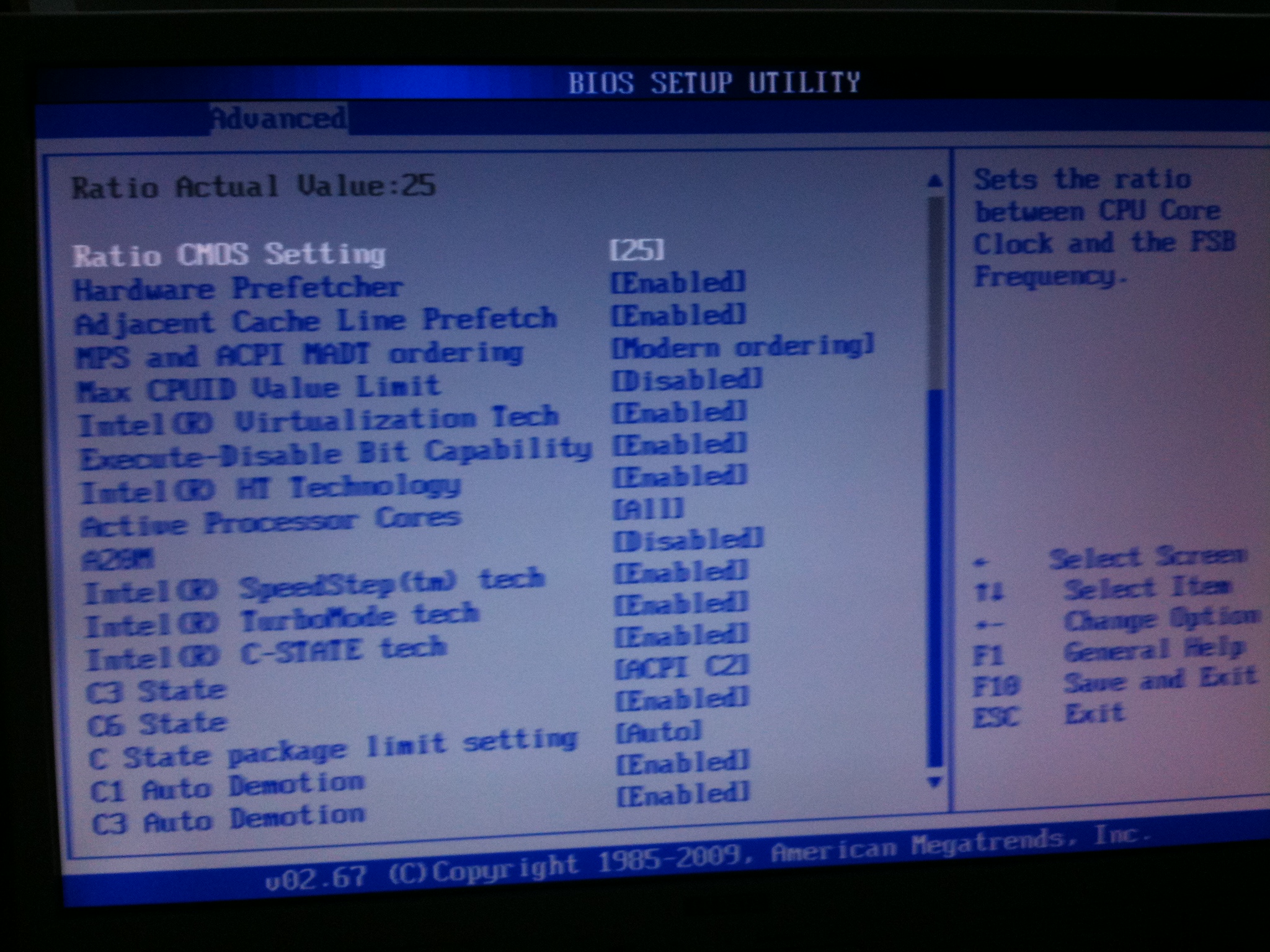

i use snow leopard retail
zotac h55-itx wifi
intel® core i5-661 3.33ghz lga1156
i try many bootloader but all not work!
I believe support for i5 only came in Snow Leopard. Are you using Snow? More details would be necessary.

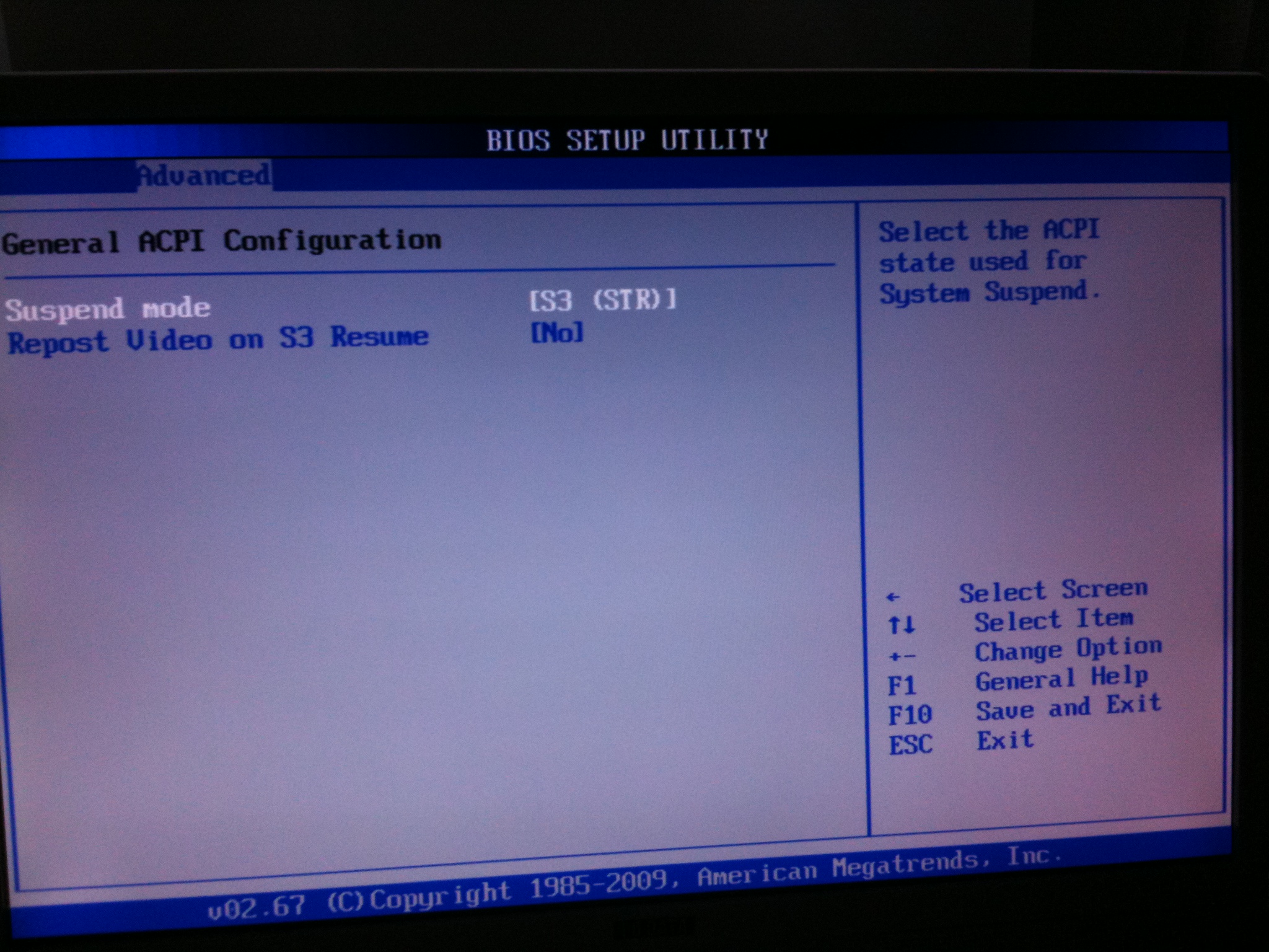

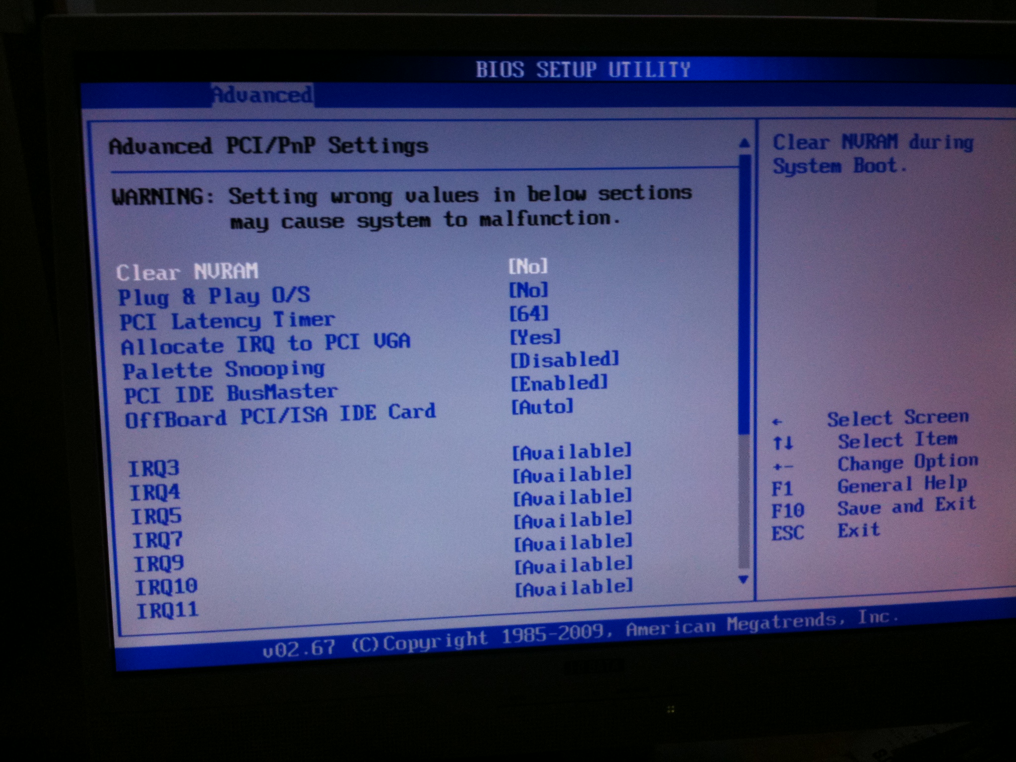

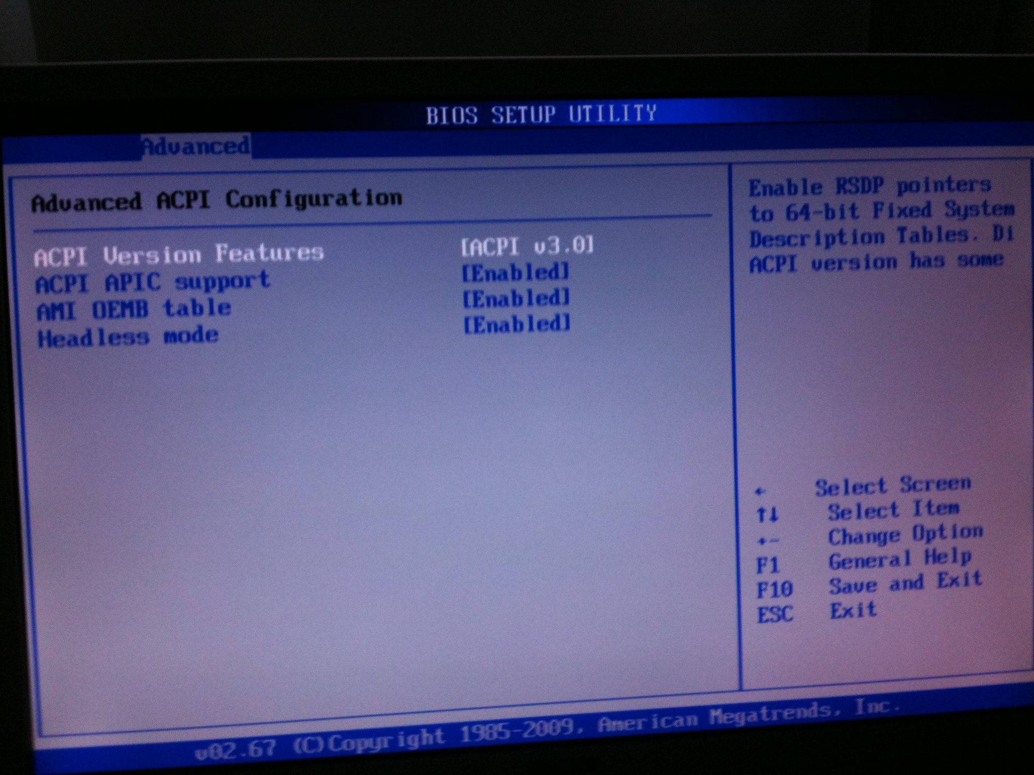

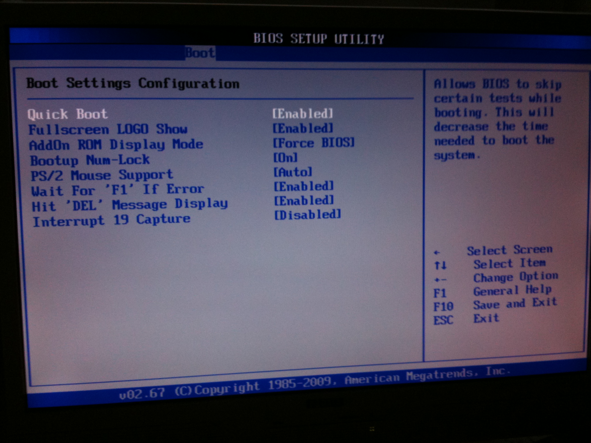

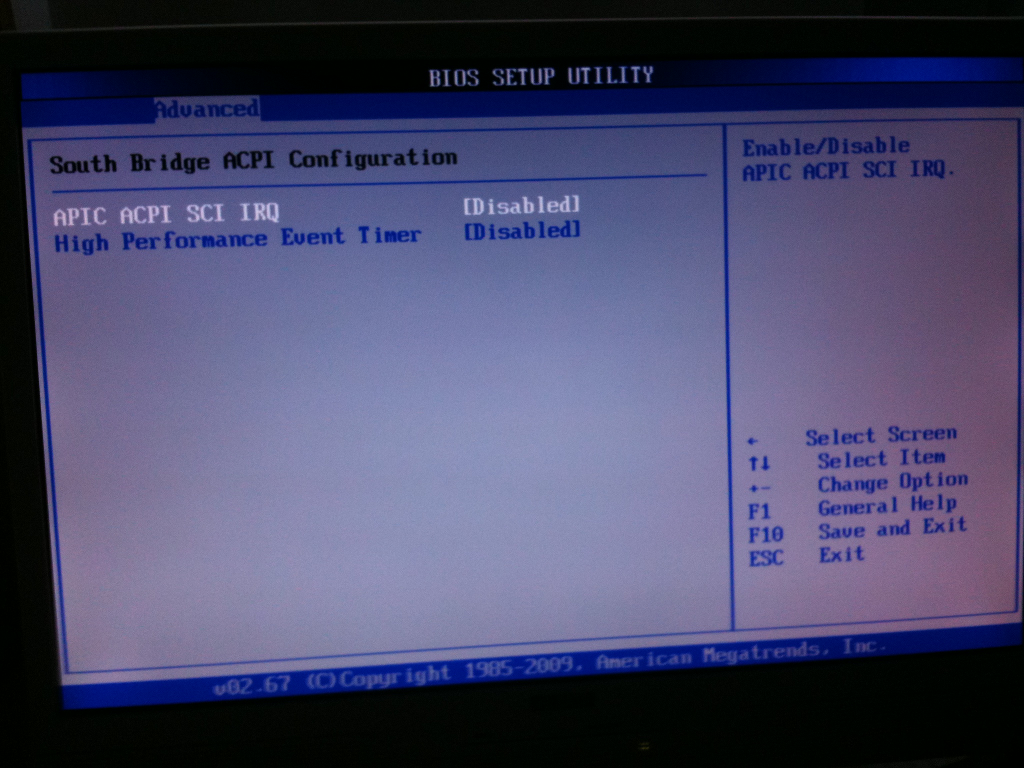

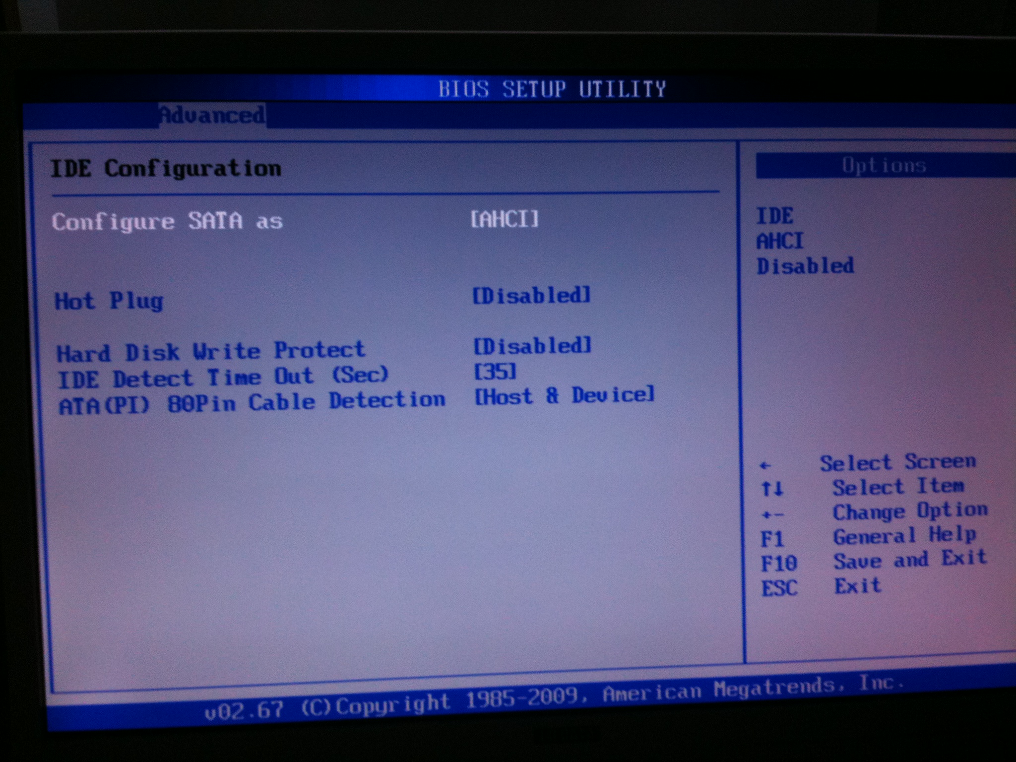

this my bios
Patrick
bios
Patrick
