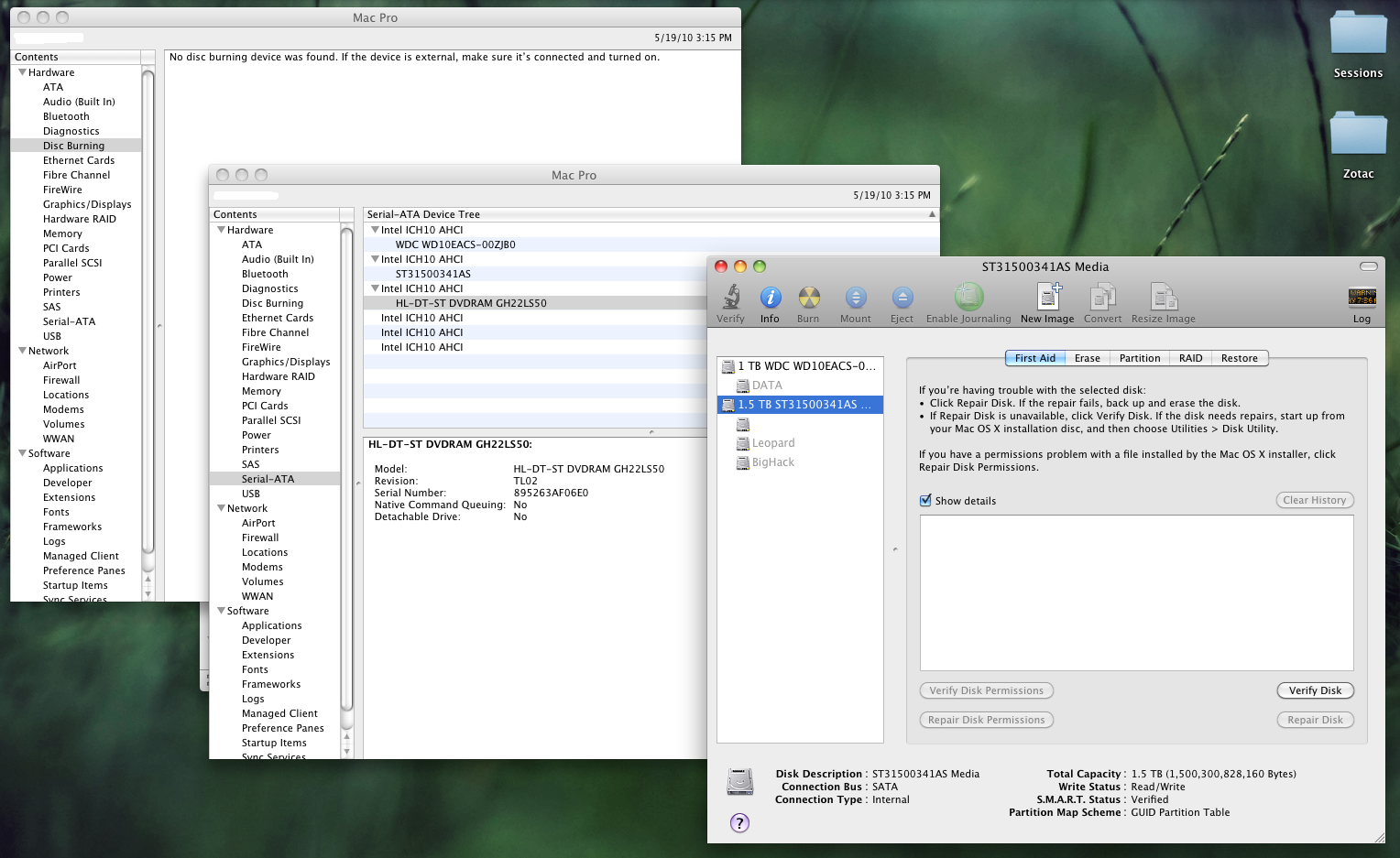

the above is not my problem but my LG Lightscribe DVD Writer.. under AHCI and OSX my dvd drive won't get detected.. not sure what is the problem but it works in windows and linux so im sure the drive is working properly. i tried all 5 sata ports but all of them has the same output. it's detected under system profiler (sata) but Disk Utility cant see the disc/drive when i insert one..
suggestions? anyone can help? :P
