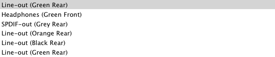

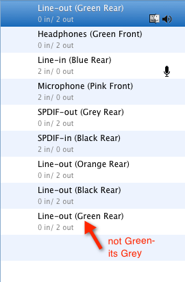

joshhh Posted February 6, 2010 Share Posted February 6, 2010 OK guys! Finally after a day of attempts it starts working for me with X-Fi Extreme Audio and all analog output. I've checked all connectors - green, orange, black and grey and all outputs sound simultaneously. And this was a good news! <key>NodesToPatch</key> <array> <dict> <key>Codec</key> <integer>1</integer> <key>Config</key> <string>[color="#FF0000"]0x01014010[/color]</string> <key>Description</key> <string>Green Line Out 1/8" stereo/mono Jack External Rear</string> <key>Node</key> <integer>11</integer> </dict> <dict> <key>Codec</key> <integer>1</integer> <key>Config</key> <string>[color="#FF0000"]0x01016070[/color]</string> <key>Description</key> <string>Orange Line Out 1/8" stereo/mono Jack External Rear</string> <key>Node</key> <integer>12</integer> </dict> <dict> <key>Codec</key> <integer>1</integer> <key>Config</key> <string>[color="#FF0000"]0x01011080[/color]</string> <key>Description</key> <string>Black Line Out 1/8" stereo/mono Jack External Rear</string> <key>Node</key> <integer>13</integer> </dict> <dict> <key>Codec</key> <integer>1</integer> <key>Config</key> <string>[color="#FF0000"]0x01014090[/color]</string> <key>Description</key> <string>Grey Line Out 1/8" stereo/mono Jack External Rear</string> <key>Node</key> <integer>14</integer> </dict> </array> After that I've try to figure out how to make 5.1 configuration. Goggling said me about Aggregation Device. I've try tom do 5.1 output with it. All my outs works with 16bit 44khz settings, when I add it to Aggregation Device configure 5.1 and select device for sound output sound stops playing. Only changing first Green out to different sample rate enables sound, but I'm loosing ability to control sound levels from top bar and system preferences. I also played few videos with 5.1 sound and I think all speakers outs the same front channel stereo but in clone version=) Don't know what to do with 5.1/7.1 config. By the way when I've patched plist new devices appeared in sound config panel for output for input all the same After this attempts I also tried to remap my Mic (as voodoo detects Pink Front Mic) and Line-In(Blue Rear) with simply replacing Config strings mic to line-in / line-in to mic. Reboot and Mic still not working. Switching between line-in and mic as input had no result. <dict> <key>Codec</key> <integer>1</integer> <key>Config</key> <string>0x02a19040</string> <key>Description</key> <string>Line in</string> <key>Node</key> <integer>16</integer> </dict> <dict> <key>Codec</key> <integer>1</integer> <key>Config</key> <string>0x01813030</string> <key>Description</key> <string>Mic</string> <key>Node</key> <integer>17</integer> </dict> Strange strange sound card is X-Fi extreme audio, it has 4 analog outputs on back, one analog input combined with mic input on back too, two optical SPDIFs i/o on back and on card inside PC as manual said has front panel connectors with headphones and mic. Any help required. Plaese=) Link to comment https://www.insanelymac.com/forum/topic/161638-voodoohda/page/10/#findComment-1405074 Share on other sites More sharing options...
