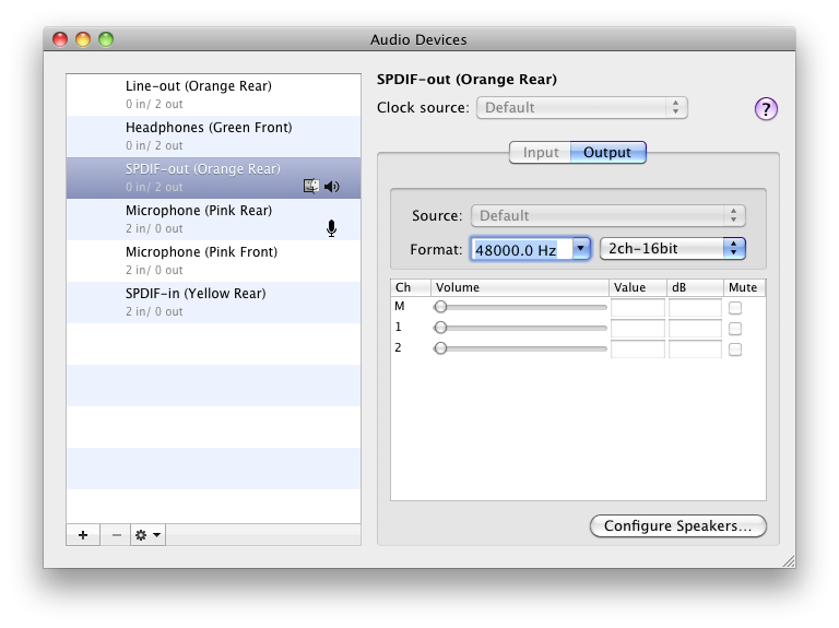

HAHAHA, glorious sound again! Ok, the sound cracking/distortion was absoutely terrible. But on a hunch I went to Audio MIDI setup in Apps/Utils and played around with some settings. I had it set on 2-CH 32bit. I keep the frequency to 48khz, and changed the 2-CH 32bit to 2-CH 16bit. Et Voila, beautiful sound thru Itunes, Imovie, Quicktime, basically all audio.
So if you're getting horrid cracking/distortion make SURE you set the output to a frequency/bitrate your ALC allows.

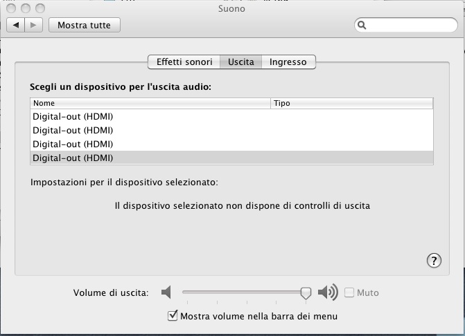

In Sound Preferences, the only sound device that shows up is "Digital Out". I don't have digital out/input on my laptop, and the weirdest part is that this "device" shows up 4 times. I'm assuming that there should be something different displaying for output? Also, Nothing shows up under Input...

play something like a song in OSX and while the song is playing then switch between the multiple digital outs is sysprefs and see if anything of the "digital-Outs" "work" with the internal speakers. if they dont then plug in a some headphone to your jack on your laptop and repeat the process.

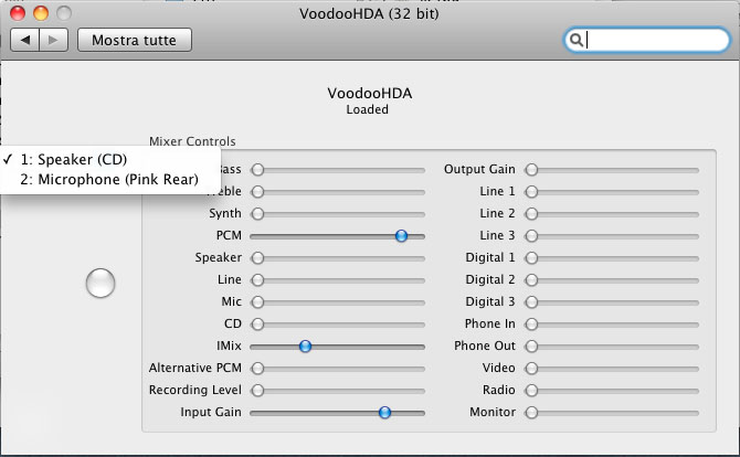

Now i'm having an issue where the Input Gain in VoodooHDA Pref pane will be up every time I log on, and no matter how many times I turn it down, it pops back up upon reboot... This is annoying because the integrated mic is always active and I can always hear myself...
