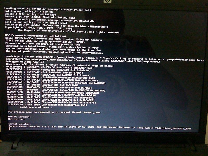

Hi guys. I need some help with this kernel.
My notebook is a hp 530.
CPU = Intel® Core Duo CPU T2700 @ 2.33GHz
Video GMA 950. Wifi 3945ABG. Lan Pro 10/100 VE. I'm attaching a txt file with full hardware specifications.
I did a fresh install with iatkos 5i. These was the otions selected.
Bootloader = PC EFI v9
Decrypter= SMBIOS-EFI Air
ACPI=x86 ACPI
Disabler.kext
Remove Thermal Kexts
VGA = gma 950 b.
SATA IDE = Intel AHCI SATA
Speedstep = Intel Speedstep b
Laptop battery
Network Intel PRO/100 Ve.
I've booted this installation (with flag cpus=1) and installed all the OS updates.
Then i've installed your package and i've obtained the error i'm sending you attached. (without cpus flag).
With the flag boots ok. Sometimes, without the flag, boots but in few seconds the system ferezes.
Can you give me a hand to solve this? Thank You.

CPUS=1 (deactivating 1 core) is not a problem of kernel.
Its an buggy BIOS.
Maybe you get an modded BIOS for that or try dsdt patching.
An other kernel will not help for that cpus=1 problem.

Yes I agree... try a BIOS upgrade and see if that fixes the issue
