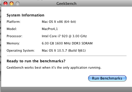

@ROBASEFR Posted June 15, 2009 Share Posted June 15, 2009 i find this hard to believe, what is your Vcore set to? at 3.0GHz i was seeing 20C higher temps than you with the stock cooler. now i have 48C idle and 74C loaded with a cooler master 520 and arctic silver paste. Well i use the same Temp monitor as you ! Perhaps my case is better cooling ? Here are some picture shots of my Temp monitor and Geekbench Link to comment https://www.insanelymac.com/forum/topic/149505-guide-retail-os-x-install-1058-on-gigabyte-ga-ex58-ud5-core-i7-mobo/page/71/#findComment-1178635 Share on other sites More sharing options...

joeblough Posted June 16, 2009 Share Posted June 16, 2009 Well i use the same Temp monitor as you ! Perhaps my case is better cooling ? Here are some picture shots of my Temp monitor and Geekbench i think my problem was using 'auto' for all my voltages. i asked around on the gigabyte forum and i was advised to use 'normal' for all the main voltages. after changing this my full-load temps are down about 4C (69-70C) @ 3.33GHz (166x20). previously i was at 150x20 and running 74-75C at full load. what are you using to load the CPUs? what i do is run mprime (http://mersenneforum.org/gimps/mprime259-MacOSX64.tar.gz), and set it for the torture test (15) with 8 threads and using all but 1GB of my ram (so 11000MB). that's when the temperature goes to 70C. also changing to normal has made my machine wake from S3 sleep much more reliably, even overclocked to bclk=166MHz. this is a ud4p with bios F8a. Joe, Thanks for the info! I figured it was something funky and it was driving me NUTS! I will try it as soon as I get home. Good to know. Thanks! ( Got home did as you said and FCS is launching perfectly, but I have lost system sounds COMPLETELY. No I-Tunes no Quicktime- the silence is deafening... Is it a Chameleon 2 thing? I dont know where to start... hmm. i don't know why using cham2 or adding the string to boot.plist would kill the sound. in my /Extra/Stored_Kexts folder i have: HDAEnabler.kext/ LegacyHDAController.kext/ LegacyHDAPlatformDriver.kext/ just as put there by DD's script. you are going to have to watch it in verbose mode while booting to see what errors / etc. are coming out of the HDA drivers during boot. some of them might show up in console.app under console messages right after you boot up. of course i am running a UD4P... it might have different sound hardware. i can't remember off the top of my head. Link to comment https://www.insanelymac.com/forum/topic/149505-guide-retail-os-x-install-1058-on-gigabyte-ga-ex58-ud5-core-i7-mobo/page/71/#findComment-1178890 Share on other sites More sharing options...
