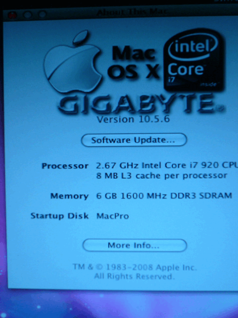

Yertil Posted March 1, 2009 Share Posted March 1, 2009 No reinstall is necessary if you have it going. How do you know your CPU is maxed out and why is it set at 3.8GHz? Are you reading the About This Mac setting? That wouldn't be correct (I think that was my old setting I put into the SystemInfo.string). Check the System Profiler/Hardware Overview/Processor Speed. That will give you the accurate speed. I don't think it would be running at 3.8 if you didn't set it that way. It should be running 2.67 stock. It it getting too hot? What are the temps (in BIOS) and what cooler do you have? How long does it take before shutting off? It it random? regards, MAJ the about this mac must be from your old setting because the bios read 2.66 the cpu temp is around 84 i have standard cpu cooler heat shrink plus my case has about 8 fans i a have the antec 1200 all running. I decided to try and test the power supply it was running fine but i bought another one any way just to be sure. of course i cant even get the computer to boot right know which is really starting to annoy me. i think i am at my wits end with this project of mine. ( i had thought it was a good idea i do have computer knowledge and have built some macs before) i think i will just sell it and save my money and get a real mac! I am going ot give it one more good night of trying i guess ok well i just figured it out my cpu is running between 100 and 113 celsius so that explains why its kicking off ? anybody have any suggestions on heat control ? Link to comment https://www.insanelymac.com/forum/topic/149505-guide-retail-os-x-install-1058-on-gigabyte-ga-ex58-ud5-core-i7-mobo/page/11/#findComment-1095477 Share on other sites More sharing options...

digital_dreamer Posted March 2, 2009 Author Share Posted March 2, 2009 the about this mac must be from your old setting because the bios read 2.66 the cpu temp is around 84 i have standard cpu cooler heat shrink plus my case has about 8 fans i a have the antec 1200 all running. I decided to try and test the power supply it was running fine but i bought another one any way just to be sure. of course i cant even get the computer to boot right know which is really starting to annoy me. i think i am at my wits end with this project of mine. ( i had thought it was a good idea i do have computer knowledge and have built some macs before) i think i will just sell it and save my money and get a real mac! I am going ot give it one more good night of trying i guess ok well i just figured it out my cpu is running between 100 and 113 celsius so that explains why its kicking off ? anybody have any suggestions on heat control ? That would be exactly why it's shutting off. Thermo limits built into the CPU and BIOS (if set). I think you need to reseat your CPU cooler immediately. Since you'll be removing it, you'll need to clean it all off with alcohol and reapply the thermal compound (Artic Silver or such). Make sure the thermal paste is applied properly - thin layer with razor blade. And, make sure the stock cooler is making good contact with the CPU. best of wishes, MAJ Link to comment https://www.insanelymac.com/forum/topic/149505-guide-retail-os-x-install-1058-on-gigabyte-ga-ex58-ud5-core-i7-mobo/page/11/#findComment-1095551 Share on other sites More sharing options...

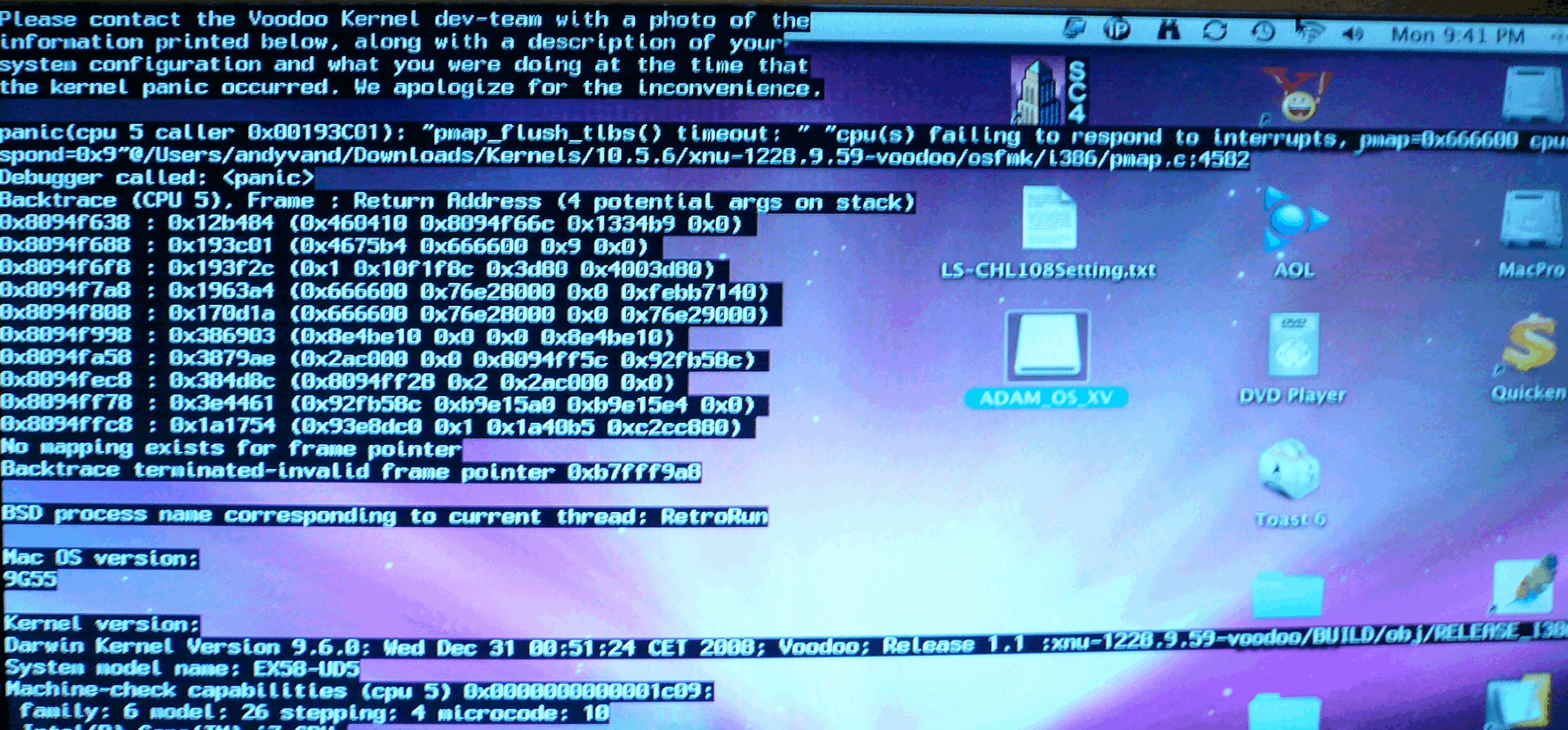

Yertil Posted March 2, 2009 Share Posted March 2, 2009 Maj, I got the computer running the temp is figured out i reloaded the software figuring it would solve the voodoo kernel problem i guess i was wrong! the machine is not very stable and i cant seem to get a clear shout of the kernel panic to show you. also once it has the panic with the os it takes me to hard resets to get the machine to boot back into the os. Any suggestions. How can i stabilize this machine, i used your program for the install i am running the ud5 mobo 9800gtx+ i used universal os86x to install correct info for this card Wd 1tb black caviar Dlink wifi card 6gb of ddr3 cosair and they are all showing up and the i7 920 of course i have not flashed the mobo or anything like it is stock out of box unless your software added something Help this week has been fun and torturous at the same time Link to comment https://www.insanelymac.com/forum/topic/149505-guide-retail-os-x-install-1058-on-gigabyte-ga-ex58-ud5-core-i7-mobo/page/11/#findComment-1096559 Share on other sites More sharing options...

Yertil Posted March 3, 2009 Share Posted March 3, 2009 this is actually what my computer keeps saying but i dont have anything running when it happens see pics of voodoo panic http://www.insanelymac.com/forum/index.php...505&st=120# can some one please tell me why Link to comment https://www.insanelymac.com/forum/topic/149505-guide-retail-os-x-install-1058-on-gigabyte-ga-ex58-ud5-core-i7-mobo/page/11/#findComment-1096699 Share on other sites More sharing options...
Yertil Posted March 3, 2009 Share Posted March 3, 2009 here are the pics from my computer i didnt change the memory or anything it was just there i also included a pic of the panic i get Where can i fing the firmware ver for mobo ? here is the panic Link to comment https://www.insanelymac.com/forum/topic/149505-guide-retail-os-x-install-1058-on-gigabyte-ga-ex58-ud5-core-i7-mobo/page/11/#findComment-1096719 Share on other sites More sharing options...
Yertil Posted March 3, 2009 Share Posted March 3, 2009 i am on bios f4 bios part number 7a89qg05 that is all i see hope it helps figuring this out Thanks in advance i am on bios f4 bios part number 7a89qg05 that is all i see hope it helps figuring this out Thanks in advance Link to comment https://www.insanelymac.com/forum/topic/149505-guide-retail-os-x-install-1058-on-gigabyte-ga-ex58-ud5-core-i7-mobo/page/11/#findComment-1096756 Share on other sites More sharing options...
digital_dreamer Posted March 3, 2009 Author Share Posted March 3, 2009 i am on bios f4 bios part number 7a89qg05 that is all i see hope it helps figuring this out Thanks in advance i am on bios f4 bios part number 7a89qg05 that is all i see hope it helps figuring this out Thanks in advance Yertil, At what point does this KP occur? Is it random or during any particular activity? What speed is your DDR3 RAM good for and what is the BIOS set for? regards, MAJ Link to comment https://www.insanelymac.com/forum/topic/149505-guide-retail-os-x-install-1058-on-gigabyte-ga-ex58-ud5-core-i7-mobo/page/11/#findComment-1096778 Share on other sites More sharing options...

mattrb Posted March 3, 2009 Share Posted March 3, 2009 Yertil,At what point does this KP occur? Is it random or during any particular activity? What speed is your DDR3 RAM good for and what is the BIOS set for? regards, MAJ Yea, is it happening when you are opening a dmg?? The only real difference between our systems is that I am running f3. I really don't know if this would make a difference though. What firmware are you running digital_dreamer? I am running f6a, because it fixes a nasty bootleg vista bug with the easytune and energy saver. Works like butter. Link to comment https://www.insanelymac.com/forum/topic/149505-guide-retail-os-x-install-1058-on-gigabyte-ga-ex58-ud5-core-i7-mobo/page/11/#findComment-1096807 Share on other sites More sharing options...
