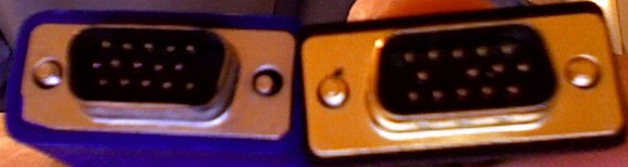

nebulOSX Posted December 30, 2008 Share Posted December 30, 2008 I can confirm that even on a fresh install, it still doesn't work and does the same thing as before EDIT: OK, something really strange, I have tried with a different monitor and it works?! my main monitor clearly has something wrong... OK, am i being paranoid? I have looked at the cable from my old 1024x768 monitor (which works!) compared to the cable with my newer larger monitor and i notice a pin is missing on the new monitor cable? Look at picture below, the cable from new monitor is on the right.. I would change the cables round but the older one has the cable embedded in. EDIT 2:Just googled some images and seems that almost all of them have that pin missing... I think its a slightly dodgy monitor as the correct 1440x900 res isn't picked up on my macbook have to use switchresx to change it, anyone know a fix? Link to comment https://www.insanelymac.com/forum/topic/143340-final-solution-fix-for-gma950-desktop-edition-new-28-dec-08/page/3/#findComment-1020378 Share on other sites More sharing options...
