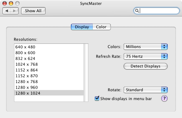

Istivi Jobis Posted December 29, 2008 Share Posted December 29, 2008 Here, with GA-945GM-S2 / 10.5.6, sleep ok, restart no, rotate standard return only after new boot. Link to comment https://www.insanelymac.com/forum/topic/143340-final-solution-fix-for-gma950-desktop-edition-new-28-dec-08/page/2/#findComment-1018174 Share on other sites More sharing options...

Dr. Hurt Posted December 29, 2008 Author Share Posted December 29, 2008 Here, with GA-945GM-S2 / 10.5.6, sleep ok, restart no, rotate standard return only after new boot. Finally someone tested. Congratulations. Now you can update os x without having to worry about graphics. OK, for restart make sure you have openhaltrestart.kext installed. Otherwise, it's a DSDT issue. Rotate did the same thing with me. Need reboot to get back to standard - no problem though. Is everything else working properly? Did you get any artifacts? Link to comment https://www.insanelymac.com/forum/topic/143340-final-solution-fix-for-gma950-desktop-edition-new-28-dec-08/page/2/#findComment-1018185 Share on other sites More sharing options...

Istivi Jobis Posted December 29, 2008 Share Posted December 29, 2008 Well, openhaltrestart.kext installed, restart ok. Untill now, everything working, none artifacts. If any problem, I will post. Thanks ! Link to comment https://www.insanelymac.com/forum/topic/143340-final-solution-fix-for-gma950-desktop-edition-new-28-dec-08/page/2/#findComment-1018285 Share on other sites More sharing options...

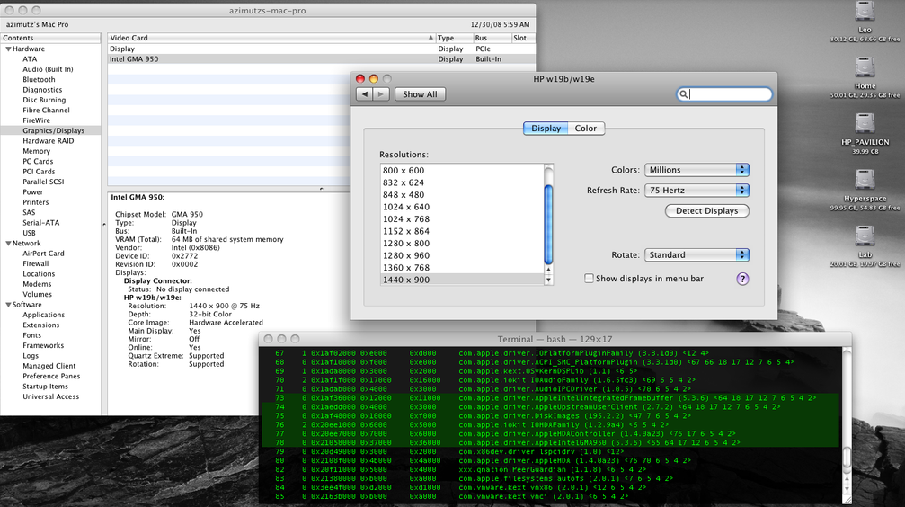

Azimutz Posted December 29, 2008 Share Posted December 29, 2008 Hello. Think this thread is misplaced..?! Shouldn't it be under OSx86?.. almost missed it EDIT: was misplaced. Anyway.. i'd like to test this but, i have two doubts. -The kexts in the zip, are they patched or plain stock kexts? -My mobo is an Asus, though it's made for HP. Will this work with my mobo or do i have to patch my dsdt.aml? Device id is: 2772 I'm not using DSDT.. still didn't found a real good reason to use it. This would be a real good reason! I must say that i have out of the box support for GMA950, except for resolution change. For that i use "AppleIntelIntegratedFramebuffer 1.4.20.28" patched, i think. I get some artifacts with some apps. It would be nice to use stock kexts Thanks Link to comment https://www.insanelymac.com/forum/topic/143340-final-solution-fix-for-gma950-desktop-edition-new-28-dec-08/page/2/#findComment-1018454 Share on other sites More sharing options...

Dr. Hurt Posted December 29, 2008 Author Share Posted December 29, 2008 Hello. Think this thread is misplaced..?! Shouldn't it be under OSx86?.. almost missed it Anyway.. i'd like to test this but, i have two doubts. -The kexts in the zip, are they patched or plain stock kexts? -My mobo is an Asus, though it's made for HP. Will this work with my mobo or do i have to patch my dsdt.aml? Device id is: 2772 I'm not using DSDT.. still didn't found a real good reason to use it. This would be a real good reason! I must say that i have out of the box support for GMA950, except for resolution change. For that i use "AppleIntelIntegratedFramebuffer 1.4.20.28" patched, i think. I get some artifacts with some apps. It would be nice to use stock kexts Thanks The kexts are the stock (unmodified) ones from the 10.5.6 update. This DSDT patch is confirmed to work on gigabyte boards. No one tested it with other boards yet. If you would like to test it, that will be really appreciated. If it doesn't work, you'll probably have to patch it manually or wait till someone writes an automated patcher. Just make sure your bootloader supports DSDT. Yes, this thread is misplaced!! Link to comment https://www.insanelymac.com/forum/topic/143340-final-solution-fix-for-gma950-desktop-edition-new-28-dec-08/page/2/#findComment-1018561 Share on other sites More sharing options...

Azimutz Posted December 30, 2008 Share Posted December 30, 2008 I can confirm to First have to thank roisof for his fast and helpful response. Without his help, i wouldn't be posting so soon! Thanks mate. Rotation here works without reboot. A nice performance boost, no artifacts.. still have to test with really problematic apps, but i feel confident. The kexts are the stock (unmodified) ones from the 10.5.6 update.This DSDT patch is confirmed to work on gigabyte boards. No one tested it with other boards yet. If you would like to test it, that will be really appreciated. If it doesn't work, you'll probably have to patch it manually or wait till someone writes an automated patcher. Just make sure your bootloader supports DSDT. Yes, this thread is misplaced!! Thank you so much for posting this! I only saw it by chance, cause it was the most recent posted at the time and i looked further down than usual. Anyway.. glad i saw it! Mate, i tested your .aml and graphics worked. Other divices don't match my mobo but, graphics do match!! The one i'm using was made from the dsdt of my pc, by roisoft.. Hope this helps.. i don't mind doind more testing but, at the time i'm too busy with INSTAHackintosh. Pm me if you need anything.. Big thanks Link to comment https://www.insanelymac.com/forum/topic/143340-final-solution-fix-for-gma950-desktop-edition-new-28-dec-08/page/2/#findComment-1019384 Share on other sites More sharing options...
Dr. Hurt Posted December 30, 2008 Author Share Posted December 30, 2008 Cool!! So my DSDT.aml also worked with an ASUS motherboard?! Other devices didn't even match in my system, so it won't cause any problems for anyone, It's just extra obsolete code - as netkas pointed out. I'll try to clean up the code if I have time. I'd better update the first post again. Thank you, Azimutz. Link to comment https://www.insanelymac.com/forum/topic/143340-final-solution-fix-for-gma950-desktop-edition-new-28-dec-08/page/2/#findComment-1019398 Share on other sites More sharing options...
