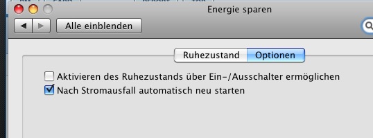

chrS Posted April 14, 2009 Share Posted April 14, 2009 Even with good dsdt.aml sleep maybe a problem !!!Since Chameleon V12 my sleep didnt work on EP-EP35-DS3 it always reboots insted of waking up. So i think dsdt patch isnt the problem or the solution. Sorry if this is a stupid question, but do you have "Restart after power failure" enabled in Preferences / Energy Saver? If not try it. Link to comment https://www.insanelymac.com/forum/topic/142434-acpi-dsdt-patcher-for-bios-and-aml/page/22/#findComment-1132910 Share on other sites More sharing options...
mitch_de Posted April 14, 2009 Share Posted April 14, 2009 I will try that, thanks. Will report result. That option named a bit ?? for an solution but i give a try. GREAT: That option helped ! No wakeup works and ends not in an reboot . Thanks !!! Link to comment https://www.insanelymac.com/forum/topic/142434-acpi-dsdt-patcher-for-bios-and-aml/page/22/#findComment-1132965 Share on other sites More sharing options...

mitch_de Posted April 15, 2009 Share Posted April 15, 2009 I don't have that option Thats that Option "On power lost ..." , its in the Engery Saver Systempreferences, then TAB Options. Link to comment https://www.insanelymac.com/forum/topic/142434-acpi-dsdt-patcher-for-bios-and-aml/page/22/#findComment-1133191 Share on other sites More sharing options...

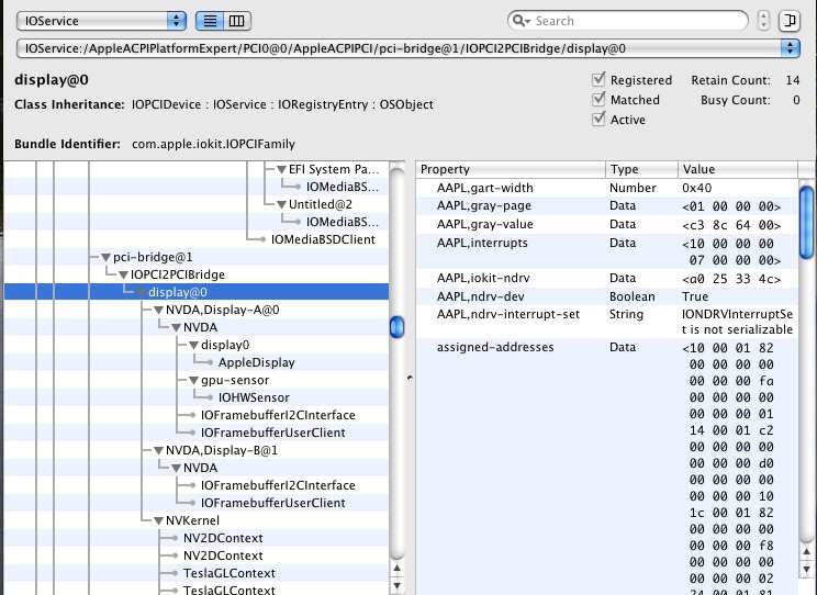

DukeRaoul Posted April 15, 2009 Share Posted April 15, 2009 Need a little help - anyone? I have a strange thing showing for the location of my GFX card in IOregistryExplorer. What should I choose for the location of my Nvidia card? PCI 0, PCI 1, or something else? (see pic) I see the location where other people's card address could be found as showing "pci-bridge@1" - what is that? Any info appreciated! Link to comment https://www.insanelymac.com/forum/topic/142434-acpi-dsdt-patcher-for-bios-and-aml/page/22/#findComment-1133631 Share on other sites More sharing options...

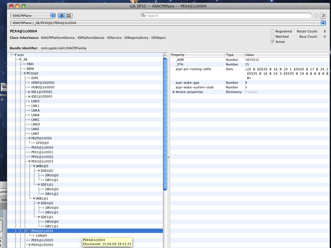

mitch_de Posted April 15, 2009 Share Posted April 15, 2009 Need a little help - anyone? I have a strange thing showing for the location of my GFX card in IOregistryExplorer. What should I choose for the location of my Nvidia card? PCI 0, PCI 1, or something else? (see pic) I see the location where other people's card address could be found as showing "pci-bridge@1" - what is that? Any info appreciated! Use the output of IOACPIPlane selection insted of IOService to see the name of device you use for the dsdt patcher (PEX#, PCI#, PEGP,...). For example PEX4 is my LAN, PEGP my GPU. Link to comment https://www.insanelymac.com/forum/topic/142434-acpi-dsdt-patcher-for-bios-and-aml/page/22/#findComment-1133736 Share on other sites More sharing options...
crazybyte Posted April 15, 2009 Share Posted April 15, 2009 THANKS!!! You solved my finding the id trouble Link to comment https://www.insanelymac.com/forum/topic/142434-acpi-dsdt-patcher-for-bios-and-aml/page/22/#findComment-1133740 Share on other sites More sharing options...
Cyberdog ! Posted April 15, 2009 Share Posted April 15, 2009 Use the output of IOACPIPlane selection insted of IOService to see the name of device you use for the dsdt patcher (PEX#, PCI#, PEGP,...). For example PEX4 is my LAN, PEGP my GPU. cool !! Link to comment https://www.insanelymac.com/forum/topic/142434-acpi-dsdt-patcher-for-bios-and-aml/page/22/#findComment-1133742 Share on other sites More sharing options...
DukeRaoul Posted April 15, 2009 Share Posted April 15, 2009 Use the output of IOACPIPlane selection insted of IOService to see the name of device you use for the dsdt patcher (PEX#, PCI#, PEGP,...). For example PEX4 is my LAN, PEGP my GPU. Thanks, but that still doesn't help me find mine - the Nvidia card doesn't show up anywhere in IOACPIPlane output. The ethernet and audio hardware shows up ok, but the graphics card is nowhere. What I do see is the root of all the devices at PCI0@0, and there's no PCI 1, 2, 3 or any other. There are PEX 0 - 5 listed, but only Ethernet is under one of those. Is my graphics card more likely to be one of the PEX listings or just PCI 0? I believe I have tried PCI 0 and it didn't work. Link to comment https://www.insanelymac.com/forum/topic/142434-acpi-dsdt-patcher-for-bios-and-aml/page/22/#findComment-1134040 Share on other sites More sharing options...
