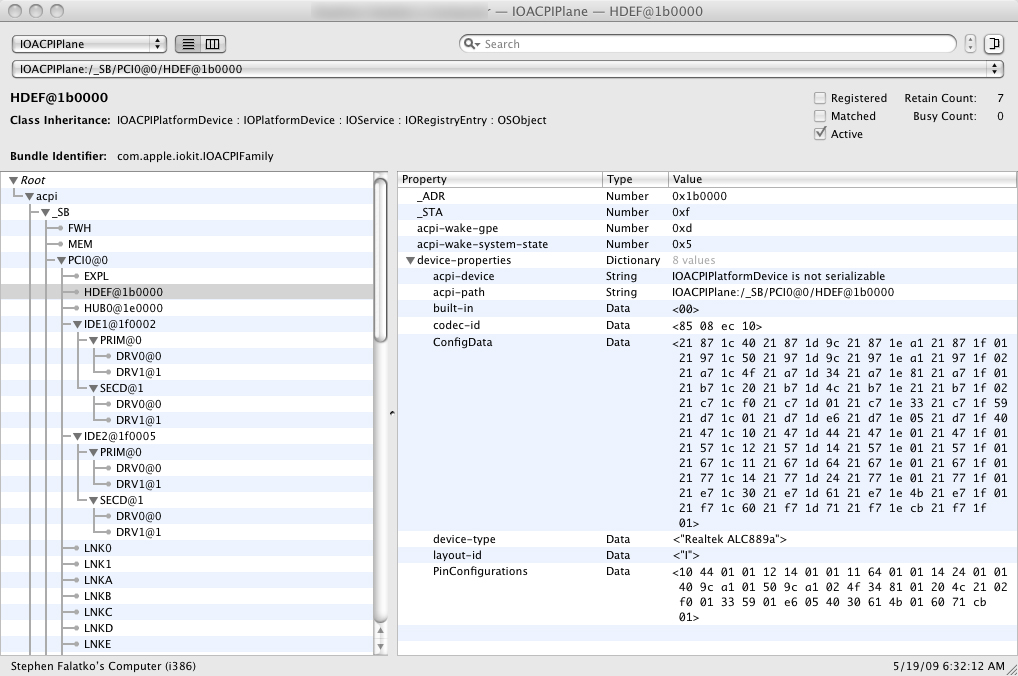

SMF Posted May 19, 2009 Share Posted May 19, 2009 kizwan, Thanks - somehow I was messing up my hex conversions.... I'm poking at it again with 10.5.7 and I noticed that the value for layout id is not being reported with the same value I set it in DSDT. The pinconfigs and config data are though. Anyone else notice this? Here's my dsdt data - Device (HDEF) { Name (_ADR, 0x001B0000) Method (_PRW, 0, NotSerialized) { Return (Package (0x02) { 0x0D, 0x05 }) } Method (_DSM, 4, NotSerialized) { Store (Package (0x0C) { "built-in", Buffer (One) { 0x00 }, "codec-id", Buffer (0x04) { 0x85, 0x08, 0xEC, 0x10 }, "ConfigData", Buffer (0xC0) { /* 0000 */ 0x21, 0x87, 0x1c, 0x40, 0x21, 0x87, 0x1d, 0x9c, /* 0008 */ 0x21, 0x87, 0x1e, 0xa1, 0x21, 0x87, 0x1f, 0x01, /* 0010 */ 0x21, 0x97, 0x1c, 0x50, 0x21, 0x97, 0x1d, 0x9c, /* 0018 */ 0x21, 0x97, 0x1e, 0xa1, 0x21, 0x97, 0x1f, 0x02, /* 0020 */ 0x21, 0xa7, 0x1c, 0x4f, 0x21, 0xa7, 0x1d, 0x34, /* 0028 */ 0x21, 0xa7, 0x1e, 0x81, 0x21, 0xa7, 0x1f, 0x01, /* 0030 */ 0x21, 0xb7, 0x1c, 0x20, 0x21, 0xb7, 0x1d, 0x4c, /* 0038 */ 0x21, 0xb7, 0x1e, 0x21, 0x21, 0xb7, 0x1f, 0x02, /* 0040 */ 0x21, 0xc7, 0x1c, 0xf0, 0x21, 0xc7, 0x1d, 0x01, /* 0048 */ 0x21, 0xc7, 0x1e, 0x33, 0x21, 0xc7, 0x1f, 0x59, /* 0050 */ 0x21, 0xd7, 0x1c, 0x01, 0x21, 0xd7, 0x1d, 0xe6, /* 0058 */ 0x21, 0xd7, 0x1e, 0x05, 0x21, 0xd7, 0x1f, 0x40, /* 0060 */ 0x21, 0x47, 0x1c, 0x10, 0x21, 0x47, 0x1d, 0x44, /* 0068 */ 0x21, 0x47, 0x1e, 0x01, 0x21, 0x47, 0x1f, 0x01, /* 0070 */ 0x21, 0x57, 0x1c, 0x12, 0x21, 0x57, 0x1d, 0x14, /* 0078 */ 0x21, 0x57, 0x1e, 0x01, 0x21, 0x57, 0x1f, 0x01, /* 0080 */ 0x21, 0x67, 0x1c, 0x11, 0x21, 0x67, 0x1d, 0x64, /* 0088 */ 0x21, 0x67, 0x1e, 0x01, 0x21, 0x67, 0x1f, 0x01, /* 0090 */ 0x21, 0x77, 0x1c, 0x14, 0x21, 0x77, 0x1d, 0x24, /* 0098 */ 0x21, 0x77, 0x1e, 0x01, 0x21, 0x77, 0x1f, 0x01, /* 0100 */ 0x21, 0xe7, 0x1c, 0x30, 0x21, 0xe7, 0x1d, 0x61, /* 0108 */ 0x21, 0xe7, 0x1e, 0x4b, 0x21, 0xe7, 0x1f, 0x01, /* 0110 */ 0x21, 0xf7, 0x1c, 0x60, 0x21, 0xf7, 0x1d, 0x71, /* 0118 */ 0x21, 0xf7, 0x1e, 0xcb, 0x21, 0xf7, 0x1f, 0x01 }, "layout-id", Buffer (0x04) { 0x49, 0x00, 0x00, 0x00 }, "device-type", Buffer (0x10) { "Realtek ALC889a" }, "PinConfigurations", Buffer (0x30) { /* 0000 */ 0x10, 0x44, 0x01, 0x01, 0x12, 0x14, 0x01, 0x01, /* 0008 */ 0x11, 0x64, 0x01, 0x01, 0x14, 0x24, 0x01, 0x01, /* 0010 */ 0x40, 0x9c, 0xa1, 0x01, 0x50, 0x9c, 0xa1, 0x02, /* 0018 */ 0x4f, 0x34, 0x81, 0x01, 0x20, 0x4c, 0x21, 0x02, /* 0020 */ 0xf0, 0x01, 0x33, 0x59, 0x01, 0xe6, 0x05, 0x40, /* 0028 */ 0x30, 0x61, 0x4b, 0x01, 0x60, 0x71, 0xcb, 0x01 } }, Local0) DTGP (Arg0, Arg1, Arg2, Arg3, RefOf (Local0)) Return (Local0) } } and here's a snap of my ioregistryexplorer where layout id seems to be showing lower case L not 73 (decimal) or x49 (hex) Link to comment https://www.insanelymac.com/forum/topic/142434-acpi-dsdt-patcher-for-bios-and-aml/page/25/#findComment-1159774 Share on other sites More sharing options...
mitch_de Posted May 19, 2009 Share Posted May 19, 2009 kizwan, Thanks - somehow I was messing up my hex conversions.... I'm poking at it again with 10.5.7 and I noticed that the value for layout id is not being reported with the same value I set it in DSDT. The pinconfigs and config data are though. Anyone else notice this? and here's a snap of my ioregistryexplorer where layout id seems to be showing lower case L not 73 (decimal) or x49 (hex) I can see perhaps some little mistake: "device-type", Buffer (0x10) { "Realtek ALC889a" }, Buffer length = 10hex Bytes = 16 dez Realtek ALC889a itself is only 15 Bytes (dez) = 0Fhex Perhaps thats the problem ? Link to comment https://www.insanelymac.com/forum/topic/142434-acpi-dsdt-patcher-for-bios-and-aml/page/25/#findComment-1159983 Share on other sites More sharing options...

SMF Posted May 19, 2009 Share Posted May 19, 2009 I can see perhaps some little mistake:"device-type", Buffer (0x10) { "Realtek ALC889a" }, Buffer length = 10hex Bytes = 16 dez Realtek ALC889a itself is only 15 Bytes (dez) = 0Fhex Perhaps thats the problem ? kizwan, Well - I fixed the hex value to x0F but have the same lower case L listed as layout id. It would appear something about DSDT injection isn't working correctly. Thanks, SMF Link to comment https://www.insanelymac.com/forum/topic/142434-acpi-dsdt-patcher-for-bios-and-aml/page/25/#findComment-1160355 Share on other sites More sharing options...
kizwan Posted May 20, 2009 Share Posted May 20, 2009 kizwan, Well - I fixed the hex value to x0F but have the same lower case L listed as layout id. It would appear something about DSDT injection isn't working correctly. Thanks, SMF SMF, the suggestion was came from mitch_de not me. I don't know why layout id appeared like that. It not happen to me. I don't think miscalculation of "device-type" was the cause of your problem because it don't cause me any problem. This is my dsdt:- Method (_DSM, 4, NotSerialized) { Store (Package (0x0C) { "built-in", Buffer (One) { 0x00 }, "codec-id", Buffer (0x04) { 0x83, 0x08, 0xEC, 0x10 }, "ConfigData", Buffer (0x40) { /* 0000 */ 0x01, 0x47, 0x1C, 0x30, 0x01, 0x47, 0x1D, 0x11, /* 0008 */ 0x01, 0x47, 0x1E, 0x0B, 0x01, 0x47, 0x1F, 0x01, /* 0010 */ 0x01, 0x87, 0x1C, 0x10, 0x01, 0x87, 0x1D, 0x91, /* 0018 */ 0x01, 0x87, 0x1E, 0xAB, 0x01, 0x87, 0x1F, 0x01, /* 0020 */ 0x01, 0xA7, 0x1C, 0x20, 0x01, 0xA7, 0x1D, 0x31, /* 0028 */ 0x01, 0xA7, 0x1E, 0x81, 0x01, 0xA7, 0x1F, 0x01, /* 0030 */ 0x01, 0xE7, 0x1C, 0x40, 0x01, 0xE7, 0x1D, 0xE1, /* 0038 */ 0x01, 0xE7, 0x1E, 0x45, 0x01, 0xE7, 0x1F, 0x01 }, "layout-id", Buffer (0x04) { 0x0C, 0x00, 0x00, 0x00 }, "device-type", Buffer (0x11) { "Mobile ALC883 S/T" }, "PinConfigurations", Buffer (0x10) { /* 0000 */ 0x30, 0x11, 0x0B, 0x01, 0x10, 0x91, 0xAB, 0x01, /* 0008 */ 0x20, 0x31, 0x81, 0x01, 0x40, 0xE1, 0x45, 0x01 } }, Local0) DTGP (Arg0, Arg1, Arg2, Arg3, RefOf (Local0)) Return (Local0) } kizwan Link to comment https://www.insanelymac.com/forum/topic/142434-acpi-dsdt-patcher-for-bios-and-aml/page/25/#findComment-1160375 Share on other sites More sharing options...
SMF Posted May 20, 2009 Share Posted May 20, 2009 kizwan, Well - I fixed the hex value to x0F but have the same lower case L listed as layout id. It would appear something about DSDT injection isn't working correctly. Thanks, SMF As an update I changed the layout id to 63 (decimal) - x3F and it worked. Not sure why but ioregistryexplorer now reports 3F as the layout id. Unfortunately, as others have commented, I get sound out of the line out port but there is only on output and two inputs reported in system preferences. SMF Link to comment https://www.insanelymac.com/forum/topic/142434-acpi-dsdt-patcher-for-bios-and-aml/page/25/#findComment-1160799 Share on other sites More sharing options...
