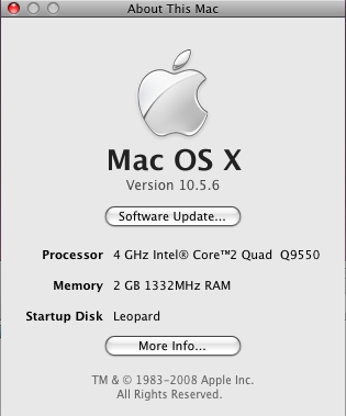

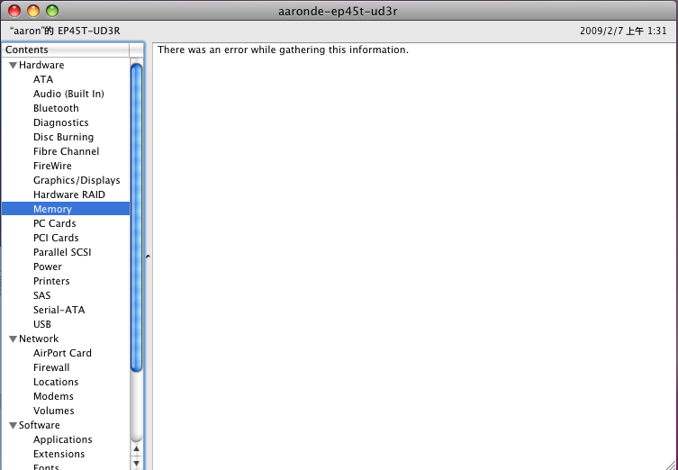

carls Posted February 6, 2009 Share Posted February 6, 2009 I had surfed all the posts about EP45 and I found Eliade's tutorial is easy and stable So according to Eliade's tutorial and I success install 10.5.6. Everything is all right but I got a problem is I couldn't get the correct memory and CPU information. Mine spec is GIGABYTE EP45T-UD3R (it's support DDR3) , 2.83 GHz Intel Core 2 Quad 9550 , and GeForce 9600 GT. But About This Mac show 2GB 1333 MHz RAM and 4GHz Intel Core 2 Quad Q9550 . Does anyone have the same problem in your EP45-UD3R/EP45T-UD3R? Thanks for your reading. My HOW TO My system is super stable, just waiting for JMicronATA to crash (still didn't since I turned off "Sleep HD when possible" option) Bios is using optimised default, except for AHCI on SATA (2 places where you need to change that on the same BIOS page) boot 132 install, GUID partition type (instead of MBR) I use Chameleon 1.0.12 aka PCEFIv9 to boot from HD, it super easy to install... here it is: Bootloader_efiv9_chameleon_1.0.12.pkg.zip I have a local ethernet static IP setup, handy for me on my network (for a small Mac OS only 3D renderfarm) I don't know if that does anything good, at least it does not do anything wrong get the kext post 54, use all of them except replace AppleHDA (for sound) and my JMicronATA (for IDE drives) with the one on the first post by slx and search for OpenHaltRestart.kext for full system shutdown (sleep and reboot works without it) EDIT: you can download all these extensions in one pack here: Extensions_GA_EP45_UD3R.zip install them all in S/L/E (backup the original before doing that, it might come in handy later), I use kext Helper for that here is kext helper: Kext_Helper_b7.app.zip I use UIinstaller, to add EFI string for ethernet and video card (if you have more than one HD double check that the OSX drive is the one selected on top, by default it might not ....) here it is Uinstaller: Add_EFI_String.zip in System Pref / Energy Saver, disable "sleep HD when possible", I suspect its the reason why my system crashed when using JMicronATA voila The only known issue, is if a usb flash drive or usb HD is connected and you sleep the computer, when you wake up the computer, they will disconnect and reconnect for 1sec, and you get the "Device Removal" Warning ... therefore I don't sleep my system when I have usb flash or HD connected ... JMicronATA, so far it is stable as long as sleep HD is disabled ... time will tell everything else works did you add efi string for your video card if you didn't you may use Uinstaller to add the string I never really check if it would work without the EFI string, but adding it doesn't harm anything So the only "major" difference with our setup might be the EFI string for ethernet if you didn't then use Uinstaller just for the EFI string, don't check any other option... if you did add the EFI string then I don't know Link to comment https://www.insanelymac.com/forum/topic/141769-new-install-gigabyte-ga-ep45-ud3r/page/7/#findComment-1071684 Share on other sites More sharing options...

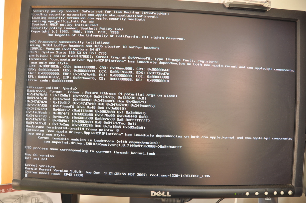

Squirrelf Posted February 8, 2009 Share Posted February 8, 2009 First and foremost, thank you for all your work with this motherboard. I get a kernel panic at AppleACPIPlatform (I think) when I try to load off the retail DVD (after booting off of your iso). Any ideas of why that might be? try that GA_EP45_UD3R___boot132.iso.zip Link to comment https://www.insanelymac.com/forum/topic/141769-new-install-gigabyte-ga-ep45-ud3r/page/7/#findComment-1073783 Share on other sites More sharing options...

garmone Posted February 8, 2009 Share Posted February 8, 2009 try thatGA_EP45_UD3R___boot132.iso.zip I'm starting to think it's me... I tried making an iso using files provided by WinstonAce on post #67 from this discussion link and got the same kernel panic. At this point I'm not sure how best to proceed. I'm vaguely aware of this alternative retail method in which you install something like kalyway on another disk, and then install to the desired destination from there. Does anyone have step-by-step instructions for that approach? Thank you Edit Is there anything special you need to do in the BIOS other than switch the Integrated Peripherals to AHCI in both places? Link to comment https://www.insanelymac.com/forum/topic/141769-new-install-gigabyte-ga-ep45-ud3r/page/7/#findComment-1074107 Share on other sites More sharing options...
Squirrelf Posted February 9, 2009 Share Posted February 9, 2009 I'm starting to think it's me... I tried making an iso using files provided by WinstonAce on post #67 from this discussion link and got the same kernel panic. At this point I'm not sure how best to proceed. I'm vaguely aware of this alternative retail method in which you install something like kalyway on another disk, and then install to the desired destination from there. Does anyone have step-by-step instructions for that approach? Thank you Edit Is there anything special you need to do in the BIOS other than switch the Integrated Peripherals to AHCI in both places? with optimized default in the bios besides the two AHCI no there's nothing else to change so there are two things : try to burn OSX DVD again and/or try to get another DVD drive at least temporarily ... preferably sata... have you tried grub-dfe,iso as a boot 132 my boot132 at least worked when OSX dvd is "extracted" (actually restored using mac os disk utility) onto a usb hard drive partition... and then use my boot 132 to boot onto that partition (I don't have dual layer DVD ... ) so if you have a mac or if you can temporarily install kaliway you may want to try the restore disk like I did on a usb hard drive or a usb flash drive that has at least 9GB if you do a restore disk you'll have to convert the iso into a dmg (using "disk utility" bundled with mac os) , then do a "image / scan image for restore" then do the restore... ... Link to comment https://www.insanelymac.com/forum/topic/141769-new-install-gigabyte-ga-ep45-ud3r/page/7/#findComment-1074391 Share on other sites More sharing options...
