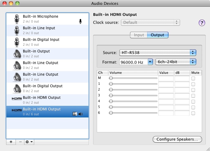

zzebulonn Posted August 21, 2010 Share Posted August 21, 2010 GT220 10DE:B0E2GT240 10DE:B0E4 They are in HDAController binary so that I don't have to patch for them. I got it. Thanks. Did you try to patch 10DE:B0E2 with 10DE:0BE5? Yes all of them but see my last post it works (with be4 -> be5) ! but only on first HDMI under windows there is 3 codec exposed and i think i need to change something to output on port 2 or 3... My last problem was the audio distorted (it works with idlehalt=0 but CPU get very hot..) so if you known what is doing this (MB: X58A-UD7) i will be happy Thanks! Link to comment https://www.insanelymac.com/forum/topic/140941-alc889a-gigabyte-intel-now-having-a-working-front-mic/page/36/#findComment-1534178 Share on other sites More sharing options...
VCH888 Posted August 21, 2010 Author Share Posted August 21, 2010 Yes all of them but see my last post it works (with be4 -> be5) ! but only on first HDMI under windows there is 3 codec exposed and i think i need to change something to output on port 2 or 3...My last problem was the audio distorted (it works with idlehalt=0 but CPU get very hot..) so if you known what is doing this (MB: X58A-UD7) i will be happy Thanks! Sorry, I have no idea how to solve this problem. Do you have Windows? If have it, did you get the distortion of audio? .....Looking at the IORegistryExplorer of the newer MacBookPro6,1, I discovered there's some important clues going on with the AppleHDAController kext. The MacBookPro6,1 uses the GT330M (device id 0AC0) with the device id 0BE2 for the Nvidia HDMI audio, same Nvidia HDMI id as mine, that's why I did not get any HDMI audio device id errors. The device id 0BE2 is in the AppleHDAController binary. The AppleHDAController plist lists 4 times Apple's GT330M device id 0x0ac010de (decimal 282987200) under CodecAdressFilterArray. I replaced those 4 mentions of the GT330M by my GT240M device id 0x0a3410de (decimal 282987060). That did not work, still got the hdaGfxCandidate error. It's only when I replaced the line IOPCIClassMatch by IOPCIPrimaryMatch, 0x0be210de in the AppleHDAController plist that it finally worked and got not more hdaGfxCandidate errors. .... Did you try to patch 0x10de0ac0 (DE 10 C0 0A) with your 0x10de0a34 (DE 10 34 0A) in AppleHDAController binary? And, let IOPCIClassMatch to be as default. Or, you may try to add HD Audio Controller ID of sound on board in IOPCIPrimaryMatch. Link to comment https://www.insanelymac.com/forum/topic/140941-alc889a-gigabyte-intel-now-having-a-working-front-mic/page/36/#findComment-1534216 Share on other sites More sharing options...

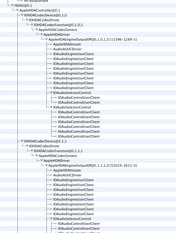

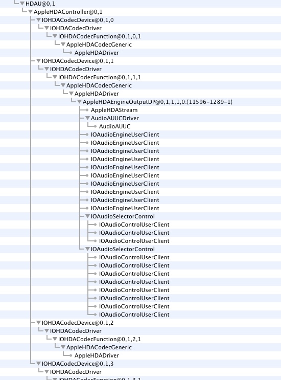

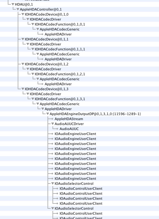

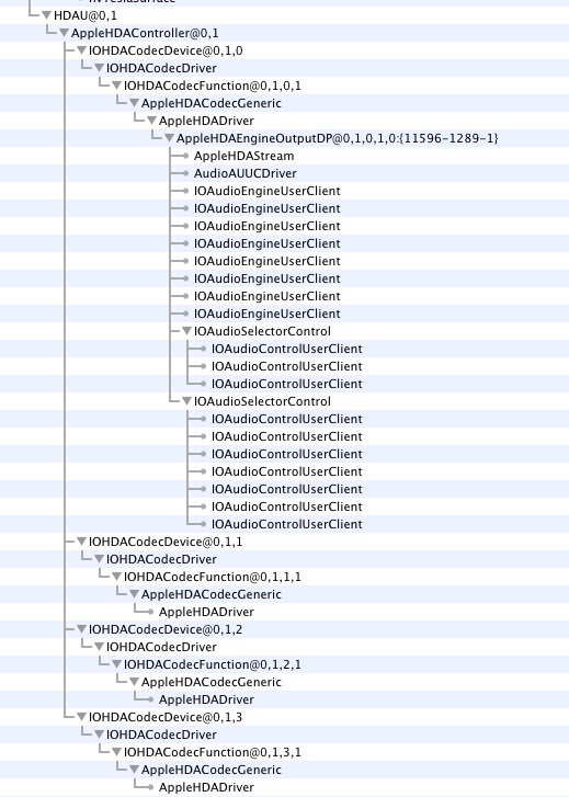

zzebulonn Posted August 24, 2010 Share Posted August 24, 2010 Sorry, I have no idea how to solve this problem. Do you have Windows? If have it, did you get the distortion of audio? Yes that works. I think it's related to C state too low, nothing related to that. I've got a codec capture under linux for the GTX480 below, there is 4 section with the same codec ID and a different address field, does you known how to map the Address to a layout / pathmap or other things ?? Codec: Nvidia ID 10 Address: 0 Function Id: 0x1 Vendor Id: 0x10de0010 Subsystem Id: 0x10de0101 Revision Id: 0x100100 No Modem Function Group found Default PCM: rates [0x0]: bits [0x0]: formats [0x0]: Default Amp-In caps: N/A Default Amp-Out caps: N/A GPIO: io=0, o=0, i=0, unsolicited=0, wake=0 Node 0x04 [Audio Output] wcaps 0x72b1: 8-Channels Digital Stripe CP Converter: stream=0, channel=0 Digital: Digital category: 0x0 PCM: rates [0x7f0]: 32000 44100 48000 88200 96000 176400 192000 bits [0xe]: 16 20 24 formats [0x5]: PCM AC3 Unsolicited: tag=00, enabled=0 Node 0x05 [Pin Complex] wcaps 0x407381: 8-Channels Digital CP Pincap 0x09000094: OUT Detect HBR HDMI DP Pin Default 0x18560010: [Jack] Digital Out at Int HDMI Conn = Digital, Color = Unknown DefAssociation = 0x1, Sequence = 0x0 Pin-ctls: 0x00: Unsolicited: tag=00, enabled=0 Connection: 1 0x04 Codec: Nvidia ID 10 Address: 1 Function Id: 0x1 Vendor Id: 0x10de0010 Subsystem Id: 0x10de0101 Revision Id: 0x100100 No Modem Function Group found Default PCM: rates [0x0]: bits [0x0]: formats [0x0]: Default Amp-In caps: N/A Default Amp-Out caps: N/A GPIO: io=0, o=0, i=0, unsolicited=0, wake=0 Node 0x04 [Audio Output] wcaps 0x72b1: 8-Channels Digital Stripe CP Converter: stream=0, channel=0 Digital: Digital category: 0x0 PCM: rates [0x7f0]: 32000 44100 48000 88200 96000 176400 192000 bits [0xe]: 16 20 24 formats [0x5]: PCM AC3 Unsolicited: tag=00, enabled=0 Node 0x05 [Pin Complex] wcaps 0x407381: 8-Channels Digital CP Pincap 0x09000094: OUT Detect HBR HDMI DP Pin Default 0x18560010: [Jack] Digital Out at Int HDMI Conn = Digital, Color = Unknown DefAssociation = 0x1, Sequence = 0x0 Pin-ctls: 0x00: Unsolicited: tag=00, enabled=0 Connection: 1 0x04 Codec: Nvidia ID 10 Address: 2 Function Id: 0x1 Vendor Id: 0x10de0010 Subsystem Id: 0x10de0101 Revision Id: 0x100100 No Modem Function Group found Default PCM: rates [0x0]: bits [0x0]: formats [0x0]: Default Amp-In caps: N/A Default Amp-Out caps: N/A GPIO: io=0, o=0, i=0, unsolicited=0, wake=0 Node 0x04 [Audio Output] wcaps 0x72b1: 8-Channels Digital Stripe CP Converter: stream=0, channel=0 Digital: Digital category: 0x0 PCM: rates [0x7f0]: 32000 44100 48000 88200 96000 176400 192000 bits [0xe]: 16 20 24 formats [0x5]: PCM AC3 Unsolicited: tag=00, enabled=0 Node 0x05 [Pin Complex] wcaps 0x407381: 8-Channels Digital CP Pincap 0x09000094: OUT Detect HBR HDMI DP Pin Default 0x18560010: [Jack] Digital Out at Int HDMI Conn = Digital, Color = Unknown DefAssociation = 0x1, Sequence = 0x0 Pin-ctls: 0x00: Unsolicited: tag=00, enabled=0 Connection: 1 0x04 Codec: Nvidia ID 10 Address: 3 Function Id: 0x1 Vendor Id: 0x10de0010 Subsystem Id: 0x10de0101 Revision Id: 0x100100 No Modem Function Group found Default PCM: rates [0x0]: bits [0x0]: formats [0x0]: Default Amp-In caps: N/A Default Amp-Out caps: N/A GPIO: io=0, o=0, i=0, unsolicited=0, wake=0 Node 0x04 [Audio Output] wcaps 0x72b1: 8-Channels Digital Stripe CP Converter: stream=0, channel=0 Digital: Digital category: 0x0 PCM: rates [0x7f0]: 32000 44100 48000 88200 96000 176400 192000 bits [0xe]: 16 20 24 formats [0x5]: PCM AC3 Unsolicited: tag=00, enabled=0 Node 0x05 [Pin Complex] wcaps 0x407381: 8-Channels Digital CP Pincap 0x09000094: OUT Detect HBR HDMI DP Pin Default 0x18560010: [Jack] Digital Out at Int HDMI Conn = Digital, Color = Unknown DefAssociation = 0x1, Sequence = 0x0 Pin-ctls: 0x00: Unsolicited: tag=00, enabled=0 Connection: 1 0x04 Link to comment https://www.insanelymac.com/forum/topic/140941-alc889a-gigabyte-intel-now-having-a-working-front-mic/page/36/#findComment-1536489 Share on other sites More sharing options...
VCH888 Posted August 25, 2010 Author Share Posted August 25, 2010 Yes that works. I think it's related to C state too low, nothing related to that. I've got a codec capture under linux for the GTX480 below, there is 4 section with the same codec ID and a different address field, does you known how to map the Address to a layout / pathmap or other things ?? ........ Please see pictures and I hope you will get it. I think a new macmini has four addresses too. Under Windows, you will have four HDMI devices but only one HDMI output is working. I think it depends on each graphic-card design. Gigabyte GT220 via native HDMI Galaxy GT240 via native HDMI GT240 via DVI2HDMI adapter as same as GT220 via DVI2HDMI adapter GT220: DVI2HDMI to a receiver & native HDMI to LCD TV GT220: Sound Output GT220: Midi Setup Link to comment https://www.insanelymac.com/forum/topic/140941-alc889a-gigabyte-intel-now-having-a-working-front-mic/page/36/#findComment-1536837 Share on other sites More sharing options...

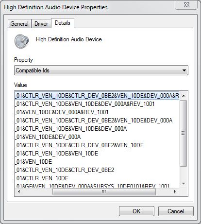

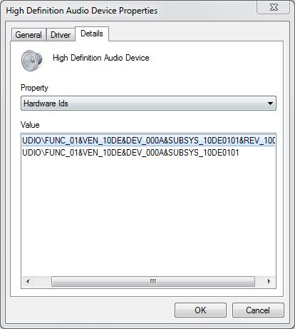

maczx Posted September 1, 2010 Share Posted September 1, 2010 Me again. GOT IT!!!! On Nvidia GT240M. Tmongkol, thank you so much for your guidance!! Looking at the IORegistryExplorer of the newer MacBookPro6,1, I discovered there's some important clues going on with the AppleHDAController kext. The MacBookPro6,1 uses the device id 0BE2 for the Nvidia HDMI audio, same Nvidia HDMI id as mine, that's why I did not get any HDMI audio device id errors. The device id 0BE2 is in the AppleHDAController binary. *** EDIT - 27 Aug 2010 ***: I now get HDMI audio, including all the other sound devices in Sound preferences. I had combined 2 microphones in the AppleHDAPlatformDriver Pathmaps, now I have the 2 microphones in 2 separates Pathmaps. The hdaGfxCandidate failed error is gone. HDMI audio is enabled with dsdt edit only. AppleHDAController totally unmodified. The HDMI is connected to my Onkyo TX-SR606 audio receiver. I can do up to 7.1 multichannel, or send directly the Dolby Digital 5.1 encoded stream in VLC Media Player by selecting Built-In HDMI Output (Encoded Output). I tried the 5.1 AAC encoded Apple trailer of Skyline. Crisp, neat and vibrant 5.1 analog sound coming out of all 5 speakers and the subwoofer. Quite neat. Thanks again Tmongkol. *** EDIT ***: Some of you might want to see what dsdt code I'm using, here is my Graphics device section: Device (PEG3) { Name (_ADR, 0x00030000) Method (_PRT, 0, NotSerialized) { If (PICM) { Return (AR0A ()) } Return (PR0A ()) } Device (GFX0) { Name (_ADR, Zero) Name (_PRW, Package (0x02) { 0x09, 0x05 }) OperationRegion (PEGH, PCI_Config, Zero, 0x40) Field (PEGH, ByteAcc, NoLock, Preserve) { VID0, 16, DID0, 16 } Method (_DSM, 4, NotSerialized) { If (LEqual (Arg0, Buffer (0x10) { /* 0000 */ 0xC6, 0xB7, 0xB5, 0xA0, 0x18, 0x13, 0x1C, 0x44, /* 0008 */ 0xB0, 0xC9, 0xFE, 0x69, 0x5E, 0xAF, 0x94, 0x9B })) { If (LNotEqual (And (VID0, 0xFFFF), 0xFFFF)) { Store (Package (0x02) { "hda-gfx", Buffer (0x0A) { "onboard-1" } }, Local0) DTGP (Arg0, Arg1, Arg2, Arg3, RefOf (Local0)) Return (Local0) } } Return (0x80000002) } } Device (HDAU) { Name (_ADR, One) OperationRegion (HDAH, PCI_Config, Zero, 0x40) Field (HDAH, ByteAcc, NoLock, Preserve) { VID0, 16, DID0, 16 } Method (_DSM, 4, NotSerialized) { If (LEqual (Arg0, Buffer (0x10) { /* 0000 */ 0xC6, 0xB7, 0xB5, 0xA0, 0x18, 0x13, 0x1C, 0x44, /* 0008 */ 0xB0, 0xC9, 0xFE, 0x69, 0x5E, 0xAF, 0x94, 0x9B })) { If (LNotEqual (And (VID0, 0xFFFF), 0xFFFF)) { Store (Package (0x02) { "hda-gfx", Buffer (0x0A) { "onboard-1" } }, Local0) DTGP (Arg0, Arg1, Arg2, Arg3, RefOf (Local0)) Return (Local0) } } Return (0x80000002) } } } And here is my HDEF section: Device (HDEF) { Name (_ADR, 0x001B0000) OperationRegion (HDAR, PCI_Config, Zero, 0x60) Field (HDAR, WordAcc, NoLock, Preserve) { VID0, 16, DID0, 16, Offset (0x4C), DCKA, 1, Offset (0x4D), DCKM, 1, , 6, DCKS, 1, Offset (0x54), , 15, PMES, 1 } Method (_PRW, 0, NotSerialized) { Return (GPRW (0x0D, 0x04)) } Method (_DSM, 4, NotSerialized) { Store (Package (0x06) { "layout-id", Buffer (0x04) { 0x0C, 0x00, 0x00, 0x00 }, "device-type", Buffer (0x06) { "Audio" }, "PinConfigurations", Buffer (Zero) {} }, Local0) DTGP (Arg0, Arg1, Arg2, Arg3, RefOf (Local0)) Return (Local0) } } i have a question my laptop also has a nv gt240m graphic card its devid just 10ed000a so i do not need to path the applehda,i just neeed to modify the dsdt.aml Right? now my question is: when HDMI cable are not pluged between graphic card and LCD TV , in the System Profiler >Audio(build in) it has the info about HDMI show as 'HDMI/DIsplyPort Output',but in the System Preferences >sound>output there is no device of HDMI ,is this station is ok? when the HDMI cable are pluged between graphic card and LCD TV , would the device of HDMI show as same as your picture? thx ! sorry my poor eng Link to comment https://www.insanelymac.com/forum/topic/140941-alc889a-gigabyte-intel-now-having-a-working-front-mic/page/36/#findComment-1541197 Share on other sites More sharing options...

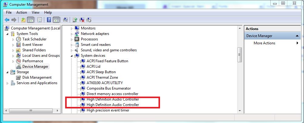

Jingu Posted September 1, 2010 Share Posted September 1, 2010 @Maczx, So you have a GT240M like me. Are you sure about your HDMI controller device id? Double check with windows the way Tmongkol explains in his post# 760. You say 10DE000A, but I think it's more likely to be 10DE0BE2, 10DE0BE4 or something like that. Those HDMI device codes are actually in the AppleHDAController binary. You are correct. "HDMI /Displayport Output" will always show in the System Profiler Audio (Built In) section if you have correctly inserted the hda-gfx and Device (HDAU) hacks in your dsdt. However, the HDMI sound device only shows in System Preferences Sound Output section if you have connected an HDMI sound device. It will not show if you don't have any HDMI sound devices connected. That's normal. Link to comment https://www.insanelymac.com/forum/topic/140941-alc889a-gigabyte-intel-now-having-a-working-front-mic/page/36/#findComment-1541321 Share on other sites More sharing options...

maczx Posted September 2, 2010 Share Posted September 2, 2010 @Jingu thx your quick reply! you could see the my HDMI devID from the following pictures: and what is your 'Realtek High Definition Audio' code ID? Link to comment https://www.insanelymac.com/forum/topic/140941-alc889a-gigabyte-intel-now-having-a-working-front-mic/page/36/#findComment-1541533 Share on other sites More sharing options...

Jingu Posted September 2, 2010 Share Posted September 2, 2010 @Maczx, Yes, that's right. Your HDMI device id is 10DE000A and that id is already in the AppleHDA binary, so no need to patch the AppleHDA binary. Now, check also your HDMI audio controller id. Your HDMI device sits on the HDMI audio controller. For HDMI audio to work, you need to have your HDMI device id in the AppleHDA binary and your HDMI audio controller id in the AppleHDAController binary. You've already checked your HDMI device id. Here's how to check your HDMI audio controller id: Go the same way in Device Manager, except this time, look under system devices (refer to my attachment). You should see 2 High Definition Audio Controllers. This first one should be the audio controller for your sound card and the second one should be your HDMI audio controller for your HDMI device. Look up the device id of your HDMI audio controller. In my case for my GT240M, my HDMI device id is 10DE000A (already in the AppleHDA binary) and my HDMI audio controller id is 10DE0BE2 (already in AppleHDAController binary). Both IDs have to be in the binaries for your HDMI audio to work. Link to comment https://www.insanelymac.com/forum/topic/140941-alc889a-gigabyte-intel-now-having-a-working-front-mic/page/36/#findComment-1541989 Share on other sites More sharing options...
maczx Posted September 3, 2010 Share Posted September 3, 2010 @jingu Yes!it's 0be2 as yours BTW what 's model of sound card? mine is alc 269.what about yours? Link to comment https://www.insanelymac.com/forum/topic/140941-alc889a-gigabyte-intel-now-having-a-working-front-mic/page/36/#findComment-1542047 Share on other sites More sharing options...
