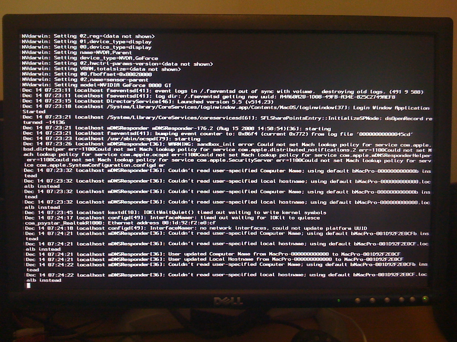

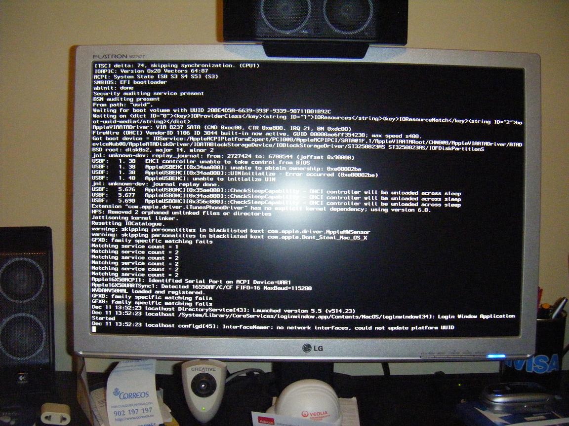

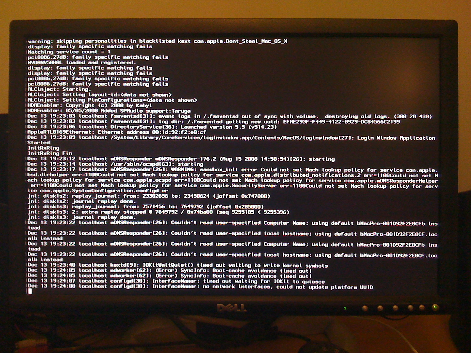

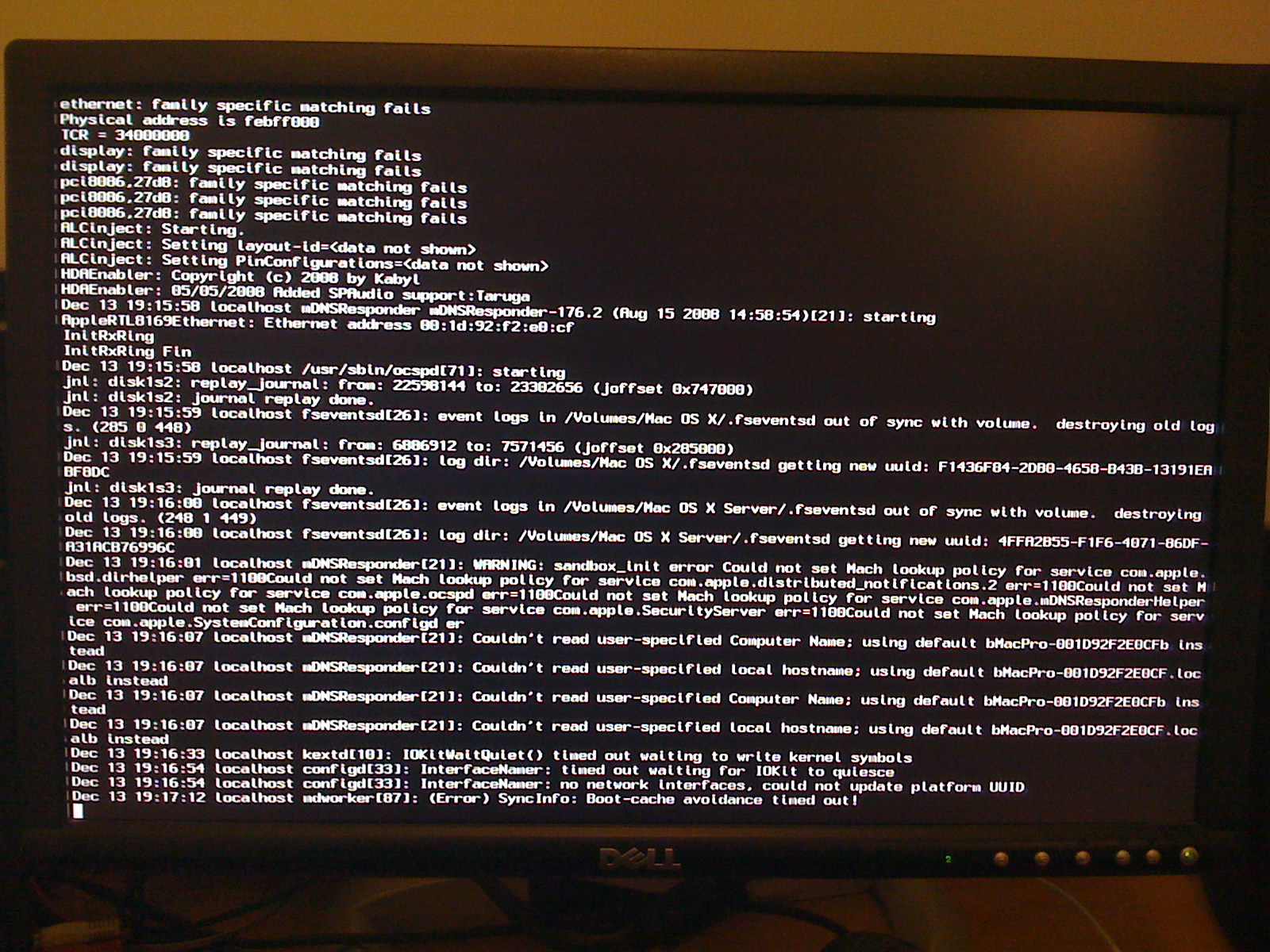

Bimmer Posted December 14, 2008 Share Posted December 14, 2008 BlackCH, Thanks for all you do!!!! I have tried many times to get this release to work, but without success, I have gotten JaS and Kalyway to work fine. I would really like to get this to work. Here are some screen shots were it stops during boot up, the first one is normal boot, and the second one is safe boot with -x. My specs are below: Intel Pentium 4 3.0GHz SSE3 MSI 945GCM478 Motherboard Nvidia Geforce 8800 GT 512MB Intel 945GC ICH7 Chipset Realtek RTL8101E Lan Realtek ALC 888 Audio Link to comment Share on other sites More sharing options...
BlackCH Posted December 14, 2008 Author Share Posted December 14, 2008 BlackCH, Thanks for all you do!!!! I have tried many times to get this release to work, but without success, I have gotten JaS and Kalyway to work fine. I would really like to get this to work. Here are some screen shots were it stops during boot up, the first one is normal boot, and the second one is safe boot with -x. My specs are below: Intel Pentium 4 3.0GHz SSE3 MSI 945GCM478 Motherboard Nvidia Geforce 8800 GT 512MB Intel 945GC ICH7 Chipset Realtek RTL8101E Lan Realtek ALC 888 Audio No Problem, What items have you Installed? post a full list try: -Essential System Software -All 'Essential Kext' Items -Voodoo 1.0 kernel -ICHx Dune (optional) -AppleAHCIPort_extended (optional) -NVinject_512mb or NVDarwin_512_mb -LastMBPNVKext (optional; just install if your problem persist) -ALC888 (there are a couple to choose from, just try) -RTL1000 driver -BootPrompt -SySProfileFix -All Items from 'Tools' (optional) Try doing the first boot with -v -f Link to comment Share on other sites More sharing options...
