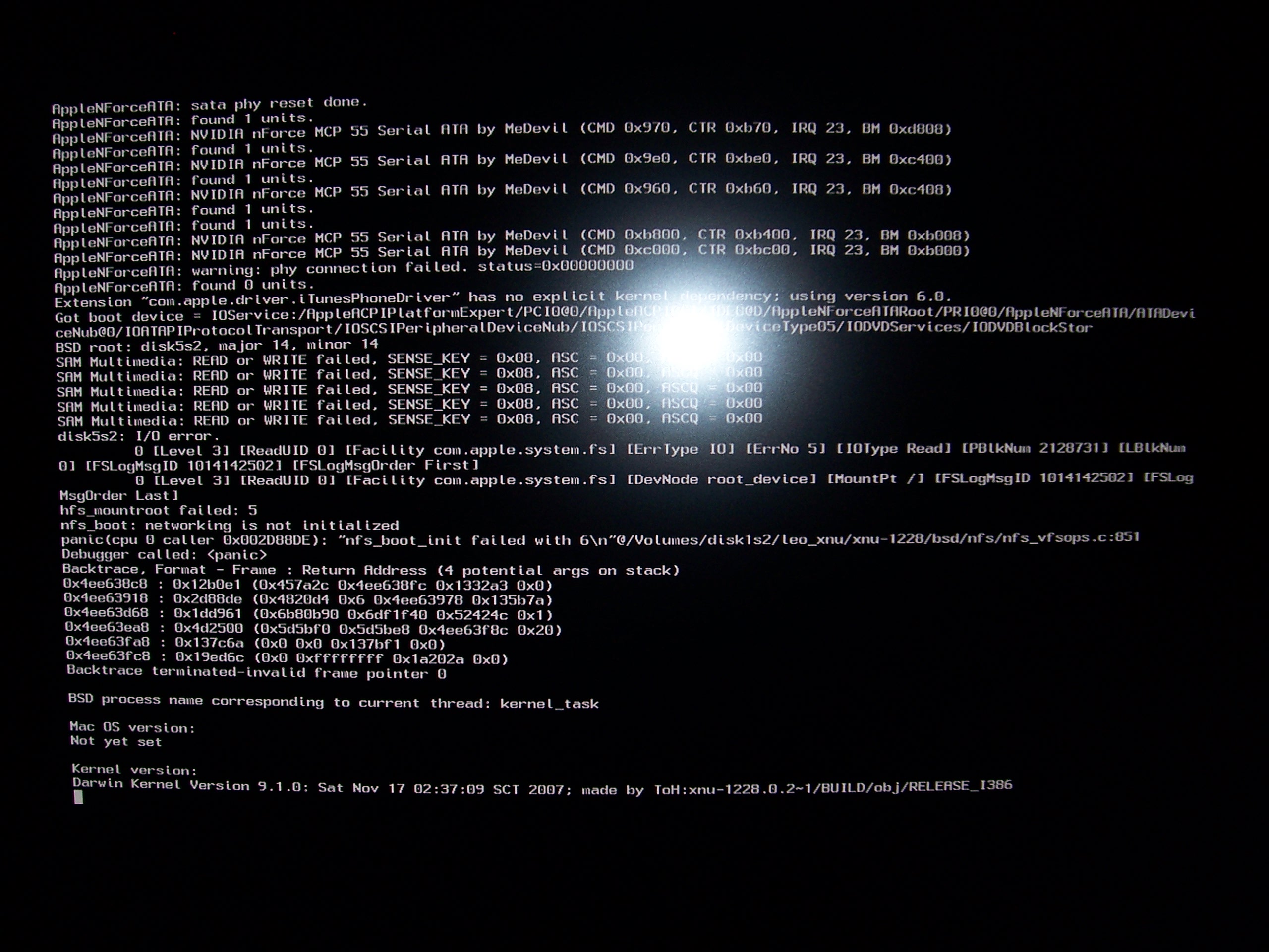

BlackCH Posted December 14, 2008 Author Share Posted December 14, 2008 I am using XxX 10.5.5 PPF2 disk (just for info). Tried options listed above, same problem. I checked the MD5, it's good, I also reburned the disk. Here is another screen shot. Strange; that selection should work... You can try vanilla kernel (dont select any optional ones), try different SMBIOS versions instead the SMIOSEFI.... Im sure it should work on your system; I guess is just matter of find the right combination (use as a base the one I suggested) ... Delete the target partition after each re-install...Sorry, but is difficult to give further help without being in front of the actual computer... Link to comment Share on other sites More sharing options...

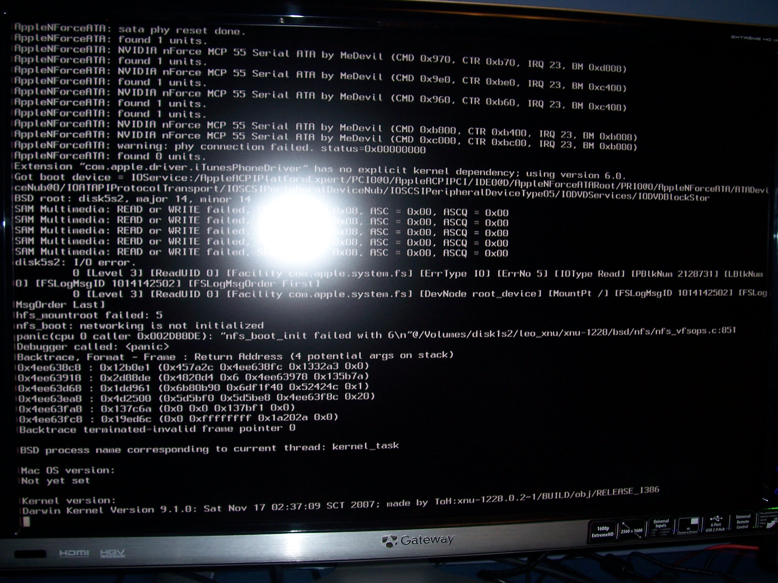

shawmishrak Posted December 15, 2008 Share Posted December 15, 2008 Unfortunately, I am getting a kernel panic when I try to boot the DVD. I have tried PPF1 and PPF2 with mach_kernel and mach_kernel_2. They all panic at the same place. I am not getting this panic with any other distribution, but none of the other distributions can get all of the way through the install process. Any idea what could be going wrong here? I apologize if this has already been addressed, the search functionality on this forum seems to be worthless. EDIT: Forgot system specs. Motherboard: eVGA 680i CPU: Intel Q6600 Video: nVidia 8800 GTX 768MB RAM: 4 GB IDE DVD-ROM and SATA hard drives. Link to comment Share on other sites More sharing options...

shawmishrak Posted December 15, 2008 Share Posted December 15, 2008 You have an IO disk error which I guess is causing the panic. Your ISO might be bad burned or corrupt or the NForceATA driver isnt working on your system (I see a warning there too)... is your DVD drive ATA or SATA? I get the I/O error with other distributions and it does not cause a kernel panic with them. I know the NForceATA driver works on my system for other distributions (iATKOS, Kalyway, etc.) so unless this is a modified version, I doubt this is the problem. The kernel panics while trying to access NFS which would imply a network issue, but I have no idea why that would be. My DVD drive is IDE/ATA. I tried both connectors on the ribbon cable on the off chance that the driver requires the drive to be on a certain port. Thanks for the help. Link to comment Share on other sites More sharing options...
BlackCH Posted December 15, 2008 Author Share Posted December 15, 2008 I get the I/O error with other distributions and it does not cause a kernel panic with them. I know the NForceATA driver works on my system for other distributions (iATKOS, Kalyway, etc.) so unless this is a modified version, I doubt this is the problem. The kernel panics while trying to access NFS which would imply a network issue, but I have no idea why that would be. My DVD drive is IDE/ATA. I tried both connectors on the ribbon cable on the off chance that the driver requires the drive to be on a certain port. Thanks for the help. An easy solution would be to replace the /mach_kernel and /System/Library/Extensions.mkext inside the XxX ISO with the ones from whatever ISO version that works on your system. sudo hdiutil attach -readwrite -owners on /path/to/the/XxX_ISO then you can edit any file inside the iso. You need to make the invisible files to be shown by finder (with onyx or macpilot)... If you want to troubleshoot, try booting the DVD without your HD connected and see if you get the same error.... Link to comment Share on other sites More sharing options...
