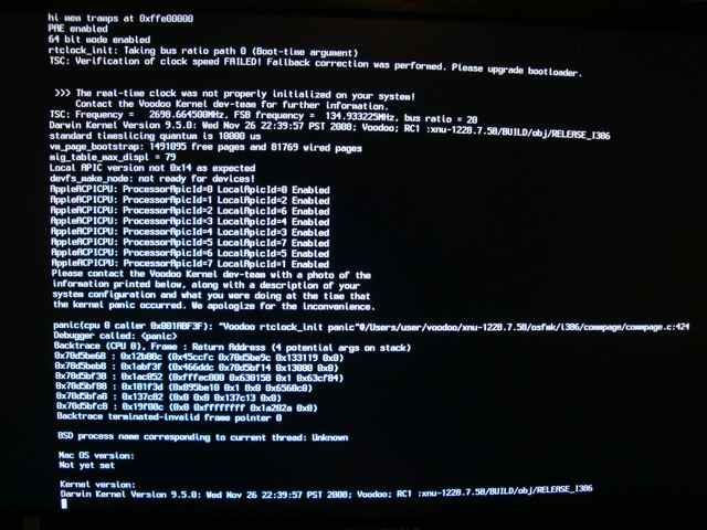

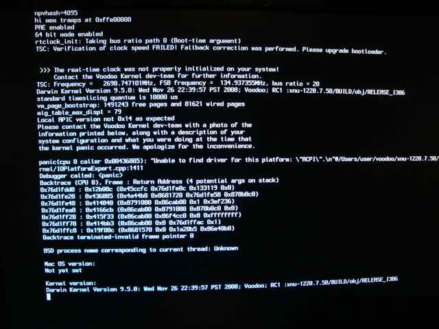

ѕӎѳѳ₮ңӌ Posted November 30, 2008 Share Posted November 30, 2008 (edited) it might be worth posting this in the voodoo thread or pming modsquad! make sure you show him those images though. as more and more people get the i7, its in everybodies interest to use the voodoo kernel! I've tried ACHI off and on, but no luck. Latest try was with a 10.5.5 retail install with new Voodoo kernel, but getting KPs Edited November 30, 2008 by ѕӎөөҭңӌ Link to comment https://www.insanelymac.com/forum/topic/132960-upcoming-intel-x58-mobos-core-i7-cpus/page/4/#findComment-983197 Share on other sites More sharing options...

luh3417 Posted December 1, 2008 Share Posted December 1, 2008 it might be worth posting this in the voodoo thread or pming modsquad! make sure you show him those images though. as more and more people get the i7, its in everybodies interest to use the voodoo kernel! Can you post a link to "the voodoo thread"? Link to comment https://www.insanelymac.com/forum/topic/132960-upcoming-intel-x58-mobos-core-i7-cpus/page/4/#findComment-983482 Share on other sites More sharing options...
Weavie Posted December 1, 2008 Share Posted December 1, 2008 Can you post a link to "the voodoo thread"? Sorry for not mentioning it, but I actually sent this issue over to the development team for the Voodoo kernel first. Still trying every option for the x58 mobo and Core i7 cpu setup. I will start noting as much as I can and also start taking more shots of my screens after each failed attempt (and will scream in joy after a success). Link to comment https://www.insanelymac.com/forum/topic/132960-upcoming-intel-x58-mobos-core-i7-cpus/page/4/#findComment-983520 Share on other sites More sharing options...

ѕӎѳѳ₮ңӌ Posted December 1, 2008 Share Posted December 1, 2008 Can you post a link to "the voodoo thread"? nope, but i can do one better! this is a link to the issue report page, you can get to the news page through it aswell! Link to comment https://www.insanelymac.com/forum/topic/132960-upcoming-intel-x58-mobos-core-i7-cpus/page/4/#findComment-983865 Share on other sites More sharing options...
Weavie Posted December 1, 2008 Share Posted December 1, 2008 Okay.... I have finally got this working after 5 days! So far, two successful attempt have been made using iAtkos 5 DVD. One selecting the 9.5 Voodoo kernel (beta) and the other selecting the 9.5 kernel by Fassl. With Voodoo had to use "busratio=" at prompt (if not KP received). Other selections/patches were: Chameleon Bootloader, Apple Decrypt, SMBIOS Resolver, Stock ACPI modified, Disabler.kext, SATA/IDE, Intel Speedstep a Will run test later today. Also haven't installed any addotional apps yet. Hey Weavie, Make sure AHCI is on in bios and any IDE is disabled Try installing with leo4all v3, makesure you boot with this "maxmem=2048" Let me know how it goes with leo4all v3 Also, ACHI was on and IDE was disabled. Not sure about any other boards but this is my second Gigabyte and this has always made a major difference in speed. All memory was recognized in the "About this Mac" window but when you select Memory on the left it does not correctly show the 3rd slot, it only shows 2 slots are occupied. Only shows 7 cores. Link to comment https://www.insanelymac.com/forum/topic/132960-upcoming-intel-x58-mobos-core-i7-cpus/page/4/#findComment-983970 Share on other sites More sharing options...
ѕӎѳѳ₮ңӌ Posted December 1, 2008 Share Posted December 1, 2008 (edited) Only shows 7 cores. does geekbench only show 7? also voodoo team are aware! Accepting bug, will contact when work begins. Edited December 1, 2008 by ѕӎөөҭңӌ Link to comment https://www.insanelymac.com/forum/topic/132960-upcoming-intel-x58-mobos-core-i7-cpus/page/4/#findComment-984062 Share on other sites More sharing options...

THEHAWKs Posted December 1, 2008 Share Posted December 1, 2008 I've tried ACHI off and on, but no luck. Latest try was with a 10.5.5 retail install with new Voodoo kernel, but getting KPs Your FSB is not right 133 x 20 = 2660 = Intel core i7 920 "2.66" try fsb=133 -v -f Link to comment https://www.insanelymac.com/forum/topic/132960-upcoming-intel-x58-mobos-core-i7-cpus/page/4/#findComment-984367 Share on other sites More sharing options...
digital_dreamer Posted December 1, 2008 Share Posted December 1, 2008 I wondered about that fsb, but you know, there isn't really a fsb on that i7, so I don't know what it's calculating. I thought he had 133 x 20 there, according to the screenshots? regards, MAJ Link to comment https://www.insanelymac.com/forum/topic/132960-upcoming-intel-x58-mobos-core-i7-cpus/page/4/#findComment-984547 Share on other sites More sharing options...
ѕӎѳѳ₮ңӌ Posted December 1, 2008 Share Posted December 1, 2008 (edited) i believe fsb's replacement is system bus? which in the reviews i have read is set at 133.... imageview.php.jpeg Edited December 1, 2008 by ѕӎөөҭңӌ Link to comment https://www.insanelymac.com/forum/topic/132960-upcoming-intel-x58-mobos-core-i7-cpus/page/4/#findComment-984556 Share on other sites More sharing options...
Weavie Posted December 1, 2008 Share Posted December 1, 2008 Your FSB is not right 133 x 20 = 2660 = Intel core i7 920 "2.66" try fsb=133 -v -f 133 is what I remember using when I tried the retail install the first time using the Voodoo RC. My successful attempt with the Voodoo beta came by just entering the "busratio=20" and nothing else from the iatkos 5 install. I am going to attempt the retail install again now that I know what works and what doesn't. Link to comment https://www.insanelymac.com/forum/topic/132960-upcoming-intel-x58-mobos-core-i7-cpus/page/4/#findComment-984644 Share on other sites More sharing options...
