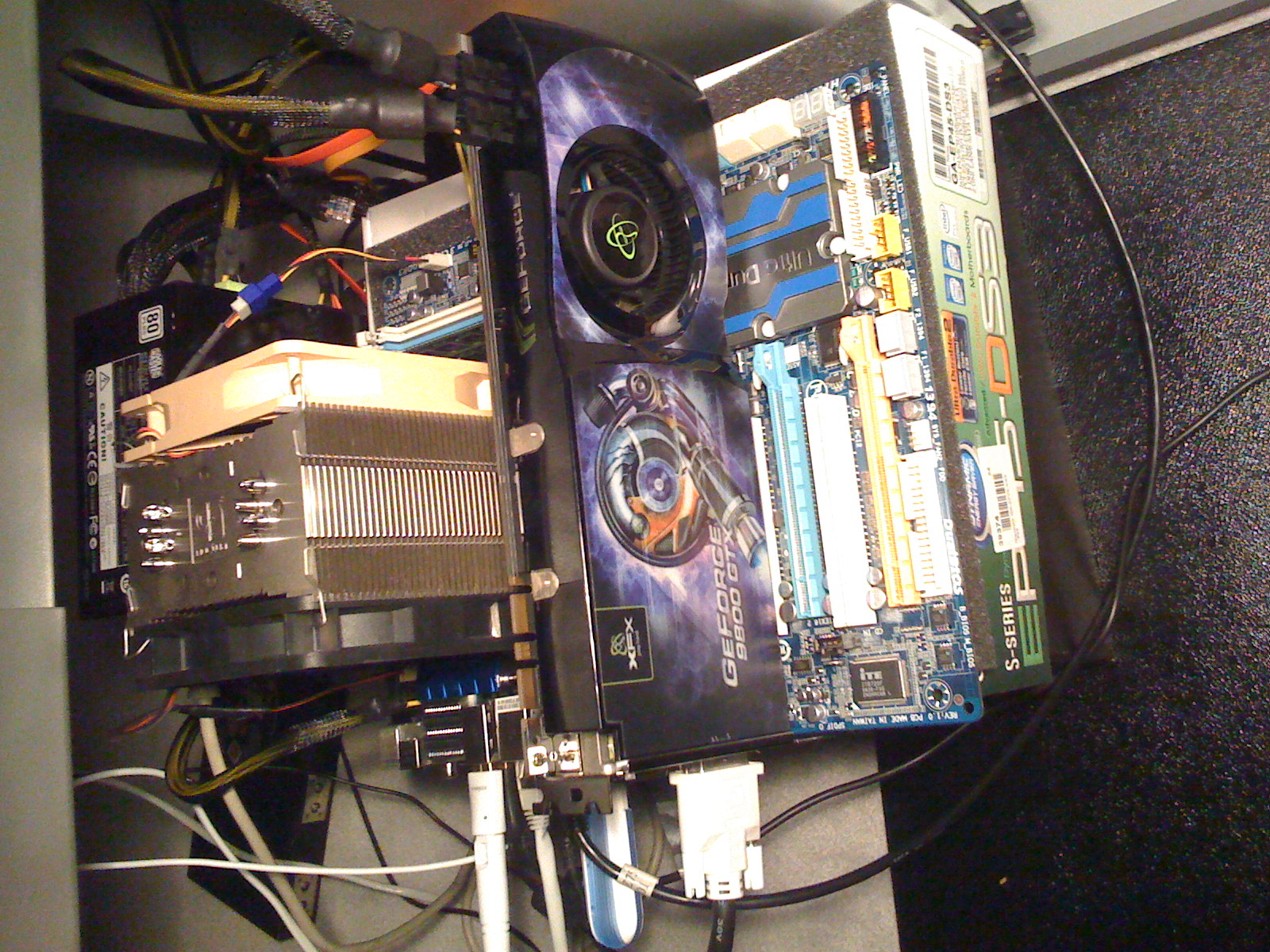

PoloBear Posted December 8, 2008 Share Posted December 8, 2008 The Processor is overclocked to 3.6 GHz, it cooled with single fan Noctua, Tempmonitor is not woorking, Kernelpanics, but under XP i have Temps of only 55 to 65°C load. This is an average result. If you check the overclocking sites, they get 4 to 4.2 GHz, but I dont want to raise Voltage any higher. here are some pictures of my setup.... and yes, the box is from another mainboard, here is my mainmachine running happy hacking to the ukraine... Crappy pictures taken by my fake Iphone Link to comment https://www.insanelymac.com/forum/topic/132960-upcoming-intel-x58-mobos-core-i7-cpus/page/6/#findComment-991296 Share on other sites More sharing options...
digital_dreamer Posted December 8, 2008 Share Posted December 8, 2008 Noticed that you have an extra fan on the other side of your Ultra-120. Has that made a difference for you? The [H]ardopc.com forums have quite a few users at or over 4GHz, but not much over. They typically have wc and radical setups, however. And, yeah, temperature monitor does KP. Not nice. Disappointing that there aren't any options in OS X. iStat does nothing, either. All I get is hard drive temps from S.M.A.R.T. Anybody got working audio?! I've been digging deep into the AppleHDA patching. I've downloaded a supposed ALC889A codec dump, I'm not really sure I got the right codec. The description inside is for the ALC885, even though the file has been named 889A. Anyhow, I got a codecgraph created in decimal, but that's as far as I've gotten for now. regards, MAJ Link to comment https://www.insanelymac.com/forum/topic/132960-upcoming-intel-x58-mobos-core-i7-cpus/page/6/#findComment-991345 Share on other sites More sharing options...
PoloBear Posted December 8, 2008 Share Posted December 8, 2008 The new version of noctua comes with dual fans, and yes it makes a difference, but too small to accept the noise. If you check the Hardwareluxx.de. It is a german forum, most of the 4 GHz guys just raise the Voltage high enough, and yes these guys have extreme cooling, and extreme everything.... for audio check here http://forum.insanelymac.com/index.php?act...st&id=33757 Link to comment https://www.insanelymac.com/forum/topic/132960-upcoming-intel-x58-mobos-core-i7-cpus/page/6/#findComment-991424 Share on other sites More sharing options...

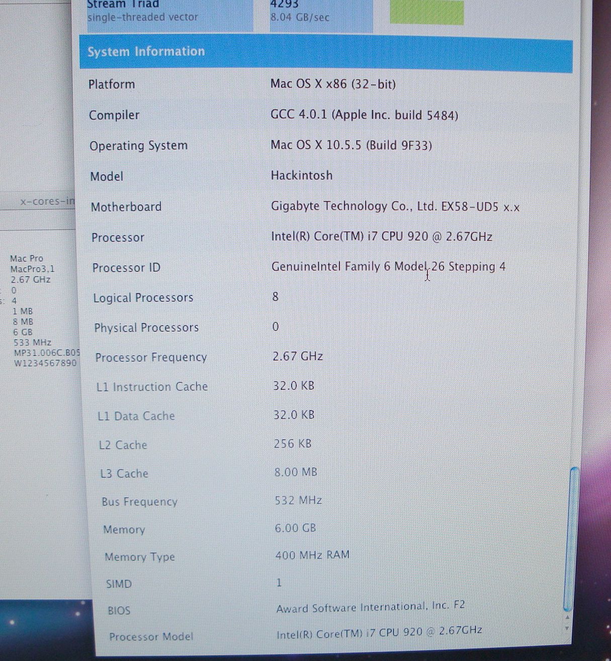

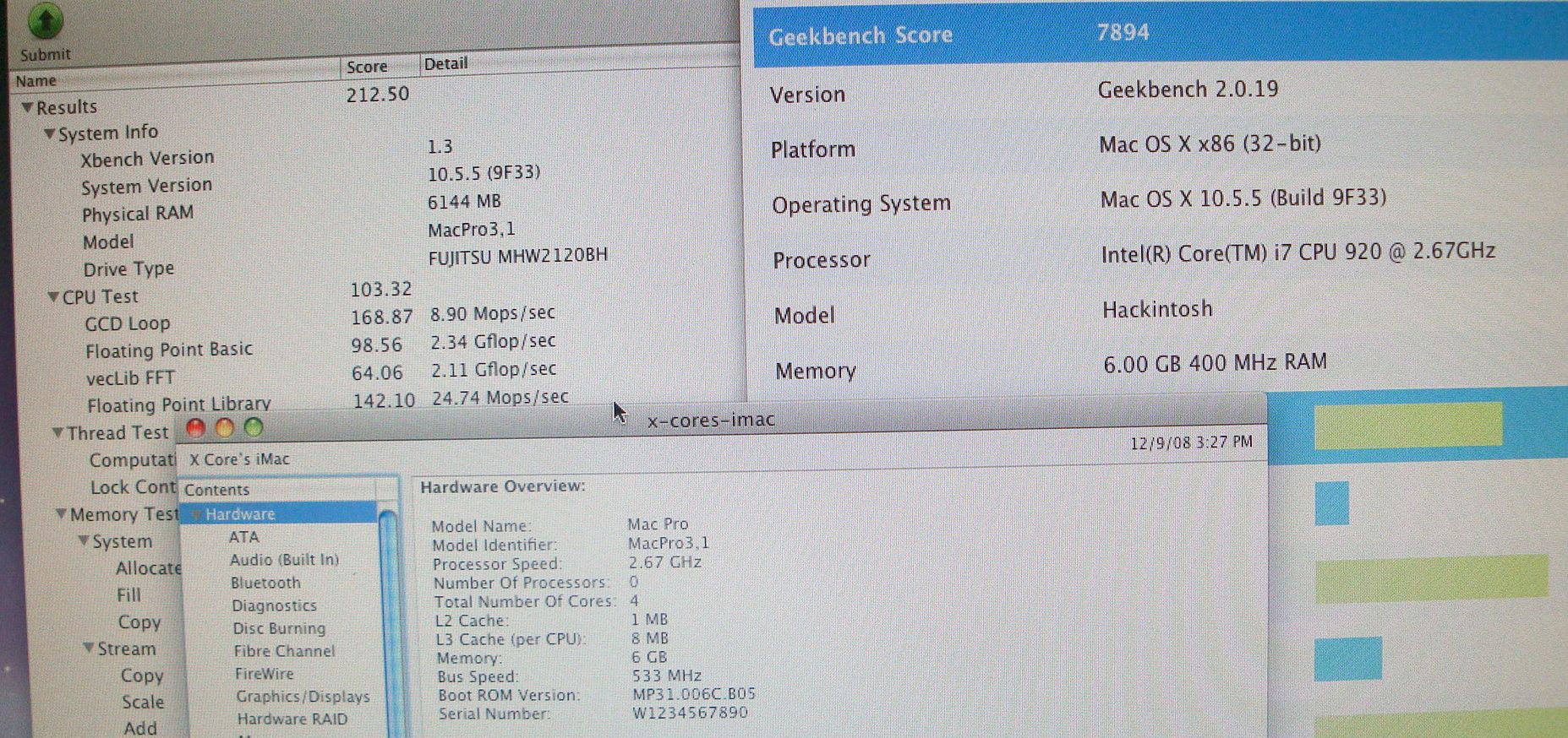

wolfienuke Posted December 8, 2008 Share Posted December 8, 2008 I just purchased my i7 setup and had it up and running in about 4 hours. There are still a few quirks that I need to iron out, but I will walk through my settings so the next person can learn from my trials and errors. Motherboard: Gigabyte GA-EX58-UD5 Processor: Intel i7 920 RAM: 6GB (3x2GB) Corsair XMS3 DDR3 1333MHz Graphics: ATI 2600XT (For testing) Hard Drive: 500GB Maxtor SATA 3Gb (For testing) I will soon install a new graphics card, and I have 2x72GB Raptor 10,000RPM drives and 2x1.5TB Seagate drives which will be made into two separate RAID configurations. Bios Configuration: -Standard CMOS Features: --Drive A: None --Floppy 3 Mode Support: Disabled -Integrated Peripherals --SATA RAID/AHCI Mode: AHCI --SATA Port0-3 Native Mode: Disabled --USB Keyboard Function: Enabled --USB Mouse Function: Enabled --Azalia Codec: Auto --Onboard SATA/IDE Device: Enabled --Onboard SATA/IDE Ctrl Mode: IDE (Setting this to AHCI prevented boot from hard drive or dvd drive) Mac OS X Installer: Kalyway 10.5.2 -Kernels --kernel_922_kabyl -Graphics Drivers --[select your graphics driver] -Audio Drivers --[Not Required - will install proper kexts later] -Network Drivers --Network Cards ---RealtekR1000 --Wifi Cards ---[select your wifi card if installed] -Mobo Chipsets --[Leave as default] -Patches --Hardcoded SMBIOS ---AppleSMBIOS-27-DDR3-1333 --Time Machine Fix --Intel Memory Controller Post-Install ALC889a driver: Gigabyte_GA_EX58_UD5_Audio.zip (Should be fully working - Audio Input/Output all show in System Profiler) Realtek 8111D compatible driver: Gigabyte_GA_EX58_UD5_Ethernet.zip (Shouldn't be required) Delete ALCInject from /System/Library/Extensions/ Repair Permissions For some reason, I also had to reset the administrator password from the install disk since the initial user created did not have admin privileges. That may be an issue with the Kalyway installer though. Initial Benchmarks w/o tweaking: GeekBench: 7443 XBench: 232 (Probably because of the crappy HD and GFX I used to get the machine running) Link to comment https://www.insanelymac.com/forum/topic/132960-upcoming-intel-x58-mobos-core-i7-cpus/page/6/#findComment-991531 Share on other sites More sharing options...

Synaesthesia Posted December 8, 2008 Share Posted December 8, 2008 GeekBench: 7443 Wow! An 8-core Mac Pro @ 2.8Ghz gets 7598. This is a Intel Core i7 920 4-core @2.66ghz!! You should try encoding video to H.264 with Handbrake... Link to comment https://www.insanelymac.com/forum/topic/132960-upcoming-intel-x58-mobos-core-i7-cpus/page/6/#findComment-991780 Share on other sites More sharing options...
