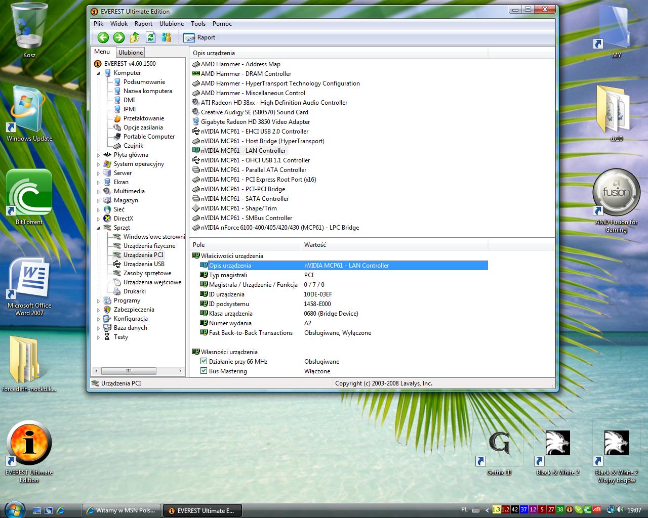

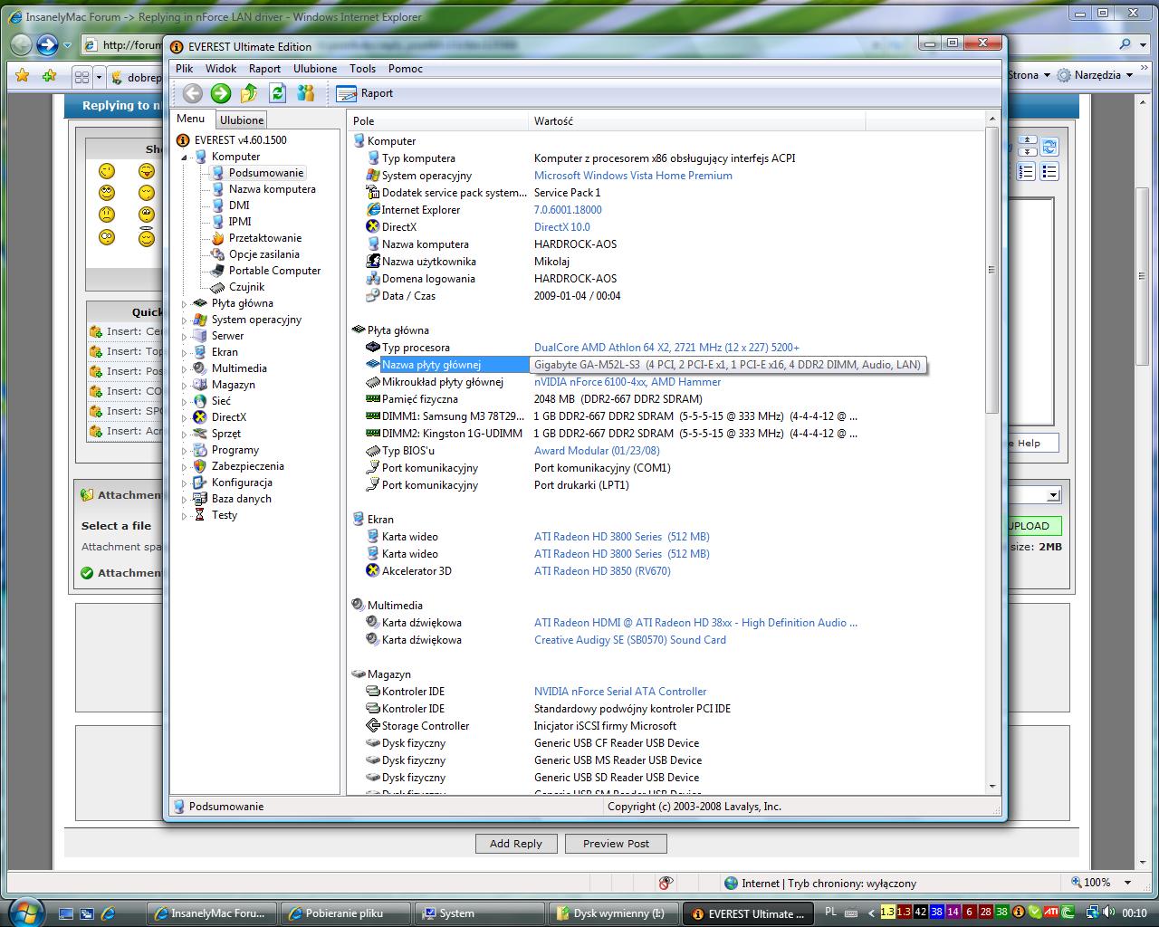

I Have a Nforce 520 LE on Gigabyte motherboard witch AMD Athlon 64 X2 Dual core processor 4800+
on KALYWAY 10.5.2 but its still dont working for me...I mean osx dont even find my ethernet/lan port
i tried forcedeth and forcedeth nockd,but no results...
so i need HELP
Last thing Everest tels me that is a NForce610
my @ is md47@windowslive.com
so i need HELP
