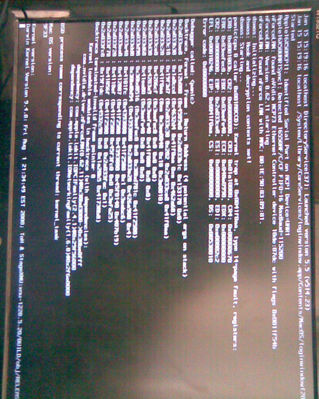

hi, eno, I got kernel panic when using your Lan driver 0.62.11n. My Device ID is 0x07dc10de, from a 630i/MCP73 MOBO
Do you have a snapshot or the text of the panic? Is forcedeth.kext installed? What distro/kernel are you using?
I am not using forcedeth. my system is 10.5.5 ideneb using 9.4 XNU kernel. the screen shot is in attachment. what's wrong?
Can you try optimization mode 1? If that doesn't work try setting DisableMSI. Both options are in the Info.plist
Try setting the optimization mode first and if any of those options help please send me a dump of only your MMAC device. You can get the dump by running ioreg -w 0 -l -p IODeviceTree -n MMAC
