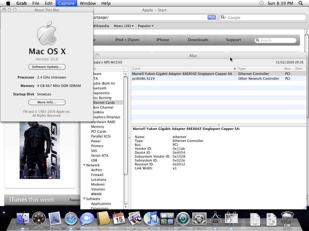

3Dman Posted February 13, 2009 Share Posted February 13, 2009 Well I think it maybe supported in Snow Leopard here's the the part of the plist: <key>Yukon-88E804Z</key> <dict> <key>CFBundleIdentifier</key> <string>com.apple.iokit.AppleYukon2</string> <key>EnableLowPwr</key> <integer>1</integer> <key>IOClass</key> <string>yukon2osx</string> <key>IOPCIPrimaryMatch</key> <string>0x435411ab</string> <key>IOProviderClass</key> <string>IOPCIDevice</string> <key>MACNumber</key> <integer>1</integer> <key>Model</key> <string>Yukon Gigabit Adapter 88E804Z Singleport Copper SA</string> That's from AppleYukon2.kext from Snow Leopard 10A261. Link to comment Share on other sites More sharing options...
Neonkoala Posted February 13, 2009 Share Posted February 13, 2009 Well I think it maybe supported in Snow Leopard here's the the part of the plist: <key>Yukon-88E804Z</key> <dict> <key>CFBundleIdentifier</key> <string>com.apple.iokit.AppleYukon2</string> <key>EnableLowPwr</key> <integer>1</integer> <key>IOClass</key> <string>yukon2osx</string> <key>IOPCIPrimaryMatch</key> <string>0x435411ab</string> <key>IOProviderClass</key> <string>IOPCIDevice</string> <key>MACNumber</key> <integer>1</integer> <key>Model</key> <string>Yukon Gigabit Adapter 88E804Z Singleport Copper SA</string> That's from AppleYukon2.kext from Snow Leopard 10A261. As a3Dman says it is supported in Snow Leopard, althought I haven't got to a desktop that doesn't crash to test it but AppleYukon2 displays an active en0 link when I boot with activity on the port. Currently it isn't reading my MAC address correctly though as it goes to 00:11:22:33:44:55. I have also tried the kexts under Leopard but they won't load, I don't think any Snow Leopard kexts will. Wait until Snow Leopard Grand Master for support. I'll report back if I find any more information after discovering this. Link to comment Share on other sites More sharing options...
Neonkoala Posted February 15, 2009 Share Posted February 15, 2009 Hmm, what's this... Works perfectly except for incorrectly detected MAC address. Link to comment Share on other sites More sharing options...
