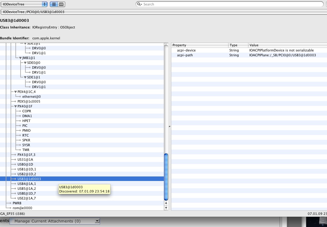

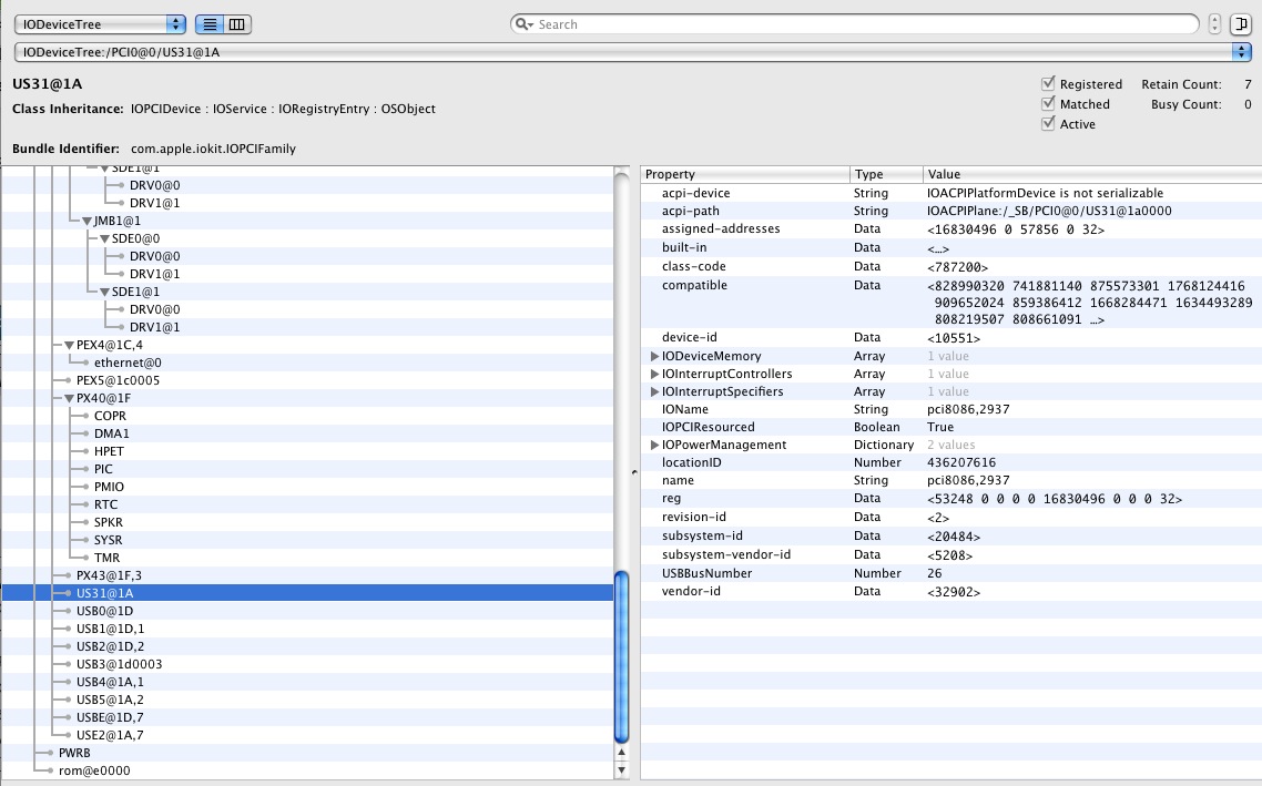

mitch_de Posted January 7, 2009 Share Posted January 7, 2009 I made a port of PCGen... for Leopard. Here it is.I don't know what is your problem. Try different kext's version's combinations. Hi slice, my USB 2.0 working at GA-EP35-DS3 ICH9 Chipset. But i have some ??? when i look in my IoregistryExplorer about USB3: USB3 didnt have such IOregEntries as USB0-5, US31,... have (right screenshoot) Only 2 lines (ledt screenshoot) I use dsdt, but part od USB isnt patched. I cant see any differences in the dsdt part between USB 2 (for example, DSDT.dsl if you have) and USB3(wich isnt registered as the others). Device (USB2) { Name (_ADR, 0x001D0002) Method (_S3D, 0, NotSerialized) { If (LEqual (OSFL, 0x02)) { Return (0x02) } Return (0x03) } Name (_PRW, Package (0x02) { 0x0C, 0x01 }) } Device (USB3) { Name (_ADR, 0x001D0003) Method (_S3D, 0, NotSerialized) { If (LEqual (OSFL, 0x02)) { Return (0x02) } Return (0x03) } Name (_PRW, Package (0x02) { 0x0E, 0x01 }) } Device (US31) { Name (_ADR, 0x001A0000) Method (_S3D, 0, NotSerialized) { If (LEqual (OSFL, 0x02)) { Return (0x02) } Return (0x03) } Name (_PRW, Package (0x02) { 0x0E, 0x01 }) } Device (USB4) { Name (_ADR, 0x001A0001) Method (_S3D, 0, NotSerialized) { If (LEqual (OSFL, 0x02)) { Return (0x02) } Return (0x03) } Name (_PRW, Package (0x02) { 0x05, 0x01 }) } How are your USB Devs seen (in the IORegistry Exploerer) / or other Users with an ICH9® Chipset ? added 2 screenshoots Link to comment https://www.insanelymac.com/forum/topic/117029-usb-20-for-leopard-1057/page/7/#findComment-1031388 Share on other sites More sharing options...

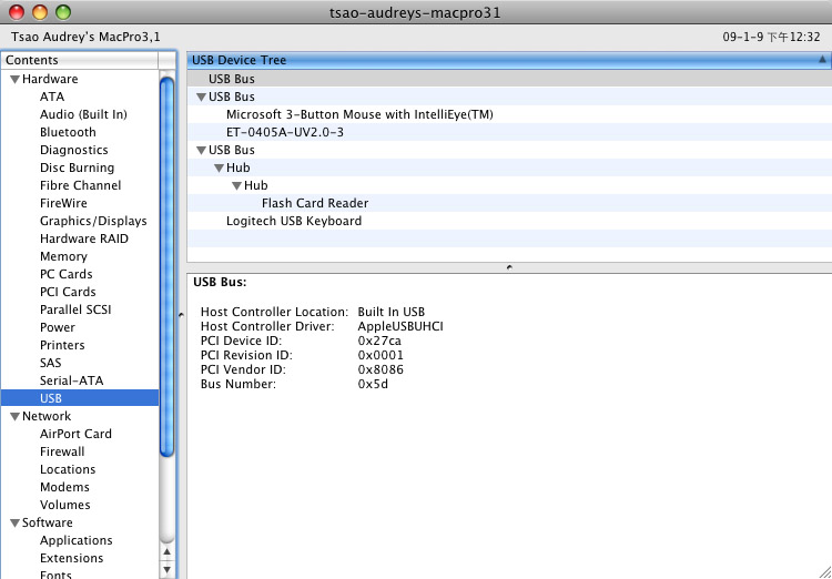

Onion_Skin Posted January 9, 2009 Share Posted January 9, 2009 Hi Slice, My hardware configuration is like this MB: Asus P5LD2-VM intel 945+ICH7 CPU: Intel C2D 6320 Memory: 2x2GB Video: Sapphire HD2600XT HD: 1x IDE Seagate 250GB 1x SATA Seagate 500GB and 1x SATA Seagate 1TB I installed iDenib 10.5.5, and upgrade it to 10.5.6 with PC-EFI v9. My problems are: 1. I have 8 USB ports in total, and all of them function perfectly in Windows XP. However, 2 of them can't be used in Leopard; 2. USB bus is in UCHI mode. File copying to flash drive is very slow at only ~2MB/s. I think this is typical USB 1.1 performance. I tried your driver version 328. ECHI driver loaded but with some errors in system.log. please see my system log systemlog.txt and here is my dmesg info dmesg.txt Here are all USB drivers loaded bash-3.2# kextstat | grep USB 41 9 0x49e0e000 0x29000 0x28000 com.apple.iokit.IOUSBFamily (3.2.7) <7 6 5 4 2> 42 0 0x49e7a000 0xe000 0xd000 com.apple.driver.AppleUSBUHCI (3.2.8) <41 17 7 6 5 4> 43 0 0x49f23000 0x12000 0x11000 com.apple.driver.AppleUSBEHCI (3.2.8) <41 17 7 6 5 4> 57 0 0x44c11000 0x2000 0x1000 com.apple.iokit.IOUSBUserClient (3.2.4) <41 6 5 4> 69 0 0x4a0e4000 0xc000 0xb000 com.apple.driver.AppleUSBHub (3.2.7) <41 6 5 4> 80 0 0x49ea5000 0x4000 0x3000 com.apple.driver.AppleUSBComposite (3.2.0) <41 5 4> 82 0 0x4a288000 0x5000 0x4000 com.apple.iokit.IOUSBHIDDriver (3.2.2) <41 24 6 5 4> 84 0 0x49cb6000 0x3000 0x2000 com.microsoft.driver.MicrosoftMouseUSB (6.2.2) <83 41 12> 86 0 0x4a516000 0xa000 0x9000 com.apple.iokit.IOUSBMassStorageClass (2.0.5) <48 44 41 12> However, USB bus is still in UCHI mode. The file copying speed is still the same. Can you help see what's wrong? Thanks for your great effort! Link to comment https://www.insanelymac.com/forum/topic/117029-usb-20-for-leopard-1057/page/7/#findComment-1033238 Share on other sites More sharing options...

Onion_Skin Posted January 9, 2009 Share Posted January 9, 2009 You probably need to erase AppleHPET.kext Hi Slice, I removed AppleHPET.kext. The EHCI error message indeed disappeared. Thanks a lot! However, the USB is still in UHCI mode. Anything else i can do for troubleshooting systemlog2.txt? Link to comment https://www.insanelymac.com/forum/topic/117029-usb-20-for-leopard-1057/page/7/#findComment-1033561 Share on other sites More sharing options...
Onion_Skin Posted January 9, 2009 Share Posted January 9, 2009 Sorry Slice, I do get EHCI USB bus. There are some devices still running in UHCI mode, which fool me. Moreover, the 2 unused USB ports are working now as well. I am so happyyyyyyyy! Thank you so much for your amazing work! You are the hero! Link to comment https://www.insanelymac.com/forum/topic/117029-usb-20-for-leopard-1057/page/7/#findComment-1033807 Share on other sites More sharing options...
