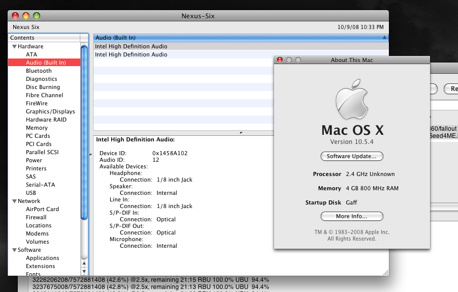

Havent tackled 10.5.5 update tonight. Did want to get this screen up though. Of note, this screen shot is currently of my system with headphones (green line out) plugged in. Also, note there are 2 audio devices. My theory is that the first one is the Front Panel header though I haven't tested that theory.
