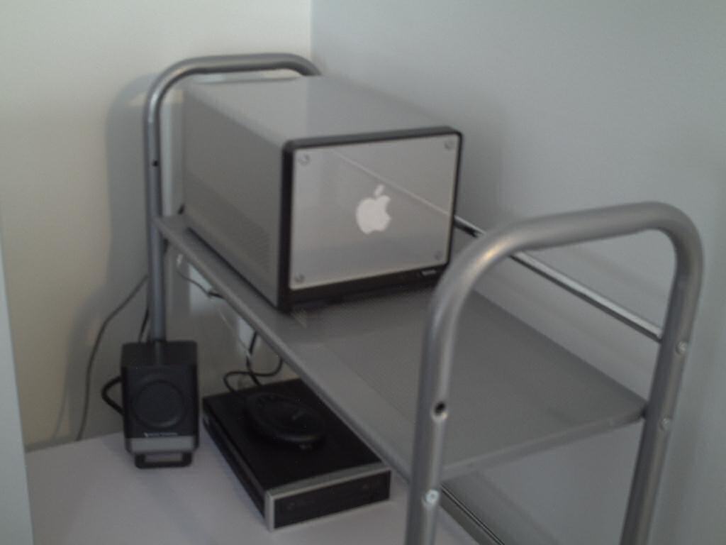

Aargh-a-Knot Posted January 10, 2009 Share Posted January 10, 2009 Finally finished my HackBox Media Server project using the D945GCLF2. Read the full story on my blog. Link to comment https://www.insanelymac.com/forum/topic/113623-build-a-perfect-mac-for-less-than-250/page/27/#findComment-1035091 Share on other sites More sharing options...

ElementalMac Posted January 10, 2009 Share Posted January 10, 2009 Finally finished my HackBox Media Server project using the D945GCLF2. Awesome! A thing of beauty! I'll check out your blog later. Link to comment https://www.insanelymac.com/forum/topic/113623-build-a-perfect-mac-for-less-than-250/page/27/#findComment-1035541 Share on other sites More sharing options...
