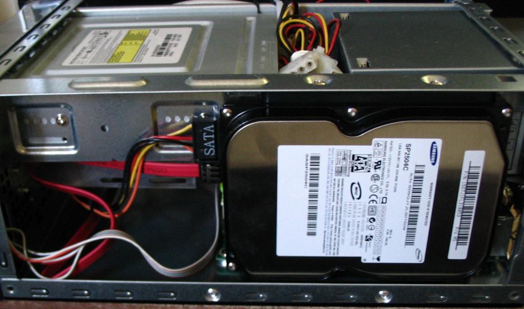

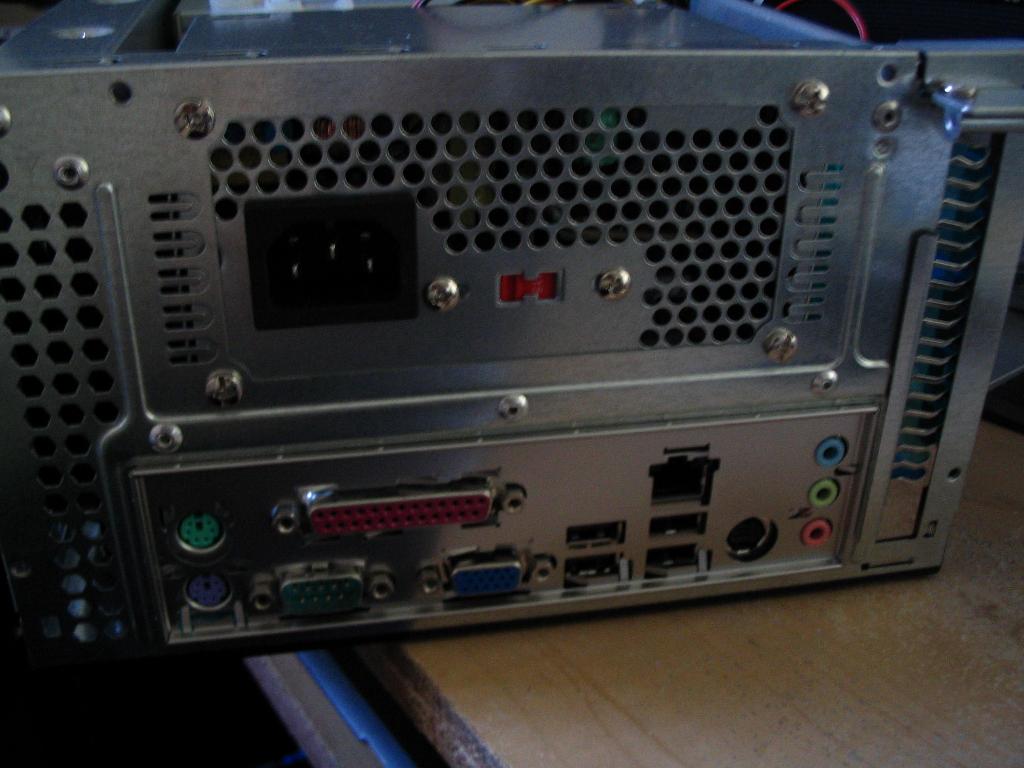

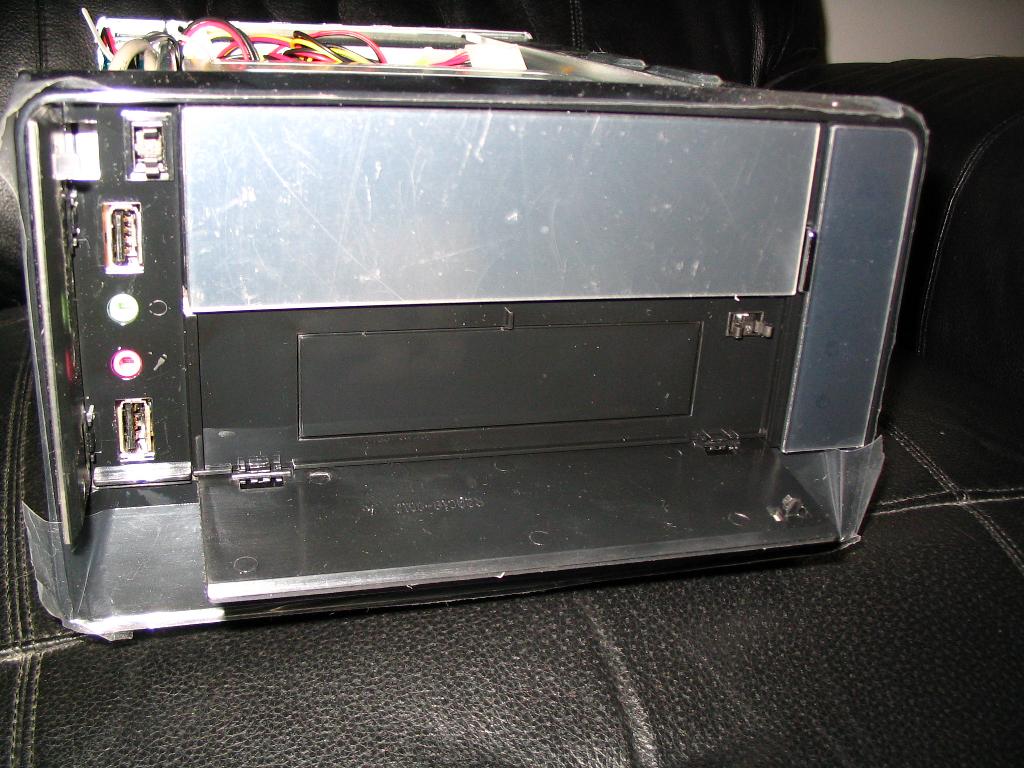

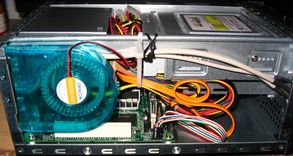

jWin Posted October 28, 2008 Share Posted October 28, 2008 Firstly thank you everyone for the information and knowledge. I have completed my "under 250$" Hackintosh which will be a Christmas gift to my mother who has been a Macintosh user for a long long time. The parts I used were all purchased at Newegg.com, and here is the list Intel BOXD945GCLF2 Atom 330 PNY Optima 2GB DDR2 SDRAM DDR2 667 (had free shipping) Samsung 250GB SATAII Hard Drive Apex MI-100 Case (beautiful case!!) Samsung SH-S203B SATA DVD-Writer I also added a slot fan I had laying around and will likely pickup a 3.5" card reader. I used Kalyway 10.5.2 and successfully upgraded to 10.5.5 using the "Bike Town" 3-step method. I had USB mounting issues with 10.5.2 which was fixed in 10.5.5. I lost Audio in 10.5.5 but fixed it with a patch on the forums. Everything seems to work great including sleep and reboot. It runs really quick and smooth for the price! And now for pics...the front looks scratchy because of the plastic film, but its really a clear mirror finish. Link to comment https://www.insanelymac.com/forum/topic/113623-build-a-perfect-mac-for-less-than-250/page/23/#findComment-947065 Share on other sites More sharing options...
