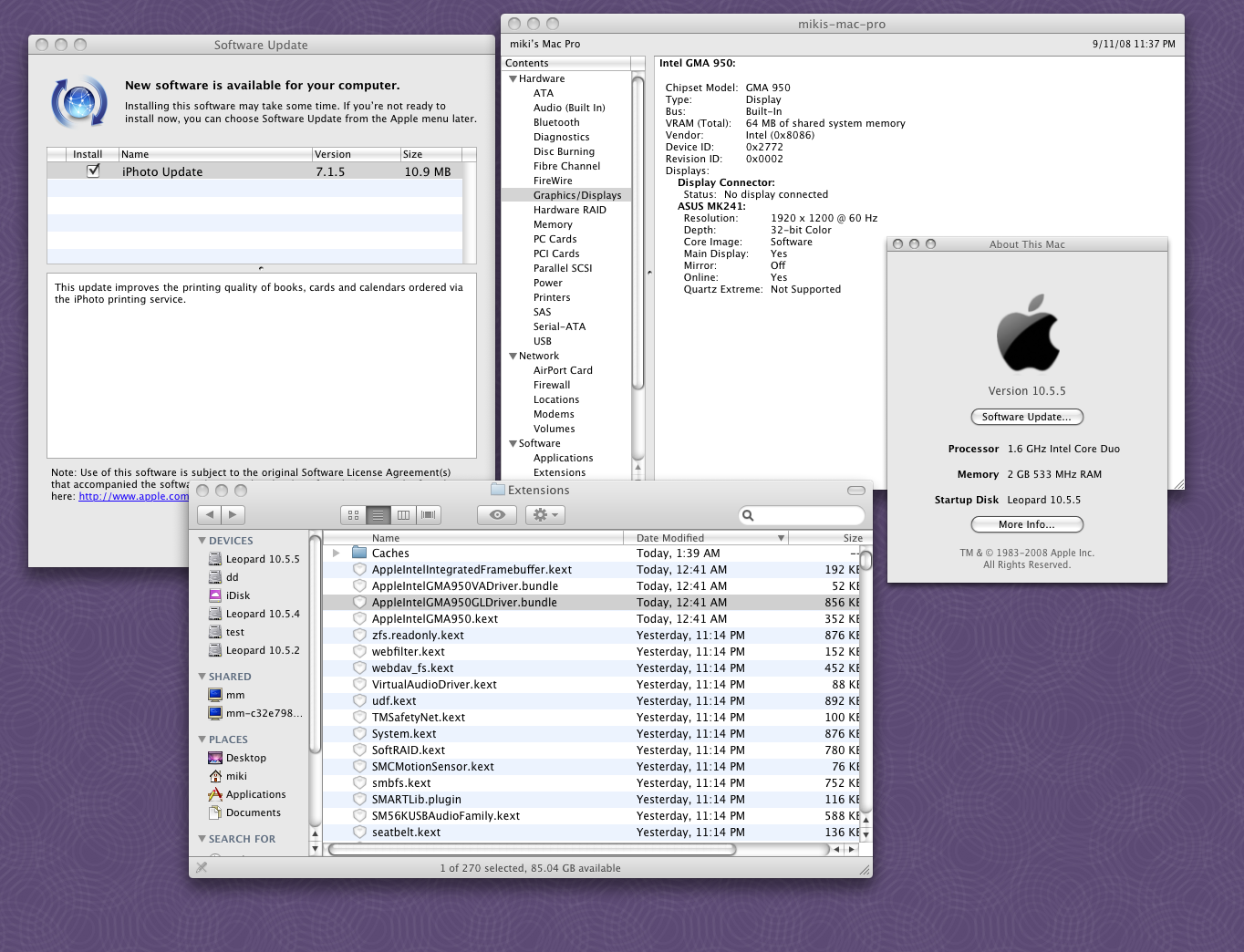

mirso Posted November 10, 2008 Share Posted November 10, 2008 It works for me Mainboard Intel D945GCLF2 & Atom 330 ~~~~~~~~~~~~~~~~~~~~~~~~~~~~~~~~~~~~~~~~~~~~~~~~ Create two or more partition for Mac (e.g. Mac1, Mac2, Mac3..) Install Kalaway 10.5.2 without any customization on partition Mac1 Reboot and Copy Mac1 to the second Mac2 partition (e.g. Use Carbon Copy Cloner from hxxp://www.bombich.com/software/ccc.html ) Reboot in Mac2 Download : Osx86tools MacOSXUpdCombo10.5.5.dmg Install MacOSXUpdCombo10.5.5.dmg from Mac2 to Mac1 Go from Mac2 to Mac1 and delete AppleIntelCpuPowermanagment.kext Start Osx86tools from Mac2 and extract listed kexts (all posted already in the same or different topics; THANKS & Credits to all posters ) to Mac1 AppleHDA.kext AppleIntelGMA950.kext AppleIntelGMA950GLDriver.bundle AppleIntelGMA950VADriver.bundle AppleIntelIntegratedFramebuffer.kext AppleSMBIOS.kext AppleUSBEthernet.kext AppleUSBGigEthernet.kext ClamshellDisplay.kext dsmos.kext IntelCPUPMDisabler.kext IOATAFamily.kext IOPlatformPluginFamily.kext IOStorageFamily.kext IOStorageFamily.kext Natit.kext OpenHaltRestart.kext PowerManagement.bundle SMBIOSResolver.kext Do not insert : AppleIntelGMA950GA.plug in (didn't work in my case, I'v got black screen ) Reboot to Mac1. Change resolution (in my case 1920x1200) . Sleep works. Regards Mirso Link to comment https://www.insanelymac.com/forum/topic/113623-build-a-perfect-mac-for-less-than-250/page/24/#findComment-960908 Share on other sites More sharing options...
