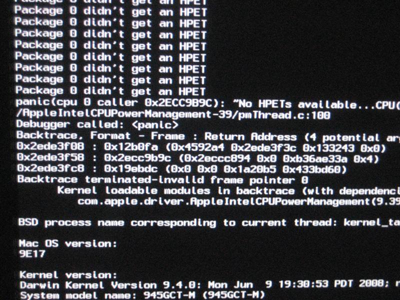

vyedmic Posted August 3, 2008 Share Posted August 3, 2008 So here are my errors. Any help would be great.Thanks Do you have the same problem when you boot from the 132DFE CD (with -f)? Link to comment https://www.insanelymac.com/forum/topic/113288-new-modified-boot-132-allows-you-to-boot-retail-dvds/page/19/#findComment-843661 Share on other sites More sharing options...

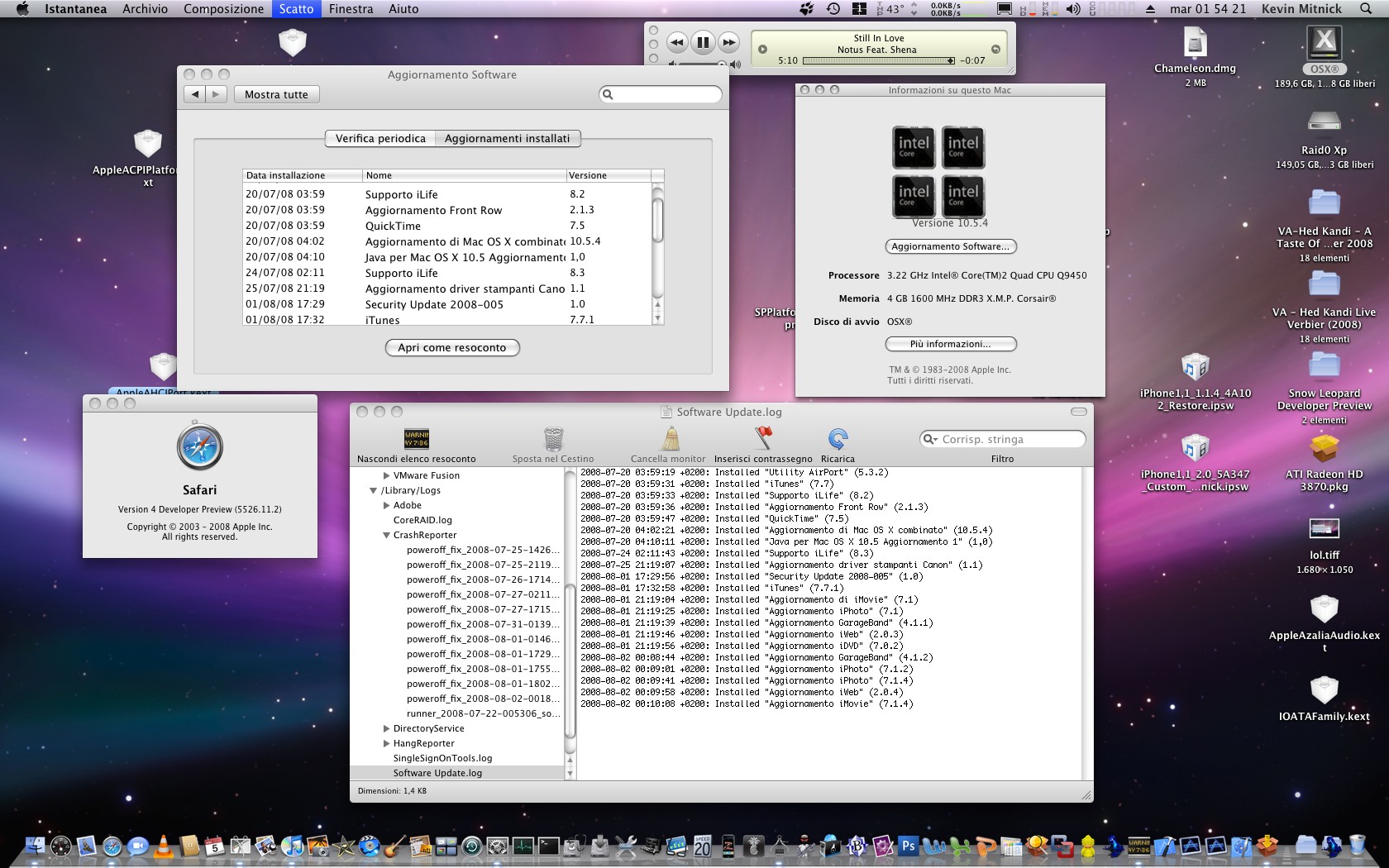

KevinMitnick Posted August 5, 2008 Share Posted August 5, 2008 More opinions? Results? Let's post what you thinkin' about this... Result : Boot in 25 sec power off,restart, sleep, work Hardware on signature Link to comment https://www.insanelymac.com/forum/topic/113288-new-modified-boot-132-allows-you-to-boot-retail-dvds/page/19/#findComment-845207 Share on other sites More sharing options...
bigpoppa206 Posted August 5, 2008 Share Posted August 5, 2008 So here are my errors. Any help would be great.Thanks Dude! I think you forgot to remove AppleIntelCPUPowerManagement.kext. Link to comment https://www.insanelymac.com/forum/topic/113288-new-modified-boot-132-allows-you-to-boot-retail-dvds/page/19/#findComment-845341 Share on other sites More sharing options...
surfer96822 Posted August 5, 2008 Share Posted August 5, 2008 Result : Boot in 25 sec power off,restart, sleep, work Hardware on signature Bravisimo! Very impressive box. My renders on fcp are fast i can only imagine yours must fly Link to comment https://www.insanelymac.com/forum/topic/113288-new-modified-boot-132-allows-you-to-boot-retail-dvds/page/19/#findComment-845442 Share on other sites More sharing options...

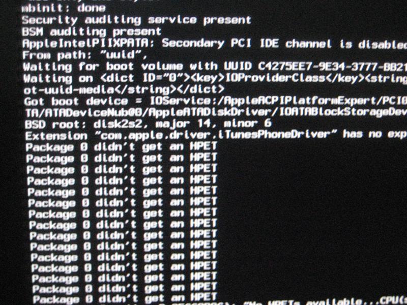

dhumlo Posted August 5, 2008 Share Posted August 5, 2008 So here are my errors. Any help would be great.Thanks So after doing a search on HPET, I found how to fix that problem here: http://forum.insanelymac.com/index.php?showtopic=74394 so after fixing that problem I bootup and now I get "still waiting for bood device" my question why did this happen. I installed everything fine but once I update to 10.5.4 is where I had issues. What happenned to my driver? thanks, d Link to comment https://www.insanelymac.com/forum/topic/113288-new-modified-boot-132-allows-you-to-boot-retail-dvds/page/19/#findComment-846025 Share on other sites More sharing options...

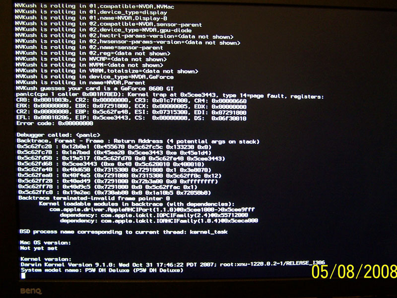

Santiago54321 Posted August 6, 2008 Share Posted August 6, 2008 Friends This is my problem installing the DVD Retaill. I must add some kext in cd de boot ? Link to comment https://www.insanelymac.com/forum/topic/113288-new-modified-boot-132-allows-you-to-boot-retail-dvds/page/19/#findComment-846447 Share on other sites More sharing options...
KevinMitnick Posted August 6, 2008 Share Posted August 6, 2008 Bravisimo! Very impressive box. My renders on fcp are fast i can only imagine yours must fly lol Friends This is my problem installing the DVD Retaill. I must add some kext in cd de boot ? Your Hardware spec? Link to comment https://www.insanelymac.com/forum/topic/113288-new-modified-boot-132-allows-you-to-boot-retail-dvds/page/19/#findComment-846462 Share on other sites More sharing options...
Santiago54321 Posted August 6, 2008 Share Posted August 6, 2008 P5W DH DELUXE DVD LG IDE HD SATA Link to comment https://www.insanelymac.com/forum/topic/113288-new-modified-boot-132-allows-you-to-boot-retail-dvds/page/19/#findComment-846476 Share on other sites More sharing options...
dodo Posted August 6, 2008 Share Posted August 6, 2008 Hi all i got problem Download .ISO Original with project kexts (all your need is here - noobs try this first): http://www.mediafire.com/?uwd9dtttjfk Quick resume about "oh, what to do now?" #1 - Burn .iso on a CD; #2 - Boot this CD; #3 - When Darwin prompt appear, eject CD and put Mac OS X Leopard Retail DVD; at this point i got this error System config file ' /com.apple.boot.S/Library/preferences/systemconfiguration/com.apple.boot.plist' not found #4 - Press enter (or -v and enter...wherever...) #5 - After install, boot using CD boot again and install .kext needed...and usual files. #6 - Done! Link to comment https://www.insanelymac.com/forum/topic/113288-new-modified-boot-132-allows-you-to-boot-retail-dvds/page/19/#findComment-846518 Share on other sites More sharing options...
chevy2410 Posted August 6, 2008 Share Posted August 6, 2008 Friends This is my problem installing the DVD Retaill. I must add some kext in cd de boot ? P5W DH DELUXE DVD LG IDE HD SATA It could be be your IDE dvd drive. Might be better off using an SATA drive. Chevy Link to comment https://www.insanelymac.com/forum/topic/113288-new-modified-boot-132-allows-you-to-boot-retail-dvds/page/19/#findComment-846573 Share on other sites More sharing options...
