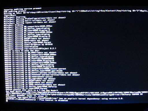

MACinized Posted August 19, 2008 Share Posted August 19, 2008 pardon me for not reading each & every post in this thread. able to boot w/ the retail leopard dvd but got stuck w/ the grey apple w/ "loading"indicator (boot screen). that means wasn't able to install. i have these in the boot-132 disc: ACPIPS2Nub.kext ALCinject.kext AppleACPIPlatform.kext AppleAHCIPort.kext AppleHDA.kext ApplePS2Controller.kext AppleSMBIOS.kext dsmos.kext IntelCPUPMDisabler.kext IOAHCIFamily.kext IOATAFamily.kext IONetworkingFamily.kext JMicronATA.kext NVinject.kext NVkush.kext SMBIOSEnabler.kext any advice pls.? tnx in advance. Link to comment https://www.insanelymac.com/forum/topic/113288-new-modified-boot-132-allows-you-to-boot-retail-dvds/page/21/#findComment-861111 Share on other sites More sharing options...

MACinized Posted August 19, 2008 Share Posted August 19, 2008 You can also try rebooting and hit -f at the prompt. That's what worked for me when I was stuck in that loop. i'd assume this is a reply for me. i'll give this a try. tnx. + + + + + tried it but still got stuck in that "boot screen". still didn't reach installation. tried it again but now in verbose mode. still got stuck & below is the pic: any other advice pls.? Link to comment https://www.insanelymac.com/forum/topic/113288-new-modified-boot-132-allows-you-to-boot-retail-dvds/page/21/#findComment-861303 Share on other sites More sharing options...
Foodie Monster Posted August 19, 2008 Share Posted August 19, 2008 i'd assume this is a reply for me. i'll give this a try. tnx.+ + + + + tried it but still got stuck in that "boot screen". still didn't reach installation. tried it again but now in verbose mode. still got stuck & below is the pic: any other advice pls.? The pic is broken, so we can't see it. What I'd recommend is that you try to make a new BOOT132 CD that has the bare minimum of things, and go from there. My suggestion would be to start with these 4 .kexts in the CD, and see if the bare minimum works. - ACPIPS2Nub.kext - dsmos.kext - IntelCPUDisabler.kext - SMBIOSEnabler.kext See if that works. Other than that, I'm fresh out of ideas. :S Link to comment https://www.insanelymac.com/forum/topic/113288-new-modified-boot-132-allows-you-to-boot-retail-dvds/page/21/#findComment-861637 Share on other sites More sharing options...
Jingu Posted August 19, 2008 Share Posted August 19, 2008 @MACinized Do you have any graphic kexts installed like NVinject, Natit or NVflusch? If you do, I suggest that you reuse your installation DVD and use terminal to remove the graphic kext. Once you can get to the desktop, then you can reinstall the graphic kext. Link to comment https://www.insanelymac.com/forum/topic/113288-new-modified-boot-132-allows-you-to-boot-retail-dvds/page/21/#findComment-861684 Share on other sites More sharing options...
BifBologna Posted August 19, 2008 Share Posted August 19, 2008 i'd assume this is a reply for me. i'll give this a try. tnx.+ + + + + tried it but still got stuck in that "boot screen". still didn't reach installation. tried it again but now in verbose mode. still got stuck & below is the pic: any other advice pls.? I'm kind of a newb, so I could be wrong (and it doesn't show it in your screenshot) but it sounds kinda like the system is stuck in "waiting for root device". I experienced that problem with a couple of different iso's when I tried them. The only way I could get past it was to enable AHCI in my BIOS. Bif Link to comment https://www.insanelymac.com/forum/topic/113288-new-modified-boot-132-allows-you-to-boot-retail-dvds/page/21/#findComment-861862 Share on other sites More sharing options...

MACinized Posted August 20, 2008 Share Posted August 20, 2008 The pic is broken, so we can't see it. What I'd recommend is that you try to make a new BOOT132 CD that has the bare minimum of things, and go from there. My suggestion would be to start with these 4 .kexts in the CD, and see if the bare minimum works. - ACPIPS2Nub.kext - dsmos.kext - IntelCPUDisabler.kext - SMBIOSEnabler.kext See if that works. Other than that, I'm fresh out of ideas. :S i believe i've tried having this kind of boot-132 disc already. same thing w/ the "generic.iso" that has so many files already in it. but since can't clearly remember, i guess it's still worth a try. will prepare a boot-132 disc w/ just these 4 kexts. hope there are some more ideas/help. tnx again Foodie Monster. Link to comment https://www.insanelymac.com/forum/topic/113288-new-modified-boot-132-allows-you-to-boot-retail-dvds/page/21/#findComment-862265 Share on other sites More sharing options...
