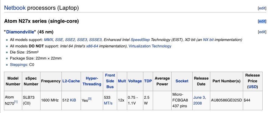

Acid_Burn Posted December 21, 2008 Share Posted December 21, 2008 system profiler reports just 1 core (instead of the 2 logical cores under 10.5.5) and Quartz Extreme is not supported.Are there any solutions for that? The Atom CPU in the MSI Wind and Akoya has a Atom CPU with 1 Core. With HT (Hyper Threading) have the Atom CPU 2 virtual Core but 1 real Core. Link to comment https://www.insanelymac.com/forum/topic/113018-os-x-on-the-msi-wind-before-its-released/page/25/#findComment-1008092 Share on other sites More sharing options...

Acid_Burn Posted December 21, 2008 Share Posted December 21, 2008 Check Activity Monitor - it should show 2 logical cores. Otherwise something is wrong. The Screenshot is from Wikipedia Link to comment https://www.insanelymac.com/forum/topic/113018-os-x-on-the-msi-wind-before-its-released/page/25/#findComment-1008647 Share on other sites More sharing options...
