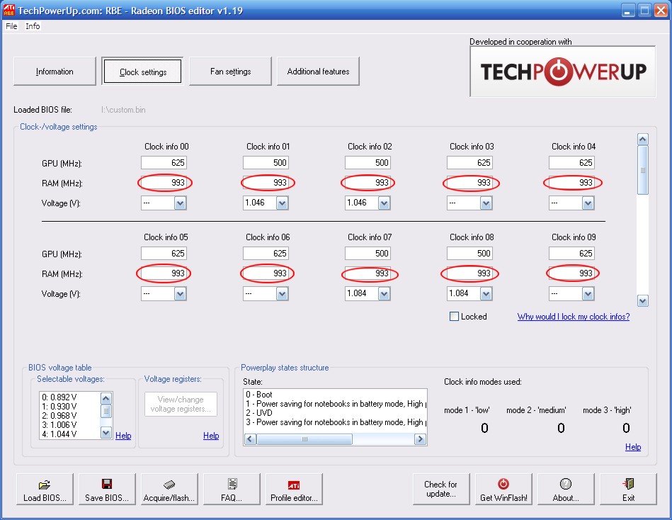

Majito Posted February 28, 2009 Share Posted February 28, 2009 I FOUND THE SOLUTION FOR THE SCREEN BOUNCING/JERKING FOR 4850 After trying many bioses I found the problem is on the clock settings, the memory must be the same speed in all settings, I found this using RBE and looking at the sapphire BIOS and the 4870 stock, so I put the same speed (993 MHz for memory clock) and it works!, this fix the kernel panic with the sapphire bios, and fixes sleep and resolution change. You still need to use the DVIVGA adapter. Here is the BIOS I use ATI4850custom.zip is for reference card so it should work for any 4850, or you can try editing your videocard bios with RBE Be careful when flashing your card, I'm not responsible for any damage to your card. Posible solutions for screen jerking Solution 1. I flash my visiontek 4850 videocard with the lastest sapphire BIOS and the jerking is gone, but now I have kernel panic on sleep and shutdown, also the screen goes blue on resolution change. Solution 2. Only install natit.kext and ATIRadeonX2000.kext, this way yo dont get QE/CI, but you get display reconized, the jerking is gone and u can use native resolution. This is the link for the BIOS http://www.techpowerup.com/vgabios/20721/S...512.080723.html Any ideas for kernel panic? Link to comment https://www.insanelymac.com/forum/topic/112228-what-about-the-new-ati-hd4850/page/29/#findComment-1094591 Share on other sites More sharing options...

johnniecarcinogen Posted March 1, 2009 Share Posted March 1, 2009 I FOUND THE SOLUTION FOR THE SCREEN BOUNCING/JERKING FOR 4850 After trying many bioses I found the problem is on the clock settings, the memory must be the same speed in all settings, I found this using RBE and looking at the sapphire BIOS and the 4870 stock, so I put the same speed (993 MHz for memory clock) and it works!, this fix the kernel panic with the sapphire bios, and fixes sleep and resolution change. You still need to use the DVIVGA adapter. Here is the BIOS I use ATI4850custom.zip is for reference card so it should work for any 4850, or you can try editing your videocard bios with RBE Be careful when flashing your card, I'm not responsible for any damage to your card. I Have an asus EAH4850 and flashed the sapphire 4850 bios and it did get rid of the bounces but I still have a short freeze when a 'bump' would usually occur. Your custom bios works also but I still get the short freeze and a lower fan speed but no kernel panic when shutting down. Link to comment https://www.insanelymac.com/forum/topic/112228-what-about-the-new-ati-hd4850/page/29/#findComment-1094616 Share on other sites More sharing options...
skypete Posted March 1, 2009 Share Posted March 1, 2009 Ok i got mine to work. AFter you have install pkg and framework. Try reinstalling pkg, then shutdown! and reboot with -f. This worked for me QE/CI smoothness i followed your directions and it still does the same i have a msi 4850 video card is there any other way to make the screen stop bouncing. Link to comment https://www.insanelymac.com/forum/topic/112228-what-about-the-new-ati-hd4850/page/29/#findComment-1094625 Share on other sites More sharing options...
Majito Posted March 1, 2009 Share Posted March 1, 2009 I Have an asus EAH4850 and flashed the sapphire 4850 bios and it did get rid of the bounces but I still have a short freeze when a 'bump' would usually occur. Your custom bios works also but I still get the short freeze and a lower fan speed but no kernel panic when shutting down. The kernel panic has something to do with the clock settings on the sapphire bios, try to edit your videocard BIOS and just change the memory clock to the same speed. Link to comment https://www.insanelymac.com/forum/topic/112228-what-about-the-new-ati-hd4850/page/29/#findComment-1094629 Share on other sites More sharing options...
Mitch193 Posted March 1, 2009 Share Posted March 1, 2009 I FOUND THE SOLUTION FOR THE SCREEN BOUNCING/JERKING FOR 4850 After trying many bioses I found the problem is on the clock settings, the memory must be the same speed in all settings, I found this using RBE and looking at the sapphire BIOS and the 4870 stock, so I put the same speed (993 MHz for memory clock) and it works!, this fix the kernel panic with the sapphire bios, and fixes sleep and resolution change. You still need to use the DVIVGA adapter. Here is the BIOS I use ATI4850custom.zip is for reference card so it should work for any 4850, or you can try editing your videocard bios with RBE Be careful when flashing your card, I'm not responsible for any damage to your card. What would we have to do to get this fix for the 4870, eg change a setting? Link to comment https://www.insanelymac.com/forum/topic/112228-what-about-the-new-ati-hd4850/page/29/#findComment-1094633 Share on other sites More sharing options...
Majito Posted March 1, 2009 Share Posted March 1, 2009 What would we have to do to get this fix for the 4870, eg change a setting? Just edit your videocard BIOS with RBE and use the same memory clock settings in all memory fields, I think is 900MHz for the 4870 WARNING: The 993 value is only for 4850, if you have a 4870 use 900. Also using the stock reference bios for the 4870 should work too http://www.techpowerup.com/vgabios/17578/A...512.080617.html Link to comment https://www.insanelymac.com/forum/topic/112228-what-about-the-new-ati-hd4850/page/29/#findComment-1094643 Share on other sites More sharing options...
johnniecarcinogen Posted March 1, 2009 Share Posted March 1, 2009 Just edit your videocard BIOS with RBE and use the same memory clock settings in all memory fields, I think is 900MHz for the 4870 Also using the stock reference bios for the 4870 should work too http://www.techpowerup.com/vgabios/17578/A...512.080617.html I changed the memory speed to all 993 and it stopped the bouncing and the fan works great but i still get a freeze every 5-10 seconds. Do you get this too? Link to comment https://www.insanelymac.com/forum/topic/112228-what-about-the-new-ati-hd4850/page/29/#findComment-1094666 Share on other sites More sharing options...

Sabr Posted March 1, 2009 Share Posted March 1, 2009 I can confirm our previous suspicions of memory clock speeds being the culprit for the jerk/bounce effect. I've edited my card's BIOS to have a memory clock speed of 993MHz and all is working fine. I changed the memory speed to all 993 and it stopped the bouncing and the fan works great but i still get a freeze every 5-10 seconds. Do you get this too? Swap your ports around. That fixed it for me. Link to comment https://www.insanelymac.com/forum/topic/112228-what-about-the-new-ati-hd4850/page/29/#findComment-1094672 Share on other sites More sharing options...
skypete Posted March 1, 2009 Share Posted March 1, 2009 I changed the memory speed to all 993 and it stopped the bouncing and the fan works great but i still get a freeze every 5-10 seconds. Do you get this too? i just did hte same updated the bios but i get a freeze every 5- 10 seconds as well also want to mention was updateed aon a msi 4850 Link to comment https://www.insanelymac.com/forum/topic/112228-what-about-the-new-ati-hd4850/page/29/#findComment-1094673 Share on other sites More sharing options...

Majito Posted March 1, 2009 Share Posted March 1, 2009 WARNING!!! PLEASE READ!!! WRONG SETTINGS CAN KILL YOUR CARD I changed the memory speed to all 993 and it stopped the bouncing and the fan works great but i still get a freeze every 5-10 seconds. Do you get this too? BE CAREFUL!!! if your card is 4870 yo have to set the speed to 900MHz, the 993 value is just for 4850, maybe thats why you are getting freezes Those who are getting freezes every few seconds: Please try swapping your cables around: So the VGA converter (not hooked up to monitor) is in the one closest to motherboard, and the DVI cable in the other one (hooked up to monitor). EDIT: Is anyone getting artifacts after flashing their BIOS to 993MHz? Like this: WARNING!!! if your card is 4870 yo have to set the speed to 900MHz, the 993 value is just for 4850, maybe thats why you are getting artifacts Link to comment https://www.insanelymac.com/forum/topic/112228-what-about-the-new-ati-hd4850/page/29/#findComment-1094711 Share on other sites More sharing options...
keypox Posted March 1, 2009 Share Posted March 1, 2009 Just edit your videocard BIOS with RBE and use the same memory clock settings in all memory fields, I think is 900MHz for the 4870 WARNING: The 993 value is only for 4850, if you have a 4870 use 900. Also using the stock reference bios for the 4870 should work too http://www.techpowerup.com/vgabios/17578/A...512.080617.html Editing the bios of your video card is a bit extreme. I think maybe wait till proper kexts come. Prob wont be that long. But i may try this lol. Link to comment https://www.insanelymac.com/forum/topic/112228-what-about-the-new-ati-hd4850/page/29/#findComment-1094729 Share on other sites More sharing options...
