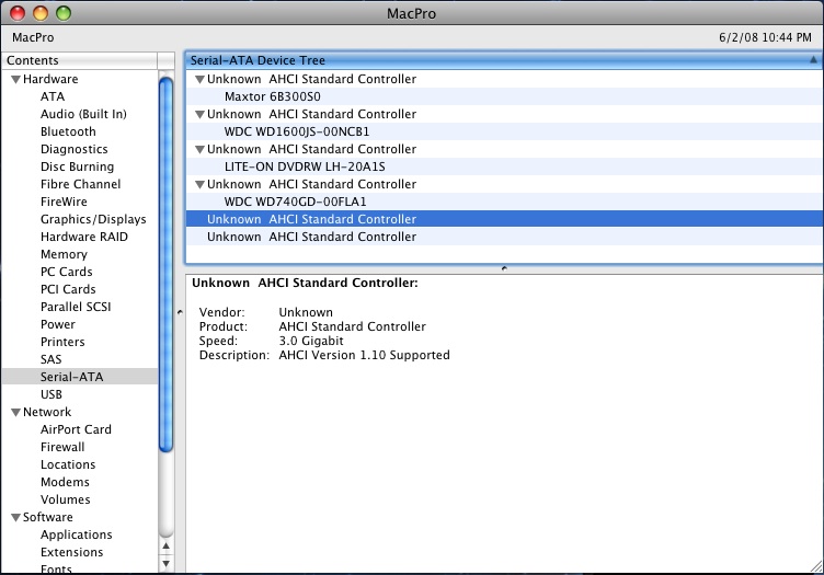

Yea why? It use to say it just fine in 10.5.2
this whole unknown ahci thread/fix is for ICH only ! You could modify that plist all you want it will still say unknown
Sorry
Edit : post a screenshot of dcpi manager
