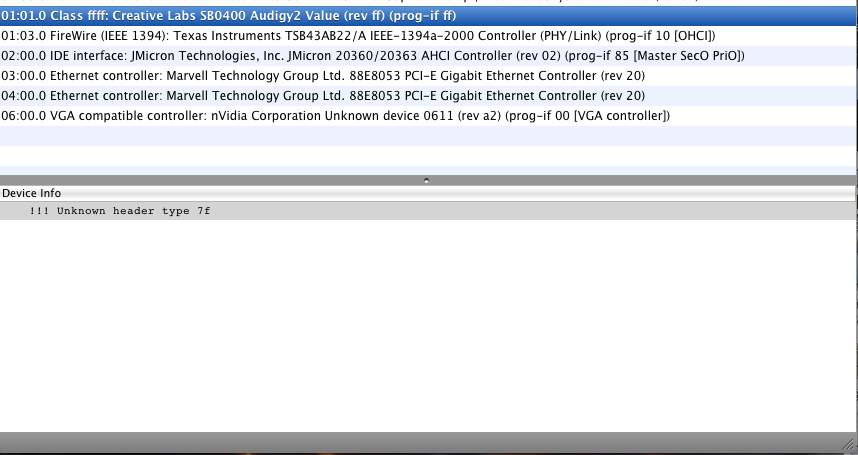

Help me?
Aug 18 21:41:45 localhost kernel[0]: kXAudioDevice[0x6c99000]::initHardware(0x639c280)
Aug 18 21:41:45 localhost kernel[0]: kXAudioDevice[0x6c99000]::initHardware: bus/dev/func: 1/1/0; device/subsys/chip: ffffffff:ffffffff:ffffffff - at port fffe
Aug 18 21:41:45 localhost kernel[0]: kXAudioDevice[0x6c99000]::initHardware: I/O range @0x10 (00008880) mapped into 70c4b880 [up to 72c4b8bf]
Aug 18 21:41:45 localhost kernel[0]: kXAudioDevice [HAL] --- kX Software Abstraction Level Library init ---
Aug 18 21:41:45 localhost kernel[0]: kX Audio Driver (Debug)
Aug 18 21:41:45 localhost kernel[0]: version: 5.10.00.3545 - debug
Aug 18 21:41:45 localhost kernel[0]: Copyright � Eugene Gavrilov, 2001-2008. All rights reserved.
Aug 18 21:41:45 localhost kernel[0]: Library Compiled Aug 15 2008, 17:51:22
Aug 18 21:41:45 localhost ifcstart[25]: _CFGetHostUUIDString: unable to determine UUID for host. Error: 35
Aug 18 21:41:45 localhost kernel[0]: kXAudioDevice [HAL] PCI: bad device/subsys supplied [ffffffff]
Aug 18 21:41:45 niko org.ntp.ntpd[14]: Error : nodename nor servname provided, or not known
Aug 18 21:41:45 niko backupd-helper[86]: _CFGetHostUUIDString: unable to determine UUID for host. Error: 35
Aug 18 21:41:45 niko kernel[0]: kXAudioDevice [HAL] !!! PCI init failed
Aug 18 21:41:45 niko configd[34]: _CFGetHostUUIDString: unable to determine UUID for host. Error: 35
Aug 18 21:41:45 niko kernel[0]: kXAudioDevice[0x6c99000]::init: failed [3]
Aug 18 21:41:45 niko kernel[0]: kXAudioDevice [HAL] !!! dsp_clear() w/o being inited
Aug 18 21:41:45 niko kernel[0]: kXAudioDevice [ERROR] error in bufmgr_close [invalid blocks found]
Aug 18 21:41:45 niko kernel[0]: kXAudioDevice [HAL] --- Library done ---
Aug 18 21:41:45 niko kernel[0]: kXAudioDevice[0x6c99000]::free()
Aug 18 21:41:45 niko kernel[0]: kXAudioDevice[0x6c99000]::free_all() - iKX interface already closed

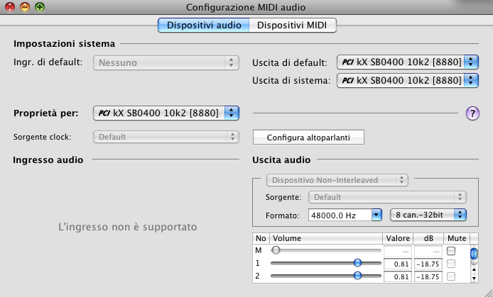

My bug-list (AMD x64 + KALYWAY 10.5.3 + Audigy + kX 1.0b3 drivers ):
1. After 5 to 15 minutes, sound starts distorting
(it's not only Audigy 2 bug as mentioned in first post)
Sound is clear when OS X just started but distortion grows constantly... and after 10 minutes I can hear only distortion :(

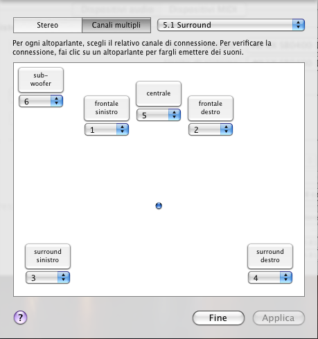

6. Stereo files won't play from Front Center, Rear Left and Rear Right (Please confirm this everyone)
True.

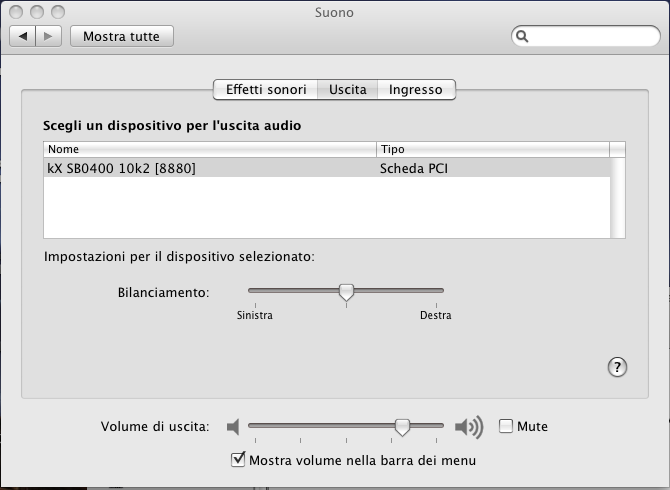

I've configured my 5.1 system but can hear only stereo-sound from iTunes.
Also i can configure output leveling only for channels 1 and 2. Channels #3,4,5,6,7,8 are greyed.
7. Default Multichannel (5.1) settings are wrong for Front Center, Rear Left, Rear Right, and Woofer (Please Confirm)
Settings were wrong in 1.0b2. I cant say something about 1.0b3 cause my reconfigured settings seems been saved some way from 1.0b2.
Also in channel configuration i can hear only "Sssss" sound when i press test button. I think there should be some "normal" sounds, souldn't they?
