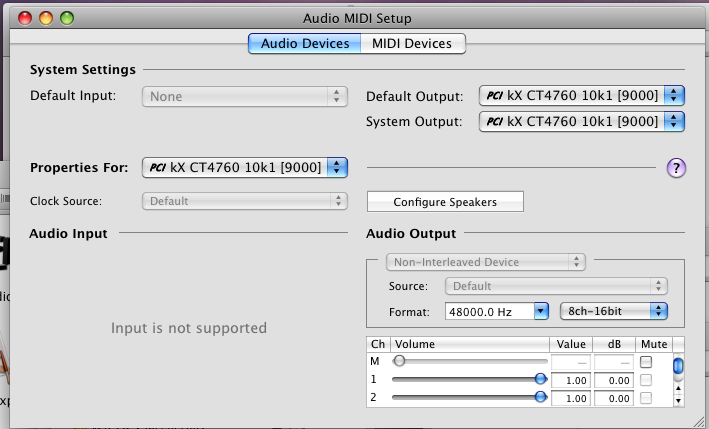

Riley Freeman Posted August 12, 2008 Share Posted August 12, 2008 I've restarted after changing the speaker setup but still no dice. I did notice this in Audio MIDI Setup though. Looks like the master volume is set to 0 and not selectable. Can you check yours and see if it looks like this? Link to comment https://www.insanelymac.com/forum/topic/104797-creative-sb-live-audigy-audigy2-emu10kx-edsps-osx-driver-info-here/page/4/#findComment-854498 Share on other sites More sharing options...
Riley Freeman Posted August 12, 2008 Share Posted August 12, 2008 Mine is same, now when you click on Configure Speakers, Select 5.1 and (from behind of audio card) swap the wires from Left and Right TO Rear Left and REAR right... and see if works or not (oh yes don't forget your favorite restart...lol) The thing is, this isn't a 5.1 card. I only have a stereo jack for output. No front/rear etc. It's just a basic SB Live Value. It's great these drivers came out so quick. I hope I don't sound impatient or anything. It's just that I'm also juggling ethernet and speedstep issues at the same time Link to comment https://www.insanelymac.com/forum/topic/104797-creative-sb-live-audigy-audigy2-emu10kx-edsps-osx-driver-info-here/page/4/#findComment-854509 Share on other sites More sharing options...

Riley Freeman Posted August 12, 2008 Share Posted August 12, 2008 OK I got it at last! Just selected stereo in speaker setup and set left speaker to channel 3 and right to 4 (in all my frantic clicking I didn't read that you can click on the speaker icon to hear a test sound. duh...). I get sound but it degrades within a couple of minutes. Still, that's a known bug right now. But it works! Link to comment https://www.insanelymac.com/forum/topic/104797-creative-sb-live-audigy-audigy2-emu10kx-edsps-osx-driver-info-here/page/4/#findComment-854545 Share on other sites More sharing options...

newbmac Posted August 12, 2008 Share Posted August 12, 2008 Sound from all 5.1 speakers after setting in Audio Midi Setup! I tried changing the channels to direct the sound in the Audio Midi Setup for speakers from the rear to the front For my Soundblaster Audigy 2 ZS the following are the speaker channel mappings Left Front 3 Right Front 4 Center 5 Left Rear 1 Right Rear 2 Subwoofer 6 Link to comment https://www.insanelymac.com/forum/topic/104797-creative-sb-live-audigy-audigy2-emu10kx-edsps-osx-driver-info-here/page/4/#findComment-854589 Share on other sites More sharing options...

Riley Freeman Posted August 12, 2008 Share Posted August 12, 2008 Ah yes, to save yourselves from Restarts Hagar pointed out a temp solution OPEN TERMINAL and type the following (which should give you another 10 minutes.... lol) sudo -s (password) kextunload /System/Library/Extensions/kXAudioDriver.kext (if at this point it says "failed" just repeat the command above) kextload /System/Library/Extensions/kXAudioDriver.kext Thanks. But on further testing it starts degrading after exactly 1 minute, so for now it really can't be used. Link to comment https://www.insanelymac.com/forum/topic/104797-creative-sb-live-audigy-audigy2-emu10kx-edsps-osx-driver-info-here/page/4/#findComment-854606 Share on other sites More sharing options...
newbmac Posted August 12, 2008 Share Posted August 12, 2008 Yup, I've mentioned it at DH's bug report page but the thing is that after you reboot, it will not sound from all speakers (only the rear ones) Works great for me. I actually had to restart to get it all to work. For Stereo speaker settings I also switched the channels there so now the sound comes from my front speakers WITHOUT having to change my cabling. I also fixed it for MultiChannel 5.1 so it plays the correct channels from each 5.1 speaker. Front Left 5 Front Right 6 Listening to itunes from my front speakers now, not from back which I assume is correct as this is stereo music and not surround songs. Thanks. But on further testing it starts degrading after exactly 1 minute, so for now it really can't be used. Well I don't have your sound card. What I had to do: First adjust in Audio Midi Setup the settings for the speaker channels. Then restart and at restart I did a -f -v System sound for Adium came from 5.1 and listening to itunes perfectly right now from 2.1 Link to comment https://www.insanelymac.com/forum/topic/104797-creative-sb-live-audigy-audigy2-emu10kx-edsps-osx-driver-info-here/page/4/#findComment-854607 Share on other sites More sharing options...
newbmac Posted August 12, 2008 Share Posted August 12, 2008 Ok, just CONFIRMED. I restarted and OS X kept all my speaker settings. If you are not keeping settings, make sure you restart after adjusting the speaker channels and do a -f -v boot. Going to leave the music playing to see if sound goes .... BUG: Sound volume adjustment slider does not work on the apple desktop but does work in iTunes Link to comment https://www.insanelymac.com/forum/topic/104797-creative-sb-live-audigy-audigy2-emu10kx-edsps-osx-driver-info-here/page/4/#findComment-854618 Share on other sites More sharing options...
newbmac Posted August 12, 2008 Share Posted August 12, 2008 I've Audigy 2 ZS and OSX does keep the settings (it just doesn't play from front L&R after reboot and continues to play from rear) I've done that channel mapping long back... Did you do the chanel mapping for both multichannel and stereo tabs in the Midi Utility? Well, the sound degrades for me. I just stopped itunes and came back to start it 5 minutes later, sound is all garbled coming out Link to comment https://www.insanelymac.com/forum/topic/104797-creative-sb-live-audigy-audigy2-emu10kx-edsps-osx-driver-info-here/page/4/#findComment-854627 Share on other sites More sharing options...
