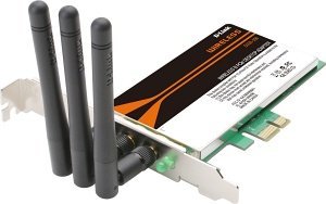

About This File
Please read me:
Ever since macOS Mojave came out (I mean the first DP) Apple removed the support for Atheros based WiFi Adapters from the IO80211Family.kext, so to fix it we need to add the AirPortAtheros40.kext to the Extensions manually.
After each clean install the AirPortAtheros40.kext needs to be installed and after clean installing Mojave DPs after few times I decides to create this app to save some time.
How to use it:
This application will install the missing AirPortAtheros40.kext into /System/Library/Extensions and after the installation is done and once you reboot your computer the Atheros based WiFi adapters will be enabled.
The installation is the first step of the process and it is fast but the next steps which are repairing the permission on /System/Library/Extensions and rebuilding the system caches might take a while so please wait until you were asked to reboot your computer.

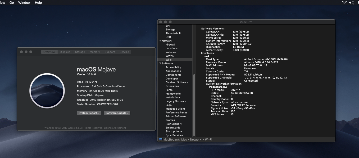

I'm using a TP-Link WDN4800 with an Atheros chipset and it works on other similar hardware.
If this app helped you please consider donating; any amount is appreciated.
Screen Shot 2019-06-09 at 7.49.52 PM.pngScreen Shot 2019-06-09 at 7.49.22 PM.png
Screen Shot 2018-09-16 at 4.40.43 PM.PNGScreen Shot 2018-09-16 at 4.43.28 PM.PNG
1680545780_ScreenShot2018-09-16at4_43_07PM.PNG.059f2ac981e9580873d85f97a2504e72.PNGScreen Shot 2018-09-16 at 4.53.37 PM.PNG

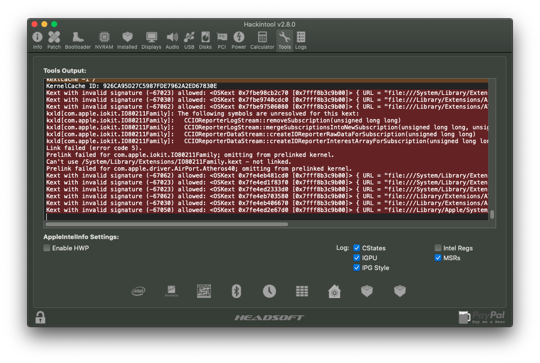

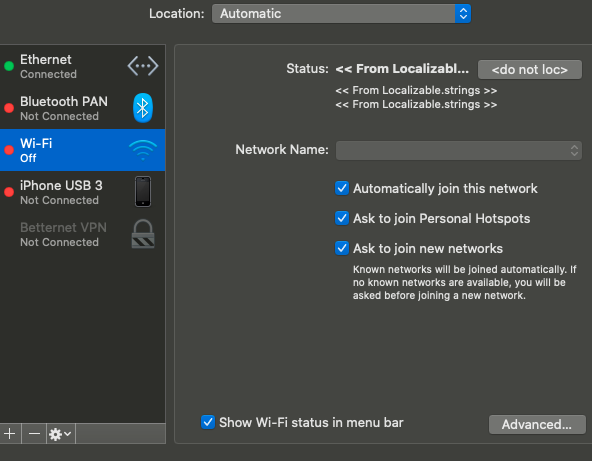

 it didn't work for me for some reason i dont know ! and showing me some localizable strings in AR9565
and here is error made when installing IO80211Family.kext on catalina
Edited by eissomeoe
  • Confused 1
I have the same problem on Catalina 10.15.4. Is there any solution?
dodo
Posted
i have the same issue on opencore AMD mackintosh 10.15.5
