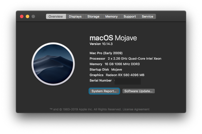

The installer should work fine under macOS 10.14.3 I just ran a test and everything worked just fine. About the SIP you don't have to disable it from recovery mode just use the CsrActiveConfig=0x67 under the Rt Variables in your config.plist to disable SIP. Once you changed the CsrActiveConfig to 0x67 reboot the macOS and the run the installer. If you still have the issues post some screenshots from the errors you are getting so I can see what's going on.

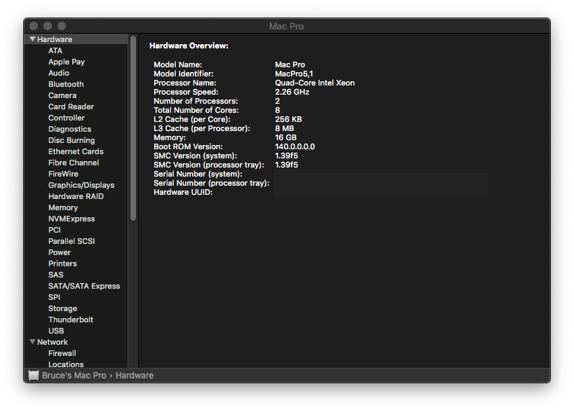

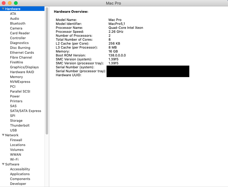

I’ll try this again in a moment. I had noticed I was on Boot Rom 138.0.0.0.0. So I updated it to 140.0.0.0.0. Do you think that could’ve been the issue?
No I don't think that's the issue but you can update the SMBIOS section in the config.plist to update the ROM version however the most important thing is that to fix permissions and update the kext cache correctly and see if that resolves the issue.
The installer does the permission fix and the kext cache update but use Mac Optimizer app's "Rebuild System Caches" and see if that helps.

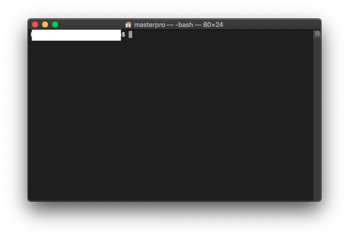

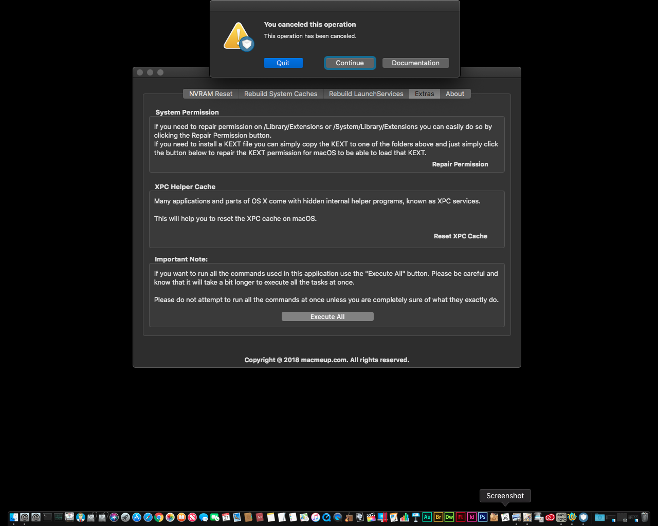

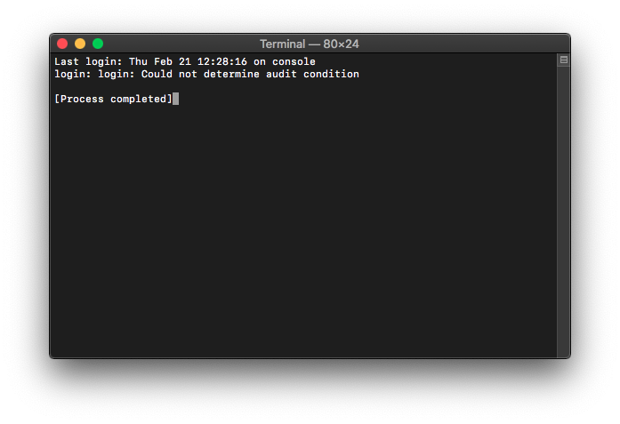

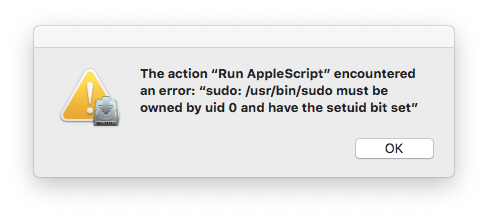

The issues I started having with Terminal and reinstalling an application NOT related to the AirPortAtheros40.kext installer. When I installed AirportAtheros40.kext installer, the Reboot did not work. So I then tried Mac Optimizer and that failed.
The installer stopped and provided error messages. I added the screen capture. Then there’s the problem I now have with Terminal after logging back into my user account. Only after removing “login” from usr/bin am I able to use Terminal again.
