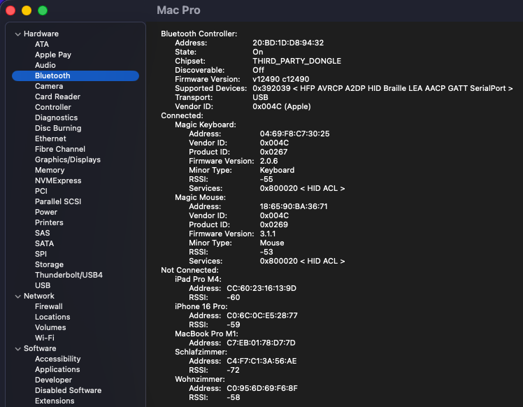

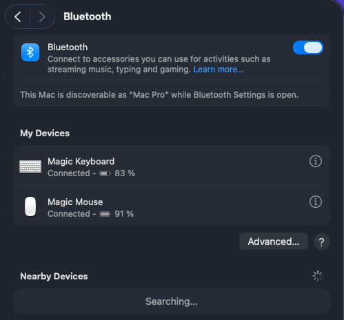

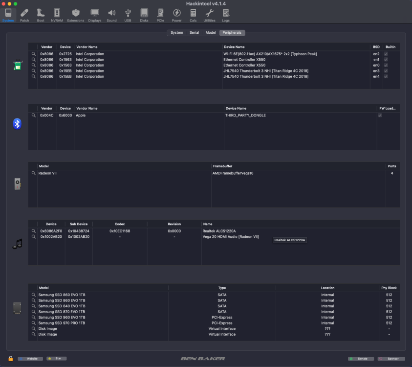

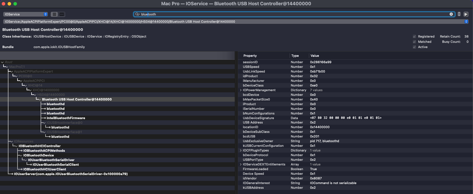

The latest IntelBluetoothFirmware v2.5.1, released by lshbluesky, has now been successfully tested under macOS Tahoe 26.5.2 and macOS Tahoe 26.6 beta 3. Release: https://github.com/lshbluesky/IntelBluetoothFirmware/releases/tag/v2.5.1 IntelBluetoothFirmware v2.5.1 incorporates the Bluetooth LE fixes for macOS Tahoe 26.5 originally developed by Z3c0ld and Vinhts, while additionally updating the Intel Bluetooth firmware files for all currently supported Intel wireless chipsets. Successfully tested with: Intel AX210 (Wi-Fi 6 / Bluetooth 5.3) — tested by myself Intel AX201 CNVW — tested by beelzebozo Current results: Wi-Fi fully functional Bluetooth controller detected correctly Bluetooth pairing functional Bluetooth connections functional Automatic Bluetooth reconnection after boot working correctly Sleep/Wake working correctly Magic Keyboard and Magic Mouse working correctly AirPlay functional Screen Mirroring functional Handoff functional LinkQuality = 100 No issues observed during initial testing Intel BE200 has not yet been re-tested with IntelBluetoothFirmware v2.5.1. Previous testing indicates that Bluetooth works correctly, while Wi-Fi functionality remains incomplete and is still under investigation. The current AWDL situation remains unchanged. The awdl0 interface is still not being created, leaving the following AWDL-dependent functionality currently unavailable on Intel Wi-Fi under macOS Tahoe: AirDrop Personal Hotspot Continuity Camera Current AWDL investigations: https://github.com/OpenIntelWireless/itlwm/issues/1062 Many thanks to lshbluesky for maintaining IntelBluetoothFirmware and to Z3c0ld and Vinhts for their excellent work on the Tahoe Bluetooth LE fixes for macOS Tahoe 26.5.
