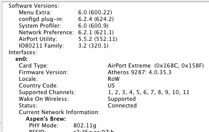

sparkythewondersquid Posted June 8, 2011 Share Posted June 8, 2011 How about the atheros 9287 driver can it be ported somehow (assuming that's how other drivers originated to osx86) This one works for mine http://www.kexts.com/view/1225-io80211fami...r5b97_wifi.html and you do not have to use the kernel they suggest works for me on Lion and Snow Link to comment Share on other sites More sharing options...

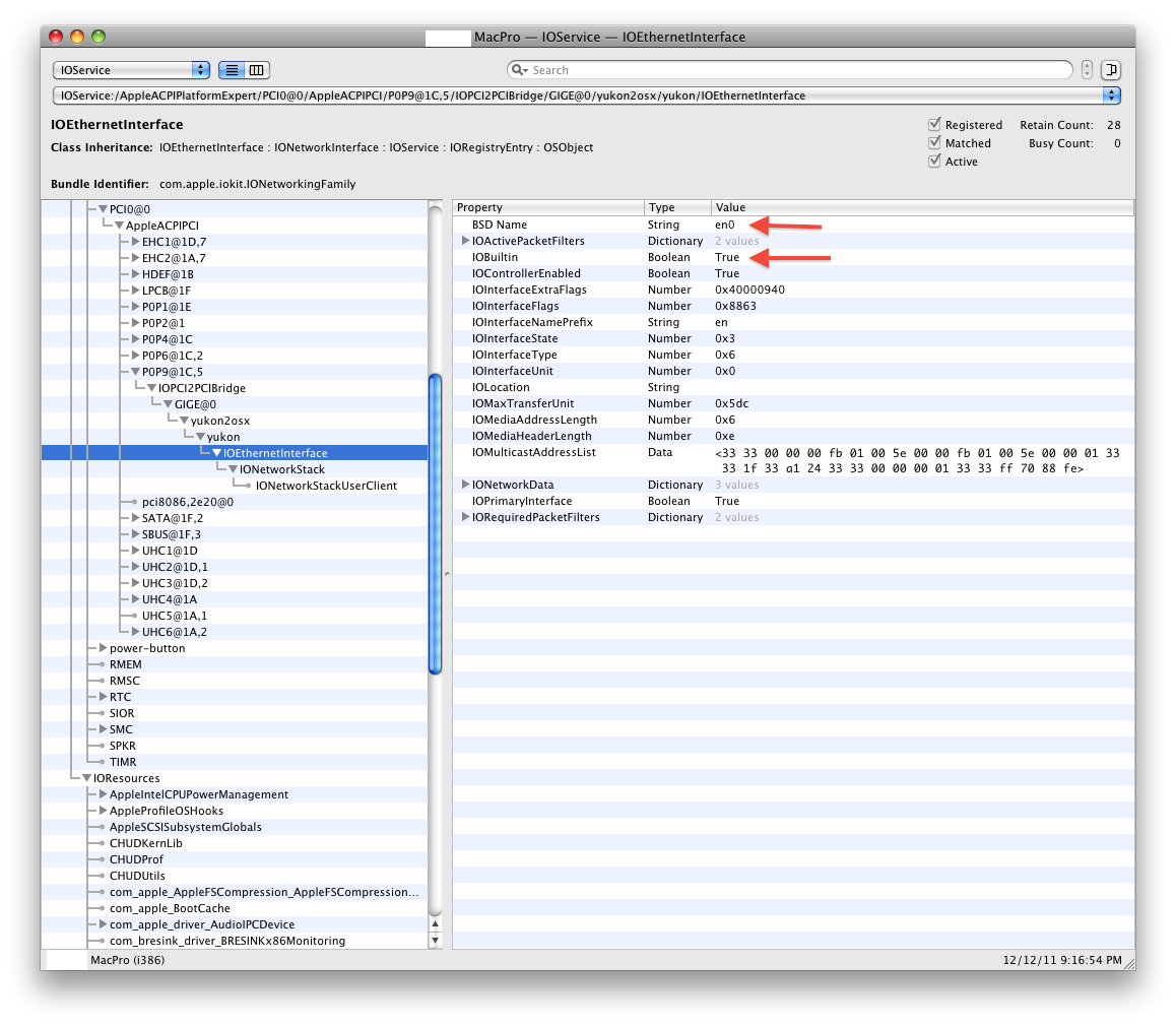

Gringo Vermelho Posted December 12, 2011 Share Posted December 12, 2011 Try this driver for your wired ethernet: http://lnx2mac.blogs...osx-driver.html This is important even if you're not going to use it, many apps (both Apple and 3rd party) and even some games require the presence of built-in ethernet for authentication and registration purposes. Some software will refuse to install without it. Wired ethernet doesn't have to be active in Network preferences for this to work properly but it must be seen as "EN0", built-in, and have a driver loaded for it. I think your Atheros wireless can be made to work by adding its device ID to AirportAtheros.kext inside IO80211Family.kext. Google "AirportAtheros.kext 168c:0013" (no quotes) for directions. Get the wired ethernet going first, it's one of the cornerstones of a compatible Hackintosh. Here's an IORegistryExplorer screenshot so you can see what it's supposed to look like (Asus P5Q-E, Marvell Yukon 88E8056). Link to comment Share on other sites More sharing options...
Shunnabunich Posted December 13, 2011 Share Posted December 13, 2011 Haha, you just got done helping my sorry ass with the other thing, and here you are. You're awesome. I installed the ethernet kext you linked to (a kext with its own installer package?! My god, the luxury!), but it didn't seem to have any effect. Taking another look at the information provided with the kext, it seems to add support for RTL8111x and RTL8168x chips, while my board apparently uses an RTL8101E. I'll look around for that soon. Edit: This kext did the trick. I then ran the search you recommended, and one of the results was another thread on this forum. I tried what was described there, removing the <string>pci168c,13</string> from the plist in AirportAtheros.kext and adding it to the corresponding plist in AirportAtheros21.kext. (Embarrassingly, I'd tried adding the string to the latter, but hadn't tried also removing it from the former.) Bottom line: wi-fi is now working flawlessly, and I've already had a Mac App Store app (Moom) start up on login without raising a fuss. Still no ethernet, but everything seems to be running fine so far anyway. Thanks yet again! 1 Link to comment Share on other sites More sharing options...
Gringo Vermelho Posted December 13, 2011 Share Posted December 13, 2011 Great but there's a problem with solving it that way - replacing the whole IONetworkingFamily.kext means that you're likely to lose wired ethernet next time Apple updates that kernel extension. That goes for the AirportAtheros kexts as well. Inside IONetworkingFamily.kext is a plugins folder. One of the kexts in that folder is the driver for your wired Realtek ethernet. Find out if you can use this modified Realtek "plugin" kext with an unmodified IONetworkingFamily.kext from the same version of Lion that you are running now. Hopefully you kept a backup. To prevent an OS update from reverting our modifications, we can (not in all cases though) make our own "Legacy Kext" or "plist-only kext". Besides preventing loss of functionality, this method is preferred because it allows you to use the latest drivers. Quote from Hagar: "Plist-only" or "Legacy" kexts consist of an empty kext with just the Info.plist inside. The object of this is to add to or override the values in the main kext that is being loaded by the system. typically this will add device IDs or similar values to allow the kext to load with hardware other than that which it was intended for, but crucially *without* modifying the original kext itself, so that functionality will not be lost in the event of an update. If your modifications (as is the case with the Atheros edits) consist solely of adding or replacing device IDs, this method will work for you. There are guides on how to make your own legacy kexts both here and on the ProjectOSX forums. As a study object, you could find and download "AppleYukon2Legacy.kext" and compare it to the original AppleYukon2.kext. It works by replacing the name and device IDs for the Marvell Yukon 88E8053 with those of the 88E8056, and upping a version number so that it loads first, overriding the original. /EDIT - I knew it..here's the topic I had a vague memory of: http://www.insanelymac.com/forum/index.php?showtopic=157881 If you're lucky, someone has already made an Atheros21 legacy kext and uploaded it somewhere. About the wired ethernet, you will have to find out what modification has been made to the IONetworkingFamily.kext you have downloaded - if there's a modified Realtek driver inside its plugins folder or if it's just a plist edit to a driver that already ships with OS X. Compare the modified one with a clean one. Some "plugins" can exist outside of their "family" kext in /System/Library/Extensions. But, if you place it there, and the one inside IONetworkingFamily.kext gets updated by Apple, the new one will load because it has a higher version number. You can get around this issue by setting a ridiculously high version number like 9.9.9 in the info.plist of your modified kext. Good luck and sorry I can't be more specific - the bits I didn't explain are out there if you look for them. 1 Link to comment Share on other sites More sharing options...
