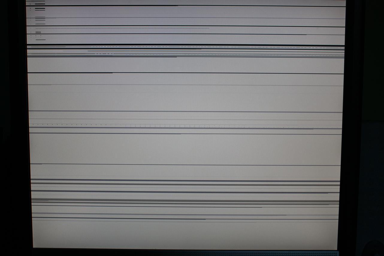

Stiruam Posted July 25, 2008 Share Posted July 25, 2008 Well its not working for my Club3D HD 3850 512MB OC Edition... I am getting "The Disco Screen of Death" (lol) So could somebody give me a fast tutorial? Cuz i just pressed install and rebooted... I really hate it because i bought this videocard because i thought it would work with dvi and my old HD 2400 pro didn't... Thanx & Greetz, Stiruam Edit: ill try http://forum.insanelymac.com/index.php?showtopic=94090 asap Link to comment Share on other sites More sharing options...

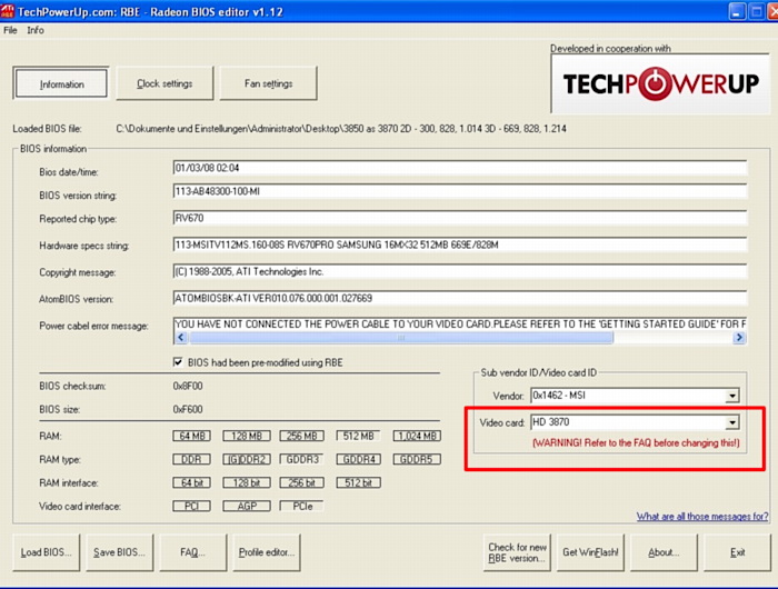

mitch_de Posted August 2, 2008 Share Posted August 2, 2008 Hello, Finally I read about this BIOS thing... So I switched to Windows XP and had a look at the ATI Catalyst Control Center. It said that the date of the BIOS is from 11th June 2008. So I thought, that maybe an older BIOS could do the job. I flashed the BIOS with an older version and now I´m happy: Leopard boots, all resolutions work, quartz and core are fine. Today I wanted to give the new BIOS version another try and flashed the BIOS again with the original version. Leopard did not want to boot anymore. Now I´m back with the old BIOS and everything is fine again. But I would like to know, if there is more information about the different BIOS versions and what would be the best and where to get it? The bios thing means that you didnt flash an foreing bios , use YOUR bios and change dev-id of it to 3870. You can do that with RBE. I will try that today. (Setting my MSI 3850 to 3870) http://www.techpowerup.com/downloads/Utilities/RBE/ I added an screenshot on VMWARE Fusion showing that. BUT: You an NOT use RBE to extract BIOS within Fusion and NOT use Winflash to flash it back. Both must be done in Win native. I would change not any other thing in first test. Link to comment Share on other sites More sharing options...
hennerthepenner Posted August 2, 2008 Share Posted August 2, 2008 Hey mitch_de, thank you for the rbe hint! I used atiflash 3.6 (had to make a dos start disk and thanked God I had a floppy drive ). This rbe seems to be so easy to use. I heard that changing the dev-id has an influence on how the card works under Windows. Is that true? Actually I like the fan speed of this old BIOS version. Sometimes the fan does not move at all and when it moves, it does not spin with three millions rpms . I just played a little bit RBE, changed some settings, flashed them to the bios, but without success. I think, I´ll stay with this funny old BIOS that works... Link to comment Share on other sites More sharing options...
mitch_de Posted August 2, 2008 Share Posted August 2, 2008 I started flashing it at 3870 - that works but , as said by others the Win usage is the first problem: Even if you get installed ( i got hat), also GPU-Infos shows "rigth" Vendor/Dev_ID but after restart the Controlcenter compains after restart that no ATI card is installed. So card is at leadt not usable with Win. I didnt check if it works in OS X, because i thinkl for the most users WIN 3D is a MUST have. I also went back to orig. BIOS. At least RBE works perfect for a bit Overclocking. I run Overclocking test in the ATI-CCC (Win) gives a max- of 720/940 ,i use now 690 / 920 MHZ insted of 669/830 on my MSI 3850 512 MB ! Link to comment Share on other sites More sharing options...
hennerthepenner Posted August 2, 2008 Share Posted August 2, 2008 That´s wierd. I also tried 3870 (left anything else unchanged) for my sapphire 3850. Windows worked, but Leopard did not. Link to comment Share on other sites More sharing options...
mitch_de Posted August 3, 2008 Share Posted August 3, 2008 That´s wierd. I also tried 3870 (left anything else unchanged) for my sapphire 3850. Windows worked, but Leopard did not. How do you get it (3850>3870) worked in Win ? I tried for hours to get ATI 8.7 Drivers + Controlcenter in Win XP working. Drivers installed but ATI Message Window : No ATI CARD. Or did you use OMEGA? Drivers or installed Vista ? Thanks The best way would be to get the reason WHY whitemenue bug comes up using orig.(newest) ATI2000XXXX.KEXT. I must use 1.5.24 (1.5.28 from 10.5.3 is newest) to get the whitemenues off. Sure we can use it with that older version, but this can get also worst (next 10.5.5 update). Has anyone an complete package using 1.5.28 kexts got to work ? Or using efi stings for the 3850 with orig. new drivers ? Thanks Link to comment Share on other sites More sharing options...

razvanjah Posted September 12, 2008 Share Posted September 12, 2008 Hi everyone, I've done a fresh install of kalyway 10.5.2 without any video drivers. I've got a gigabyte HD3870 512MB deviceId 9501 and on normal boot all I get is the scrambled disco screen after the gray apple logo. It can boot with in safe mode -x but I only get standard vesa modes ad 60Hz. The installer for 3870 made by lastExile doesn't help much, in fact it makes it worse because after it installed successfully and reboot it hangs on the gray logo screen with the message to restart. not even the safe mode works anymore as it hangs at the same point. I've noticed that others also have this problem so is there a known workaround ? thanks EDIT: got it working with triakis after lots of failed attempts with all versions of natit that I could find. Link to comment Share on other sites More sharing options...

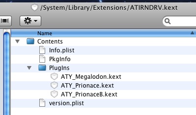

mitch_de Posted January 13, 2009 Share Posted January 13, 2009 The ATY_MEGADOLON.KEXT is normaly installed within the ATIRNDRV.KEXT , like ATY_LAMNA.KEXT is within ATINDRV.KEXT(since OS X 10.5.4 update). You can control that be finder show content on that ATIxxxx.kext - You dont need to install anything using EFISTUDIO_EXTENDED. The written efi gfx string (simple select the ATI38XX MEGADOLON 512 MB) links to megadlon framebuffer. The ATY_Megadolon.kext must only exist (in that ATIRNDRV.KEXT), thats all. How it should look (the content) i attached Link to comment Share on other sites More sharing options...
McBeaven Zissou Posted January 14, 2009 Share Posted January 14, 2009 Ok so i used EFI Studio Extended with the megaladon gfx striing thing( im not really too sure what that is or what im talking about) AND IT WORKED! I can change my resoultion and what not! Thank you so much sir i would like to make love to you for your help but the best i could do for now would be cyber because we only contact over the internet and i dont really know you. Thanks for your help and thanks to everyones hard work on making all this stuff possible the only problem i run into is it says my card is not quartz extreme supported. any idea if the Sapphire HD 3870 actually isnt supported or if this is something i can fix? Link to comment Share on other sites More sharing options...
