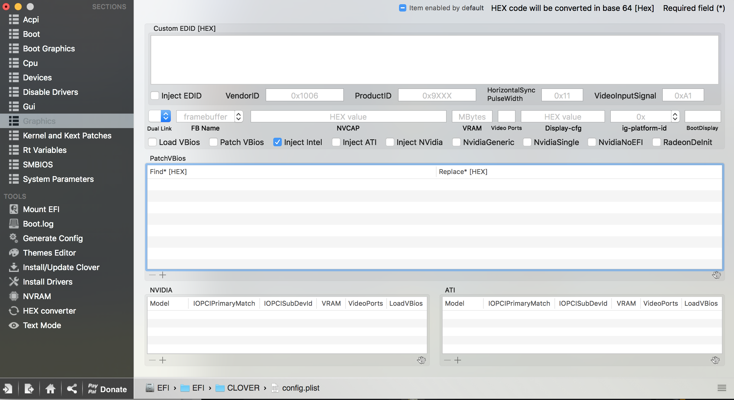

So the solution is to use a connectorless ig-platform-id, or just disable the iGPU in the BIOS.
If you don't know what is a connectorless ig-platform-id, follow the settings of the screenshot:

Unfortunately either connectorless ig-platform-id by config.plist or add IntelGraphicsFixup.kext can not fix 10.13.5 beta2 or beta 3 yet.
Only disable iGPU at BIOS can login desktop from AMD RX 560 at 10.13.5 beta2 or beta3 in my hackintosh.
